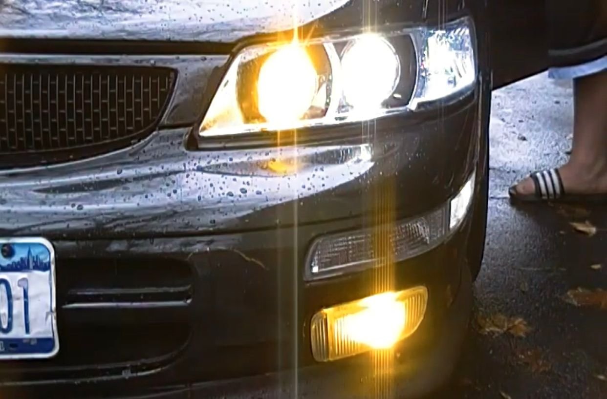

Low beam
High beam
I want it like this. When high beams turn on the lows stay on in this photo. My case, the lows go off as i push the highs on.

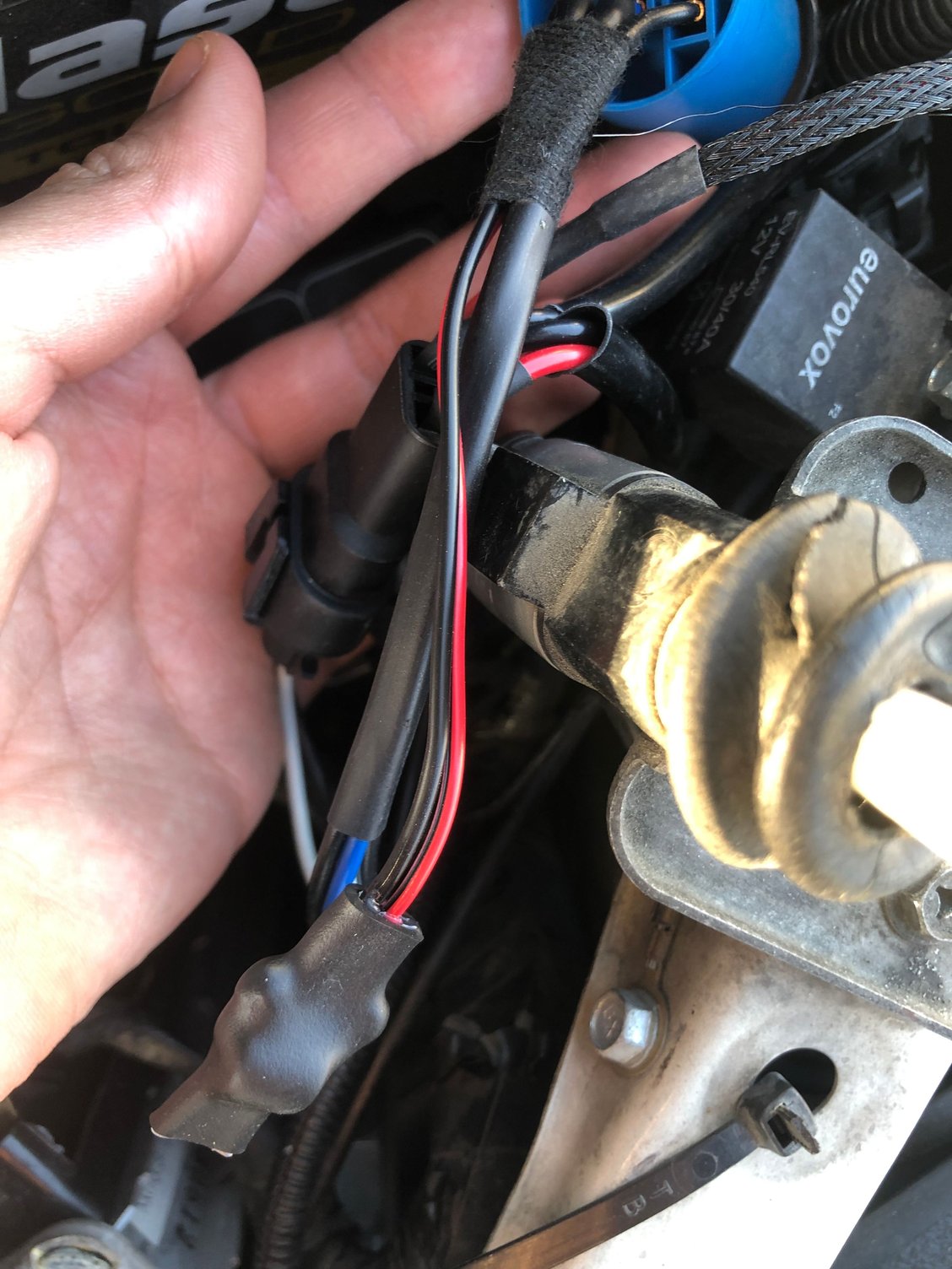

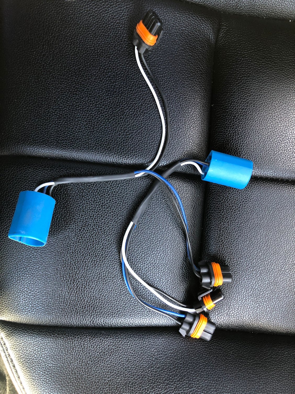

I asked him about a diode and he said he uses 15amp diodes. The Projectors they use are 3.2 amps and the led bulb I have on my high beam is probably 2 amps. He stated its well below the 80 percent duty cycle of the diode 12 amps

Update. The Diode solved the problem and now they all go on when I turn on my higbeams! Retrofits ftw

I think that video legit had a thread linked to it where I explained the whole diode thing lol Super old vid! I had the fog lights rewired also so they wouldn’t shut off with the high beams either.

Yes the fogs actually stay on too with highbeams activated so it looks even cooler lol.

Heres how its done in case anyone needs help.

1N4007. You’ll need two (one for each side)
