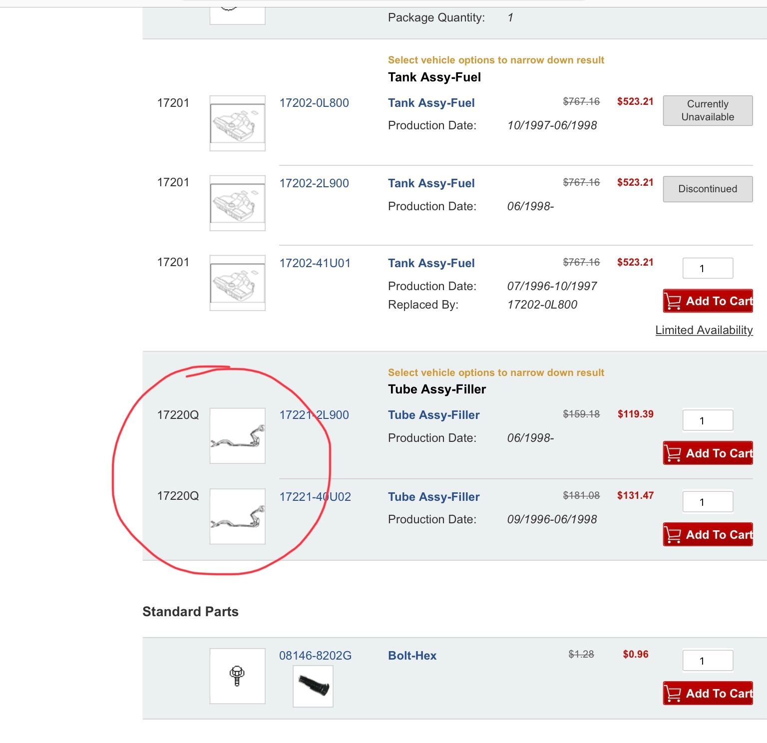

Hi,
Gosh, it's been years since I have been on this website and so glad to see it's still up!
My 1998 Nissan Maxima GXE leaks gas when I try to fill up.....My mechanic tells me that I need a new "Tank Filler". I called my dealer here in Canada and tells me that this part is no longer available in Canada and to try USA.
I don't know the part number or what you guys in the USA call the "Tank filler"..this might be a french word translation (yes, I am in Quebec)..the dealer wasn't that helpful.
Can anyone know what part I need or what this "Tank filler" is called? or where I can buy it?
Thanks so much!
FYI. My Maxima has 370,000kms

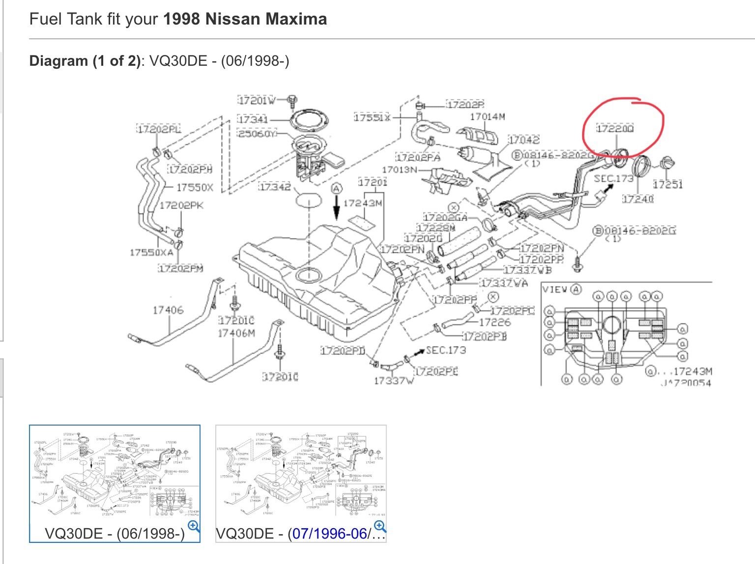

https://www.nissanpartsdeal.com/part...agram=172_B002
Old Nov 25, 2022 | 07:40 AM
Justaguy's Avatar
Joined: Jun 2005
Posts: 294
From: Montreal
Ohh this is soo great!!! THANK YOU SO MUCH !!!!!
