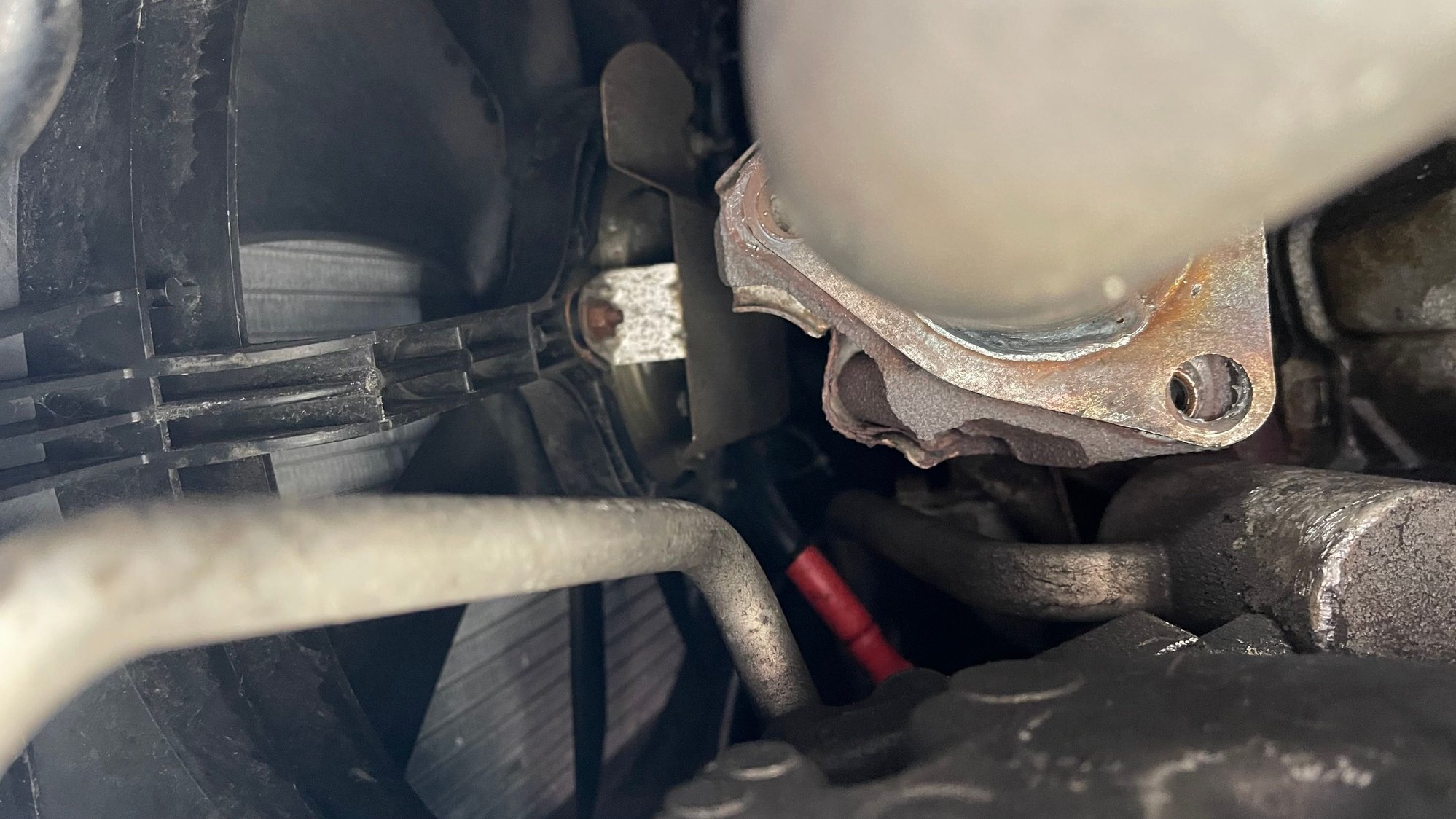

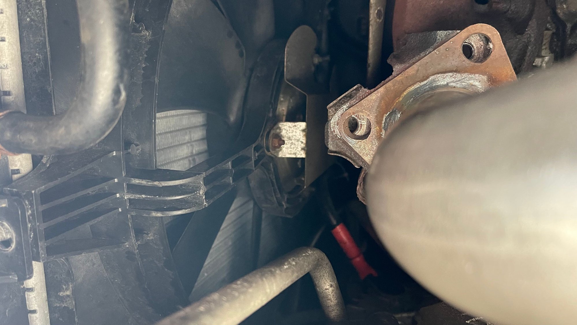

I did not try that. But considering how much the difference is between the new pipe and manifold, not sure that would solve it..
attached some pics of issue.
thanks for the reply.

From looking at your pictures that flange needs a tiny twist.. go the the exhaust shop, its should be a very cheap fix to get you back up and running. I do parts daily and these days the QC has gone by the wayside on pre made parts like this. GoodLuck

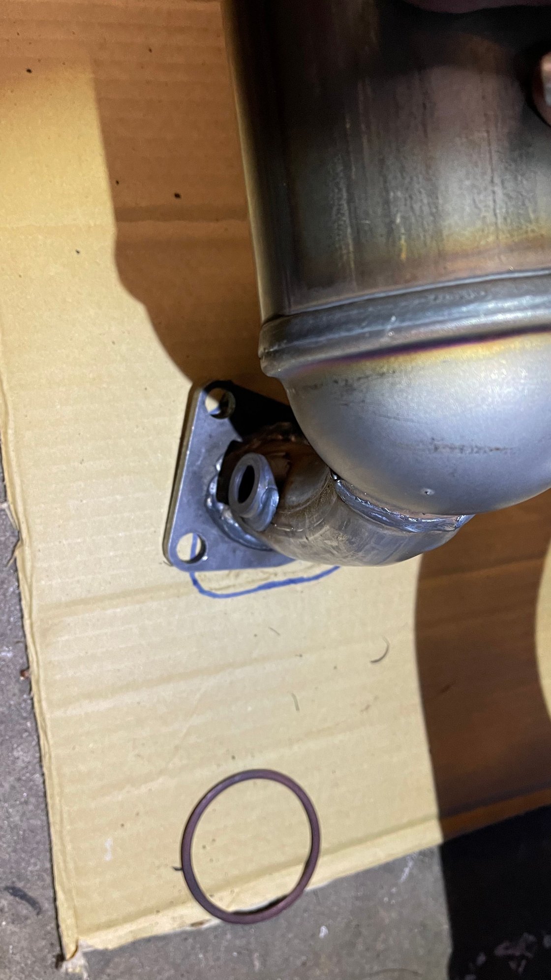

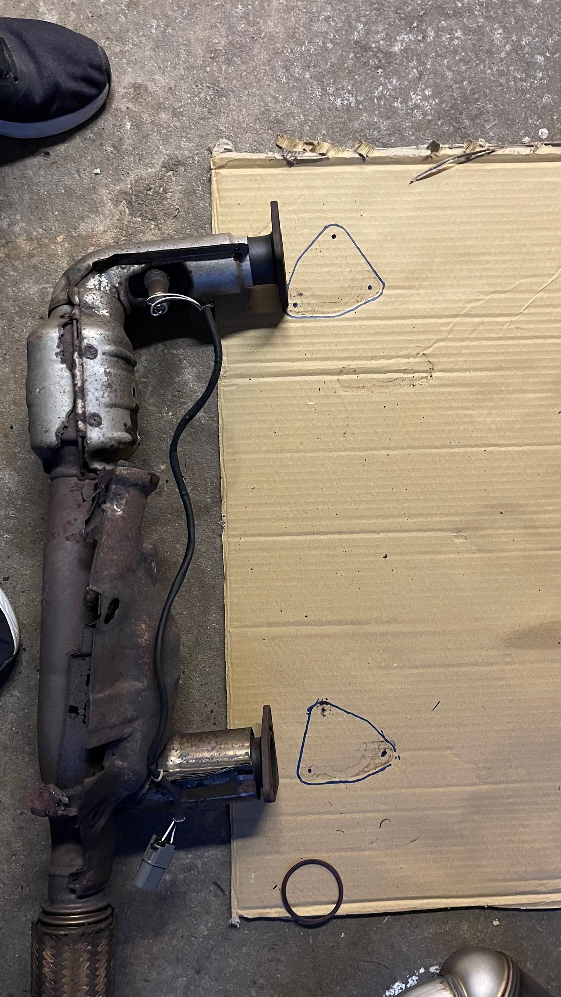

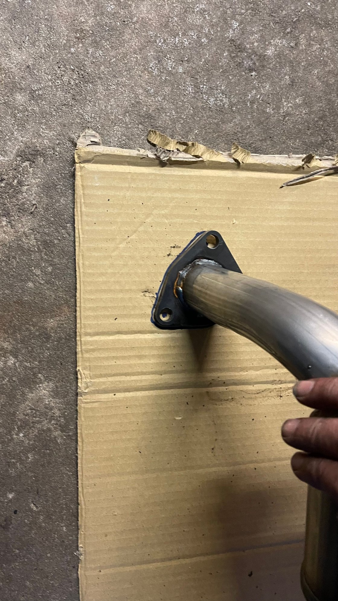

When the old pipe was removed I made a trace of the two flanges on cardboard, then lined up the new pipe to see how much it was off by.

Best way to make sure your radiator support isn't stretching from corrosion is putting a floor jack under the engine cross member by the front of the car.around the front engine mount or more forward, See how much it moves up while jacking before it starts lifting the front higher. If there's a few inches of play before lifting the front of the car, it's worse than it appears. Maybe your old pipe bent a little with the heat and flex stretching it?
