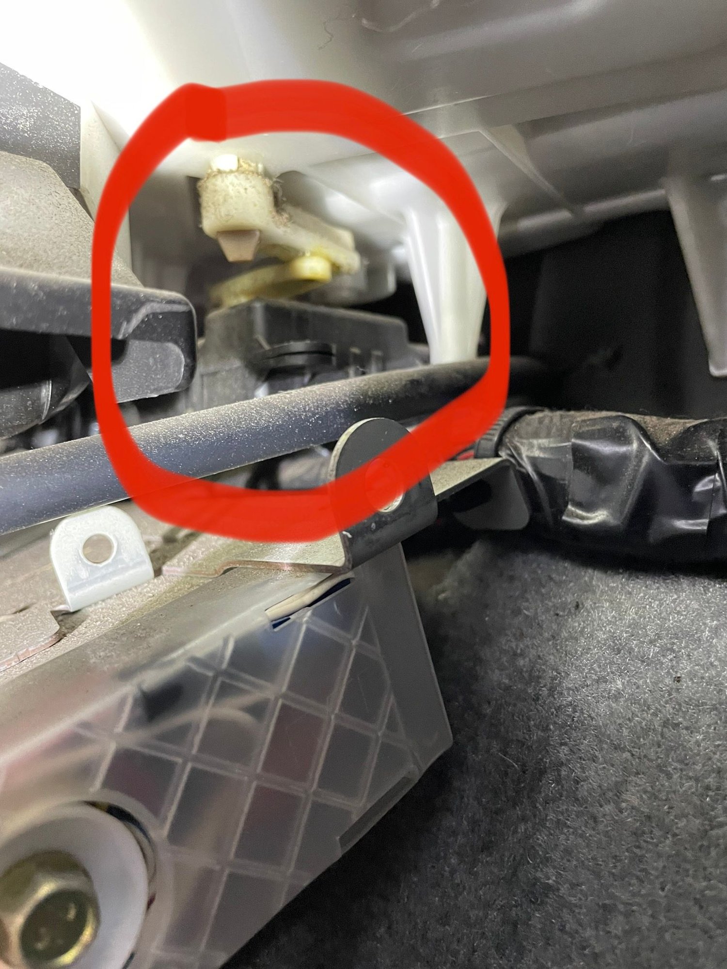

Possible your blend door/ air mix door actuator went. Stick your head under the dash from the passenger side and look toward the center behind the computer. Pop the black plastic cover off first. There is a small black box with a white arm atop that rotates and opens the blend door to let more/ less hot or cold air in. If you change the temp with your left hand while your looking at it and it doesn’t move that’s your problem. I did one recently however mine was stuck on hot no matter what the setting.
