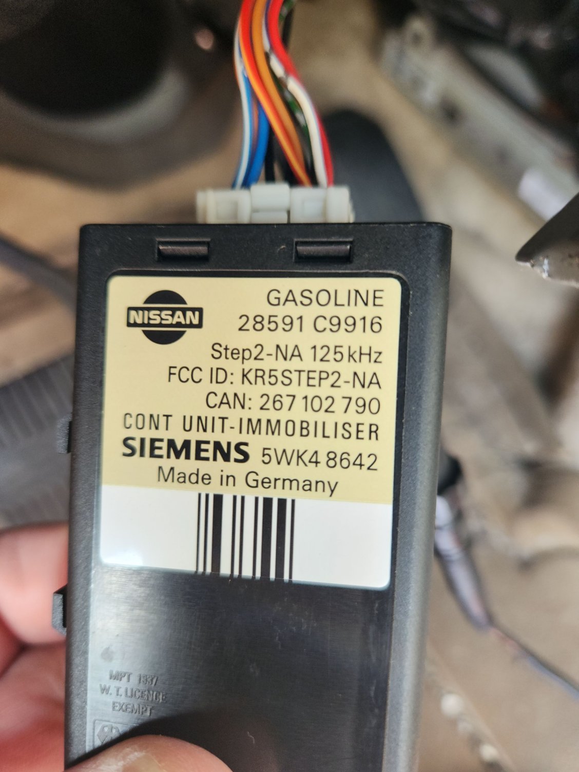

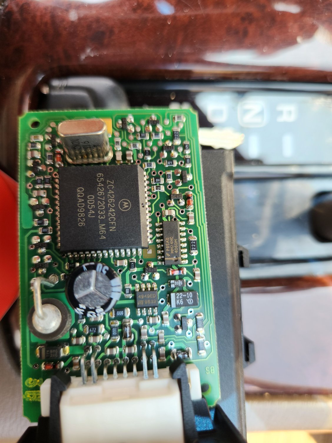

Immobilizer circuit board
Immobilizer under the dash drivers side.
