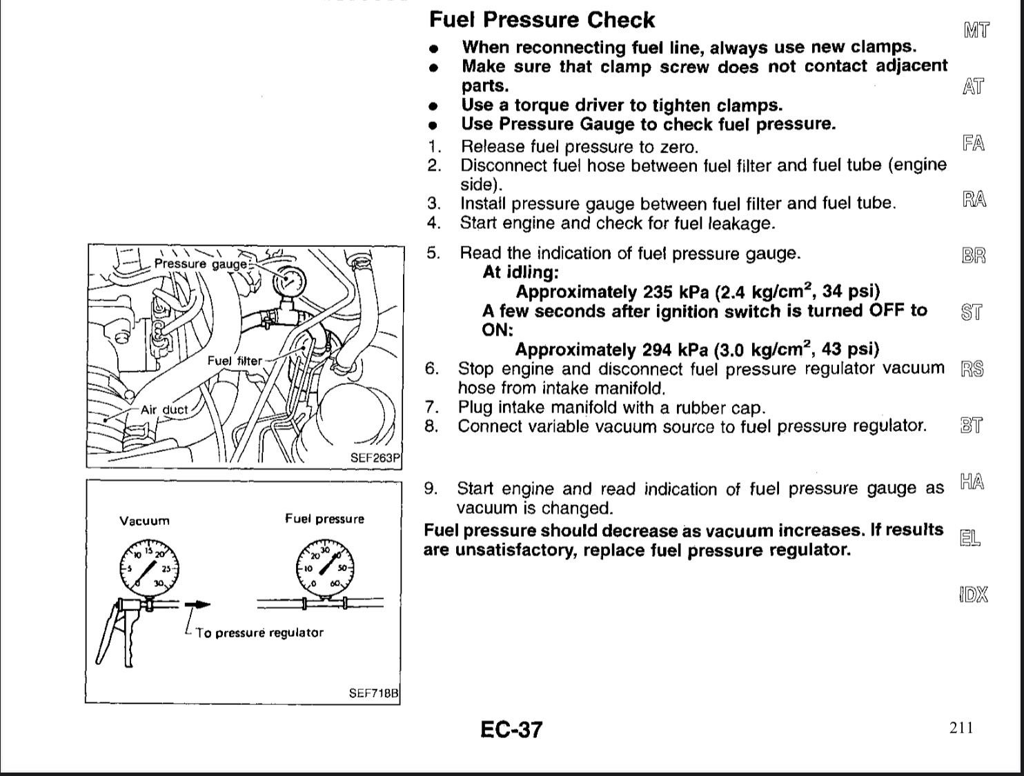

I wan to test fuel pressure, but our cars don't have a test port. Are there any howtos or guides on how to test fuel pressure?

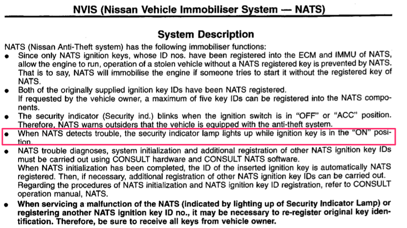

The security light was no longer solid when the key was turned to the "ON" position.
However, the car cranked, but did not start because I forgot that I removed the fuel pump fuse. When we were attempting to start the car, the starter did not sound good, sounded sluggish and I could see smoke coming off it it. It was shot.
I reinserted the fuel pump fuse and read 40 PSI of pressure when testing off of the fuel filter as I turned the key to the "ON" position.

Thanks everyone for their input regarding this problem. To provide and update and closure to this thread.
Chain of events:
1. keys got de-programmed car was immobilized via NATS. Solid security light when cranking.
2. reprogrammed keys via locksmith with a t-300 plus
3. left out fuel pump fuse by accident, so after reprogramming got no solid security light, but car wouldn't start, only crank.
4. tried jumping car in an attempt to start, jumped it with battery pack and a car in parallel thinking the pack was low and burnt out the starter in the process.
5. replaced the starter, car would crank, but not start, did not sound like I had ignition pulse, no security/anti-theft issues obvious.
6. at some point, the car would not crank at all and the dash lights would go dark when trying to start. Also weird buzzing and beeping noise could be heard in the cabin when turning the key to the ON position in this state. Door lock motors would click rapidly when trying to lock/unlock doors with key fob. The security light would be on sometimes when key is in the ON position but, but not during starting.
7. unlocking doors with the keys and letting the car sit overnight would sometimes allow the car to crank, but it would not start and it would eventually go back to the state described in #6.
8. found out about and executed the "Escape From Lock Mode" procedure and the car ultimately started and ran. And restarted and ran consistently.
These are the steps for the Escape From Lock Mode procedure:
1. Turn ignition switch OFF.
2. Turn ignition switch ON with registered key. (Do not start engine.) Wait 5 seconds.
3. Return the key to OFF position.
4. Repeat steps 2 and 3 twice (total of three cycles).
5. Start the engine.
