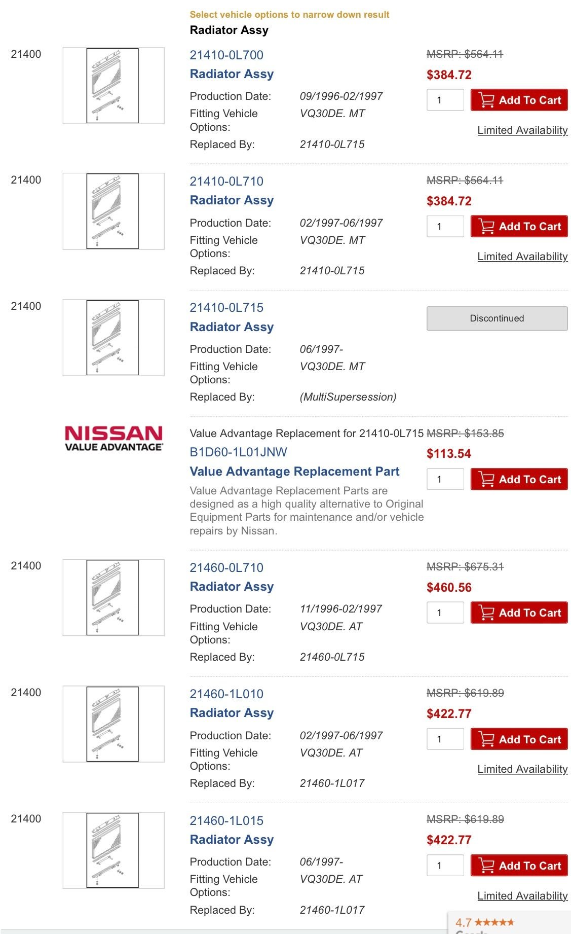

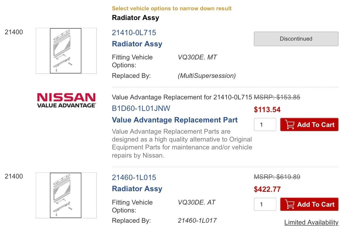

Old Feb 21, 2024 | 04:09 AM
Turbobink's Avatar
Posts: 2,758
From: Tampa Bay
For 1999:
For 1998:
Take note of the duplicate P/Ns.
Madman y2k
Apr 19, 2018 07:20 AM
Jewing1978
Jun 19, 2015 09:38 AM
Kretzmech
Jan 27, 2012 03:16 PM
TommyG
May 28, 2004 04:14 PM
