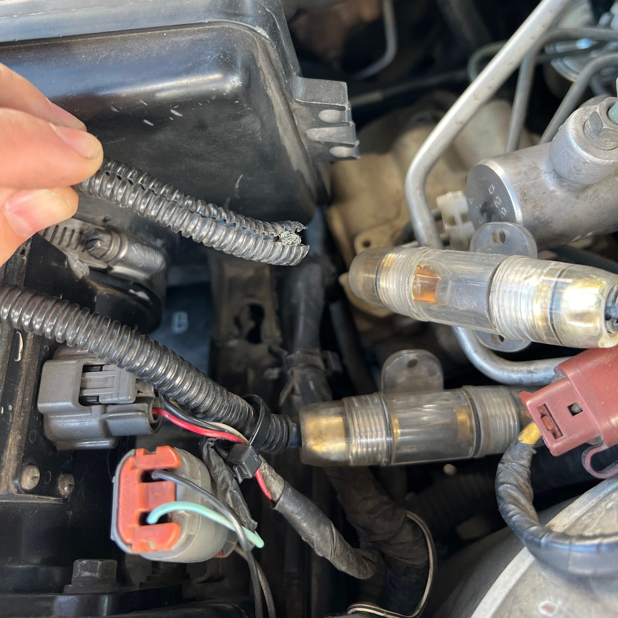

also i see two cables running off the positive end of the battery into these little glass fuse holders. One of them is still connecting with a glass fuse inside, the other has been snipped. Any reason for that?

Absolutely no reason for those extra fuses, except that previous owner(s) have added something "aftermarket" or potentially tried to fix something in a very unusual way. Wouldn't be a bad idea to trace down where the one remaining connected fuse is going, not that has anything to do with the starting issue.

so just figured out that those two cables with the fuse in them go to the audio system in the car (some guy put in an aftermarket system).
