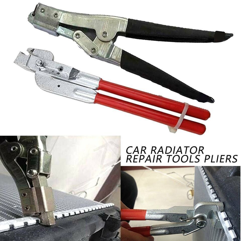

I was just watching a youtube video of someone taking a radiator apart. I've never done that. It appears you have to bend all those little metal tabs up to release the pastic top. Then I imagine you could replace the seal beneath? But then how on earth can you get the top to ever seal again? I can't imagine how you would be able to crimp all those little tabs down enough to compress the seal and make it leak-tight.

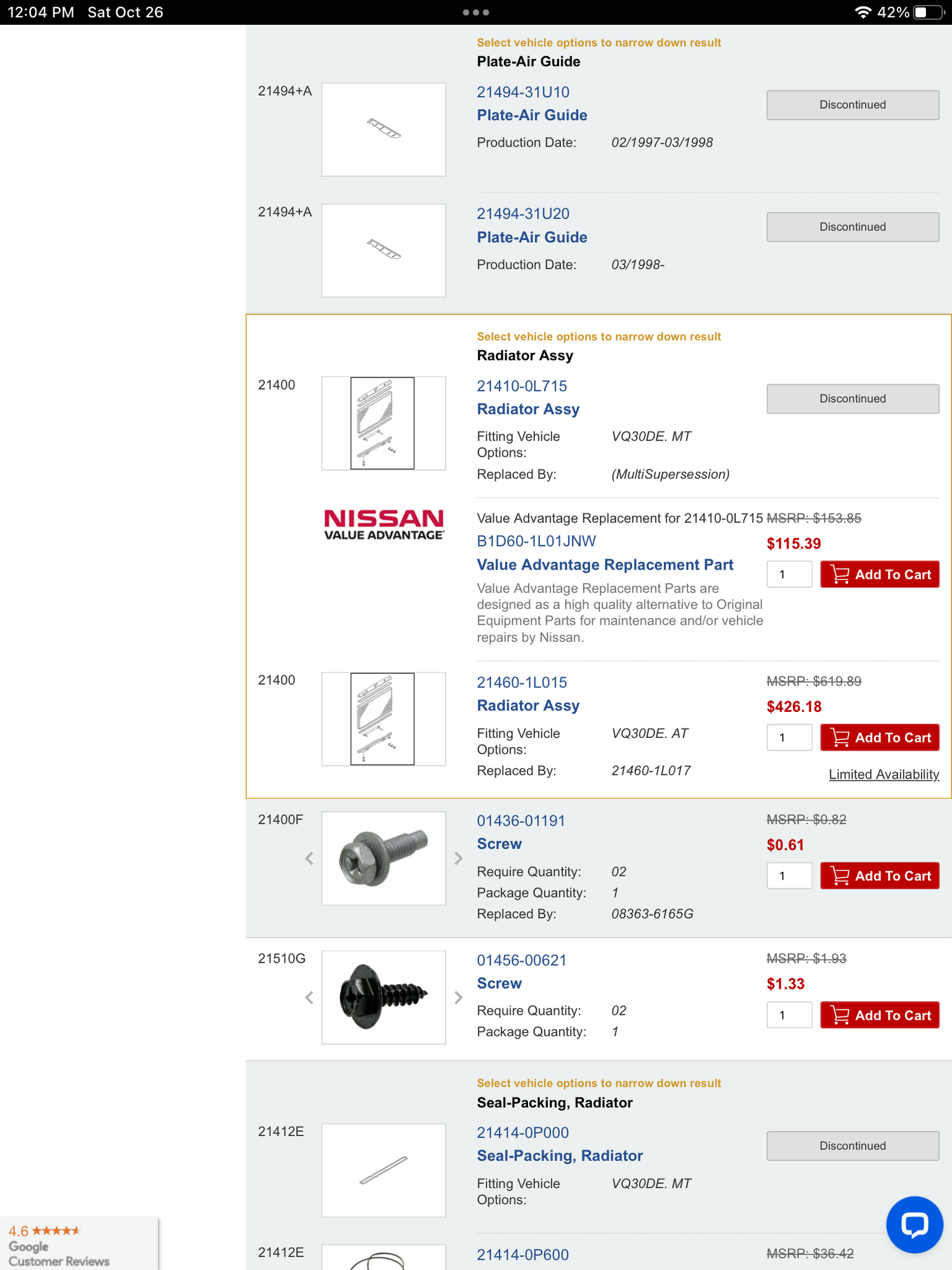

Also, FWIW … the Value Advantage units do still appear to be available at Nissan Parts Deal (NPD).
https://www.nissanpartsdeal.com/part...r_cooling.html

@Turbobink Thanks! my local dealer said the Value Advantage was discontinued so apparently this place has a stockpile of them. This could be the way to go. I know Value Advantage is the economy part for Nissan, but probably better than other choices I'm currently finding. Appreciate it!
https://youtu.be/z5pCNCc8jak?si=YatfK2BJRNBsa1aP
That's the basics, yes. You seem concerned with country of origin and getting parts as close to OEM as possible so I figured I'd mention it. Rebuilding is a last ditch effort or reserved for super enthusiasts you could say. I saw it done on a TV show called Wheeler Dealers years ago; they try to pinch pennies. There are specific tools though it's a pretty simple job. Maybe there is a shop in your area that could do it and they could give you advice.

rebuilding a stock radiator? that sounds like a lesson in disappointment. how do you plan on evenly crimping the ends? spend the 100 bucks on a basic replacement and be done with it for another 15-20 years. my 00 made it 16 years. my 02 made it 20.
It's not rocket science.
