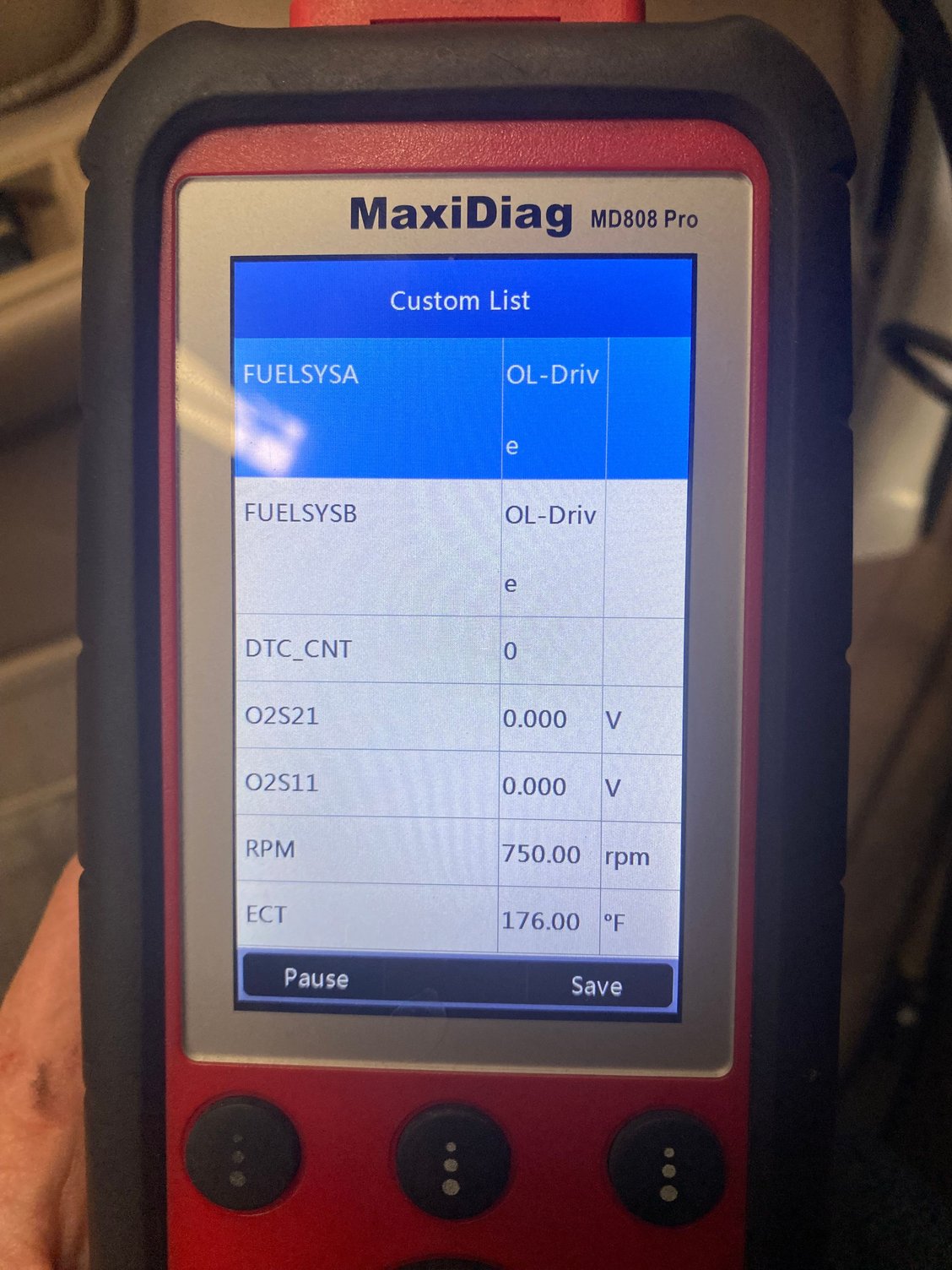

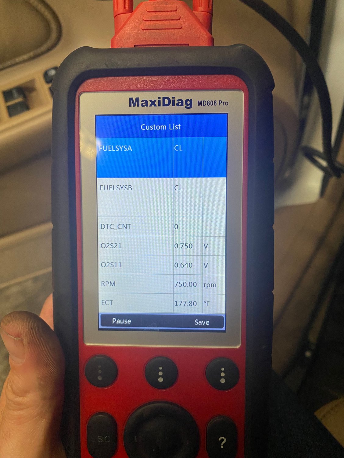

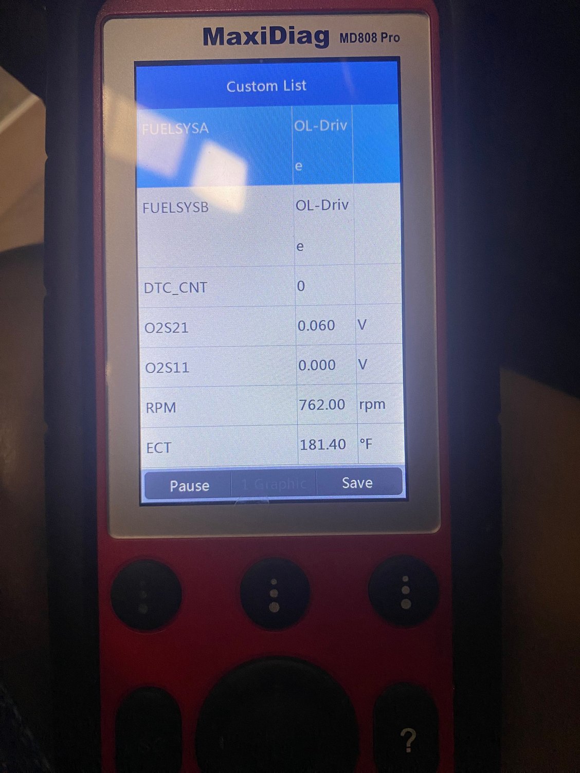

Here are some images of live scan..
If i let the car idle
Open loop status
Open loop status
If I tap the throttle goes into closed loop
Closed loop working
Closed loop working
Let the car idle for 30 seconds or so and goes back to open loop
Back to open loop
Back to open loop

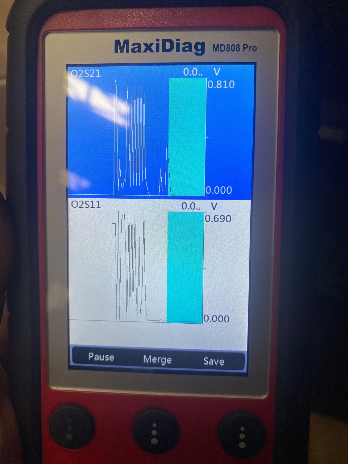

Heres a graph of o2 sensors while being at closed loop and going to open loop..
o2 sensors cycling and when it goes to open loop dead

Well after long diagnosis and data logging seems like a few users got it! , Apparently the MAF sensor goes crazy sporadically and reads high so its flooding the engine while on idle. This is not all the time, is all of sudden, then it goes back to normal.
Im gonna try out luck buying a new one, and check back if it persists or goes away
