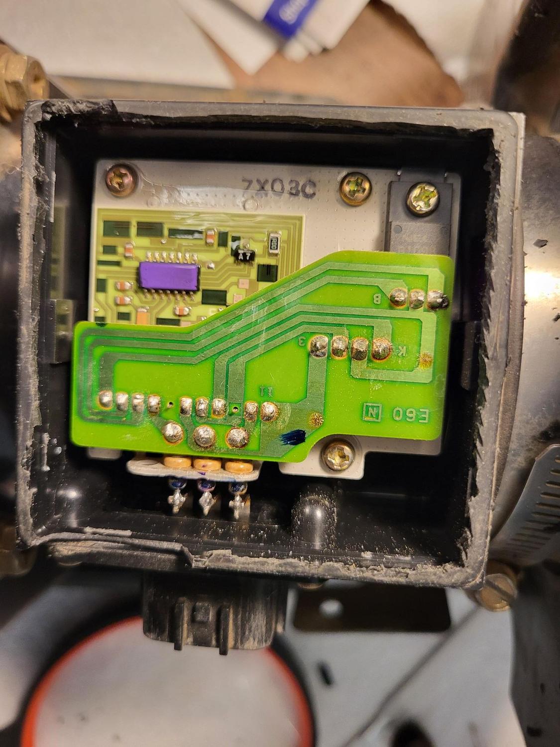

1. Error code P0100
- the MAF voltage was increasing normally with the RPM up to (1-2.5)k during a test, but with error code P0100
- top cover plate (plastic and metal) of MAF was removed
- resoldering all contacts with adding a new solder (little bit) , Isopropyl droplets was used
- cleaning with brash
- all wires connectors (3) were disconnected/reconnected several times.
Finally- problem was fixed.

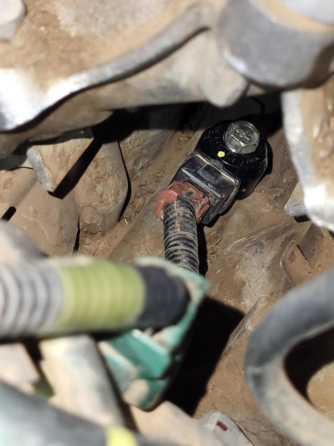

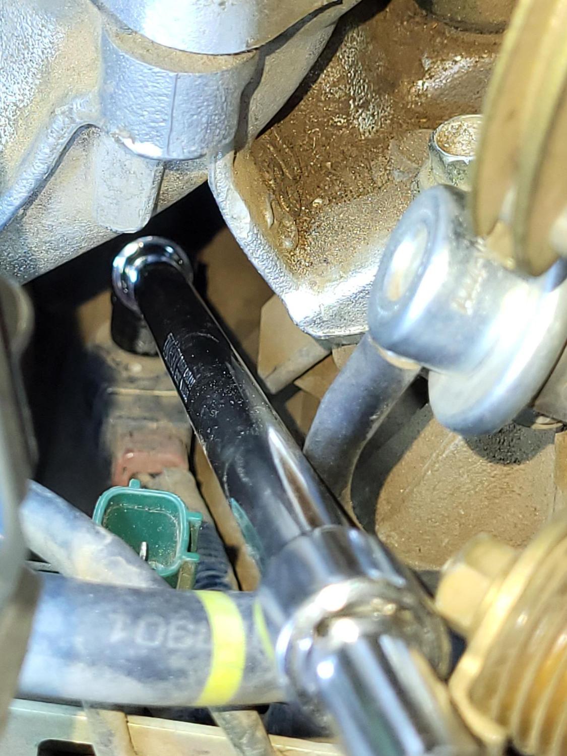

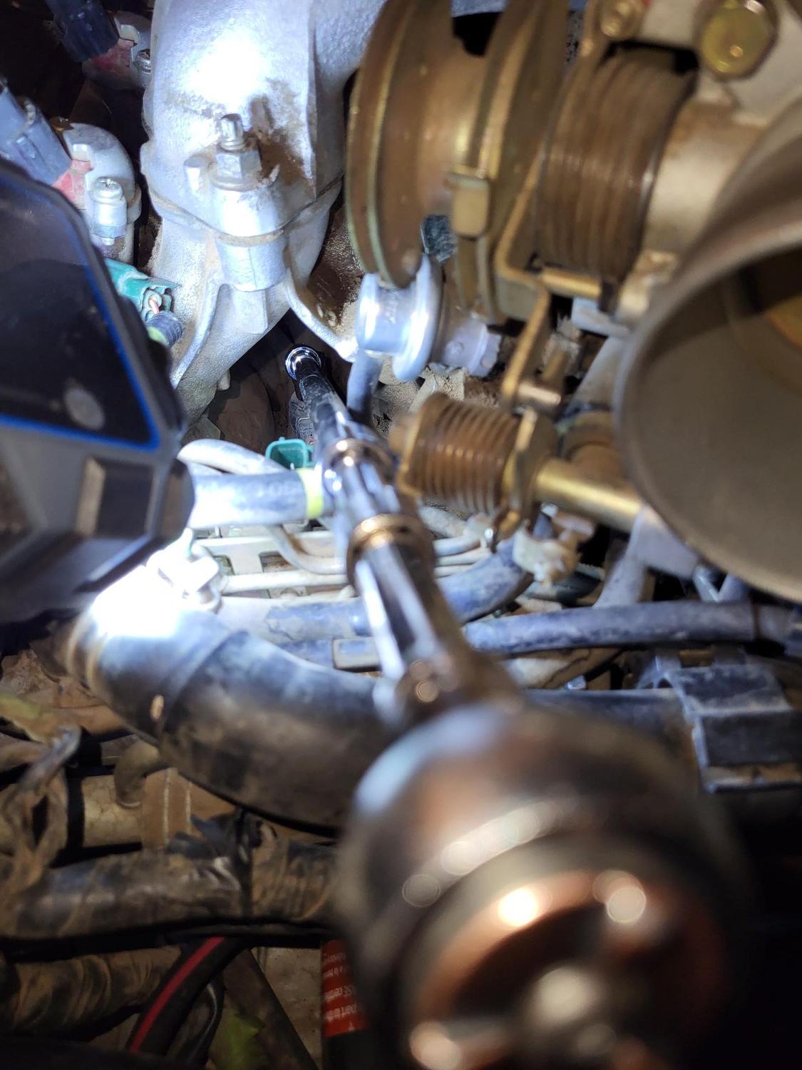

2. Error code P0325 (Knock Sensor)
- it was found that the sensor contact is not stable ( check resistance of KS; between engine ground and one pin of connector; second pin is not connected to KS)

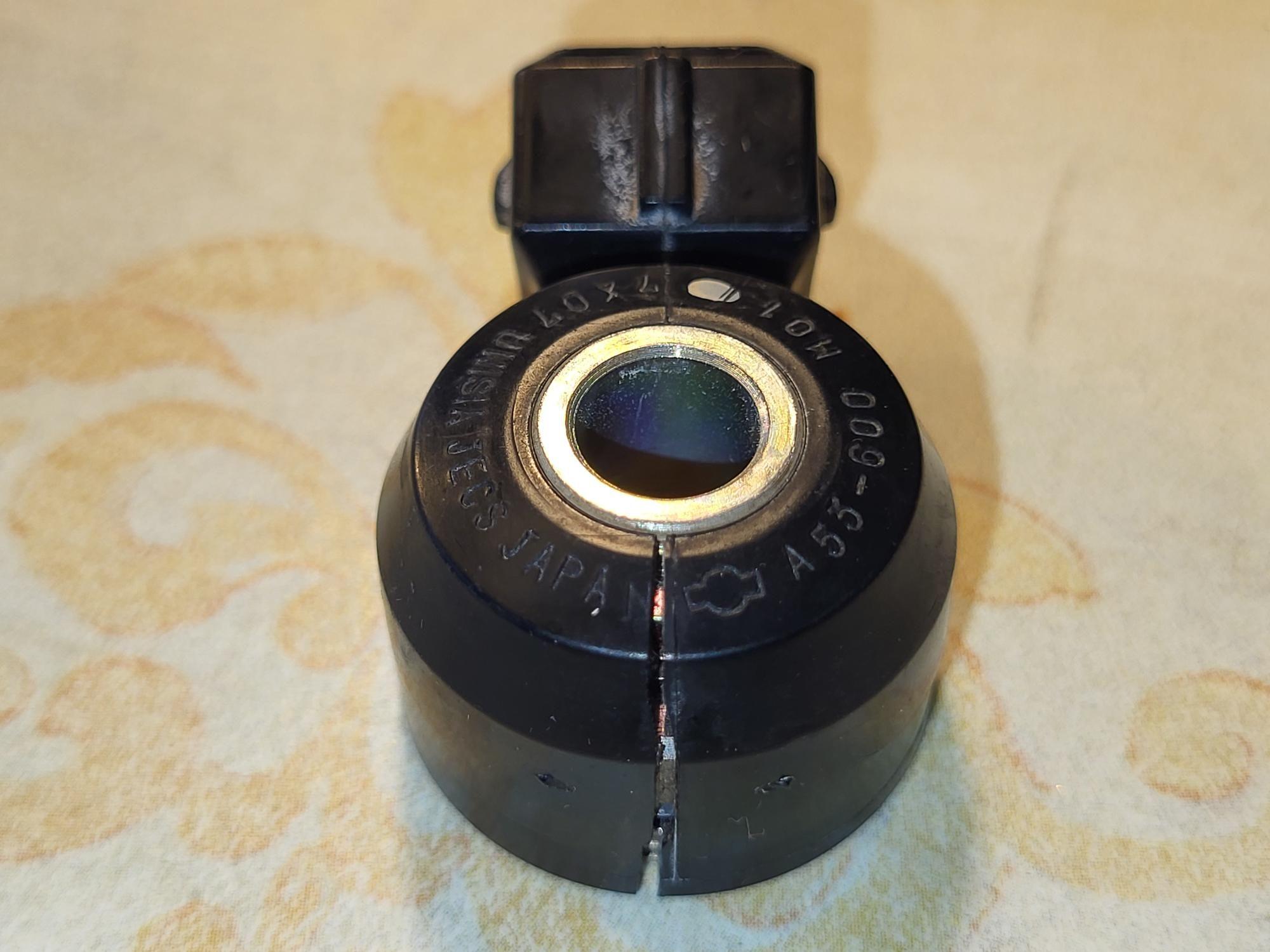

- KS was removed and a new KS is installed (550 kOhm).
Original KS: A53-600 M01 Unisia Jecs (later Hitachi)
New KS: Hitachi KNS0001 ( the same as original - A53-600 M01 - see pictures)
Problem was fixed. No error codes.

MAF (open cover)
MAF (open cover)
New knock sensor (A53-600 M01)
New knock sensor KNS001 (A53-600 M01)
KNS001
KNS0001

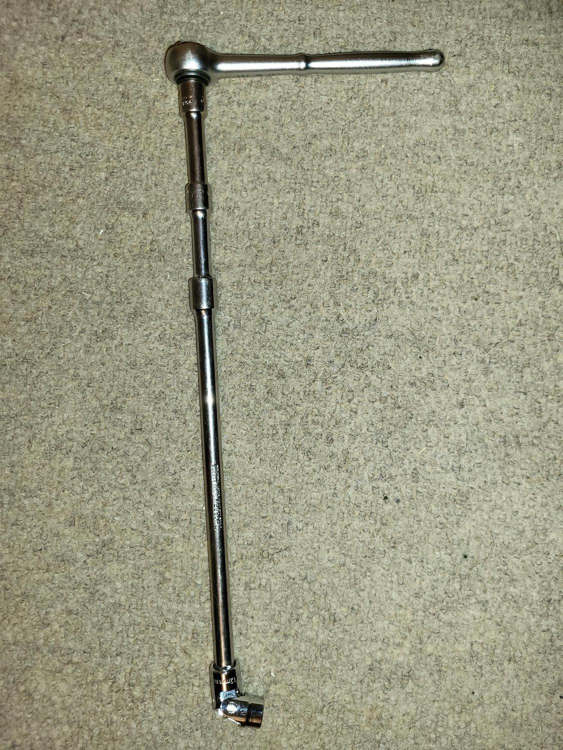

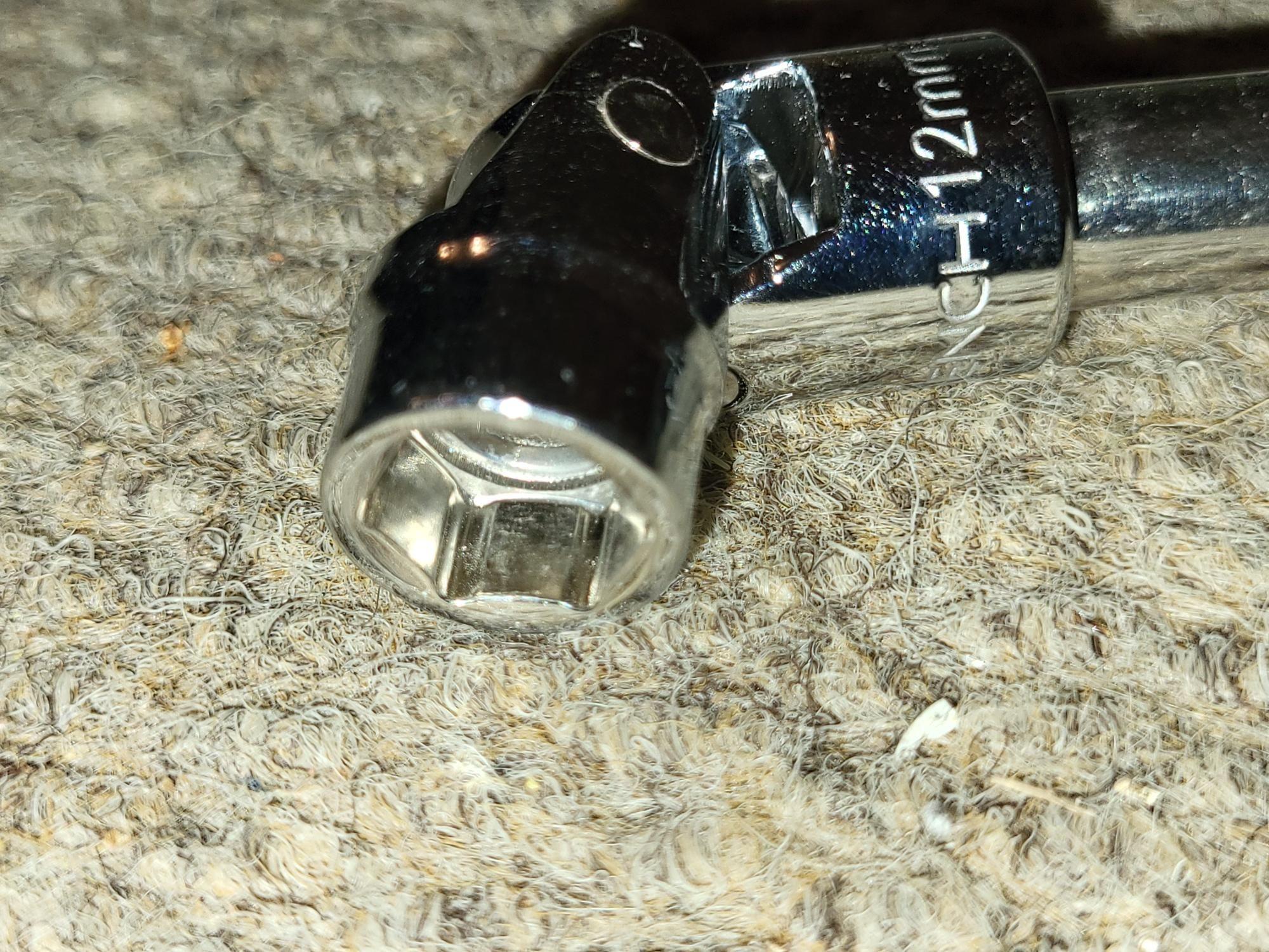

Used tool
Used tool
Removing of MAF
Removing of MAF
Removing of MAF
Removing of MAF
