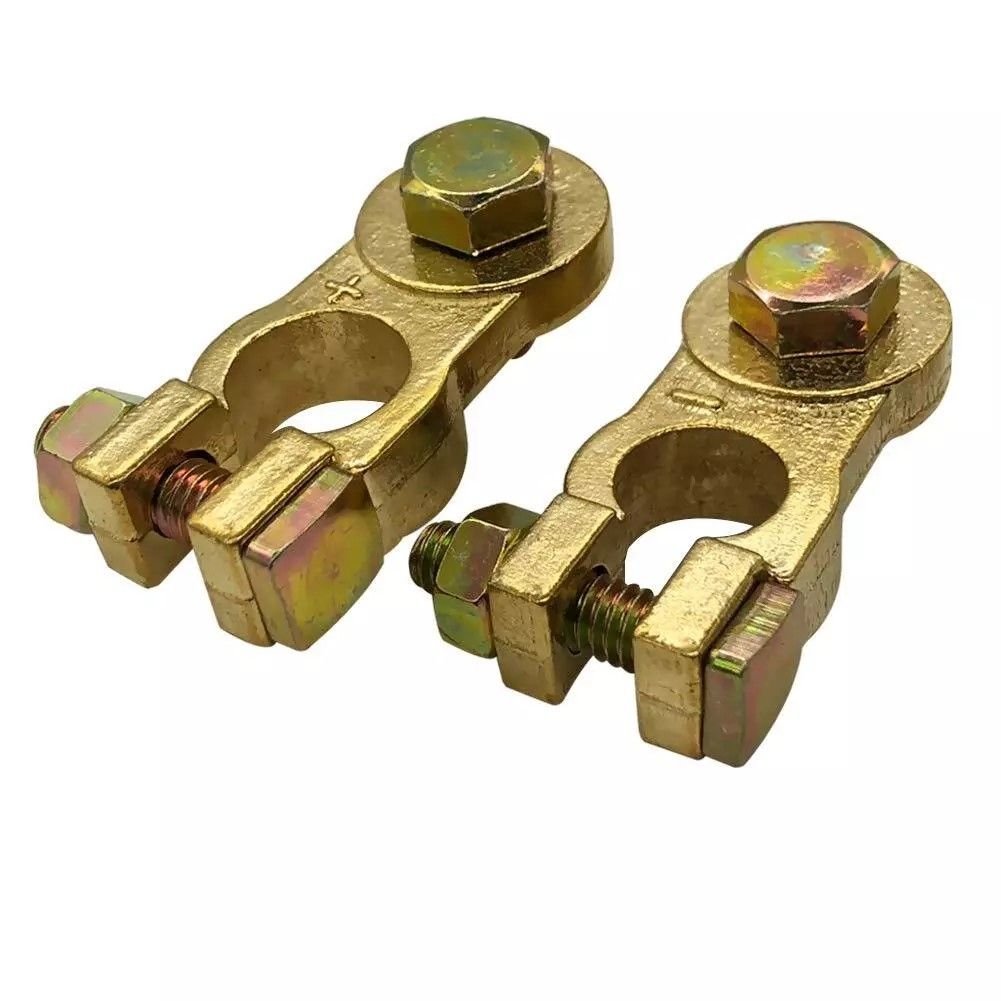

it's also good to have good terminal clamps and cables. my factory terminals are long gone and my ground cables are new. i picked up a set of brass terminals but used allen bolts instead of the box head bolts they came with. you can get different lengths of power and ground cables at the auto parts.
