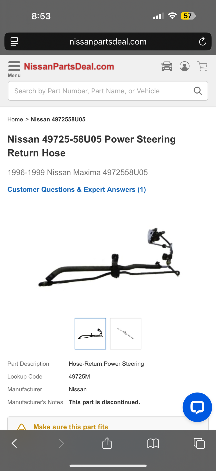

Has anyone ever replaced this part # 4972558U05
I have this hose leaking but cant really find the original. Im wondering if there is an alternative to use. The leak is really small but annoying.
Any help would be appreciated as well as some help getting back there to change it.

if its just the rubber hose leaking you can use universal bulk hose. there are no extreme bends that would kink and cause a problem. if its the steel rusted out youll have to find a used pipe assy
luckily the metal part isnt rusted put, its just leaking from the hose. So this is just a regular rubber hose that should come out then?
