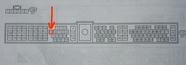

the coil wire goes to the rpm wire on the ECU

the way i have my NOS switch wired.. i have the coil wire going inside the car to the rpm wire from the ECU.. i forgot which color wire it is on the ECU.. argg... but when you go on the passenger side of the ECU you can pull the middle screw off remove the plastic area and you will see all the ECU wires.. i know the wire is in the manual for the rev speed meter.. i will check around for the color for you..

from the man himself
Originally posted by sx7r
i didn't tap into the coil, i tapped the tach wire off the ECU.
RED - 12V constant
GREEN - nitrous relay ground, after your full throttle switch
WHITE - Tach wire off the ECU harness. This tach wire is a white wire with a green stripe. below is a picture of the ECU harness so you can see where the wire is. it's going to be wire #5.
BLACK - Chassis Ground
below is a picture of where the tach lead is located on the ECU harness:
