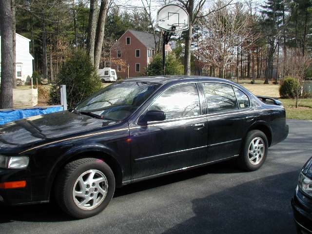

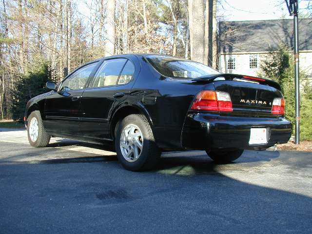

Last week I finally got around to peeling the gold pinstripes off my black 96 SE (I bought it used and it apparently had the gold option). A few days later I got around to washing and waxing the car. While I was at it, I took off the Volvo dealer logo that was on the trunk, and took off the nissan logo too, so it's just the maxima now.
For those that are interested, after the wash and wax, it was nearly impossible to tell there had been pinstripes on the car, or a nissan emblem on the trunk. If you look really close at the car, you can see a slight difference in the paint, but I knew what I was looking for. My dad was surprised cause he figured it'd be easy to tell since they hadn't been exposed to 5-6 years of wear.
Before: http://www.z3d.com/maxima/pinstripes.jpg
After: http://www.z3d.com/maxima/clean.jpg

the car looks nice...i'm in a similar case, where my parents had the gold package put on our 97 black GLE...and i too was looking at the possibility of removing the gold plating on the emblems

good job the car looks niiice

The car looks real clean...time for the clear corners!

Thanks. Pinstripes came off pretty easily. I used a hairdryer and had a little piece of plastic to get it started. Once you can grab the pinstripe with you fingers, you can just peel it off in strips. Mine left some glue behind on the car, which wasn't on really well (I could scrape it off with my fingernail). We had a can of Ford tar/sap remover stuff lying around, and that took the glue without a problem. I waxed the car afterwards and that helped everything blend together.
