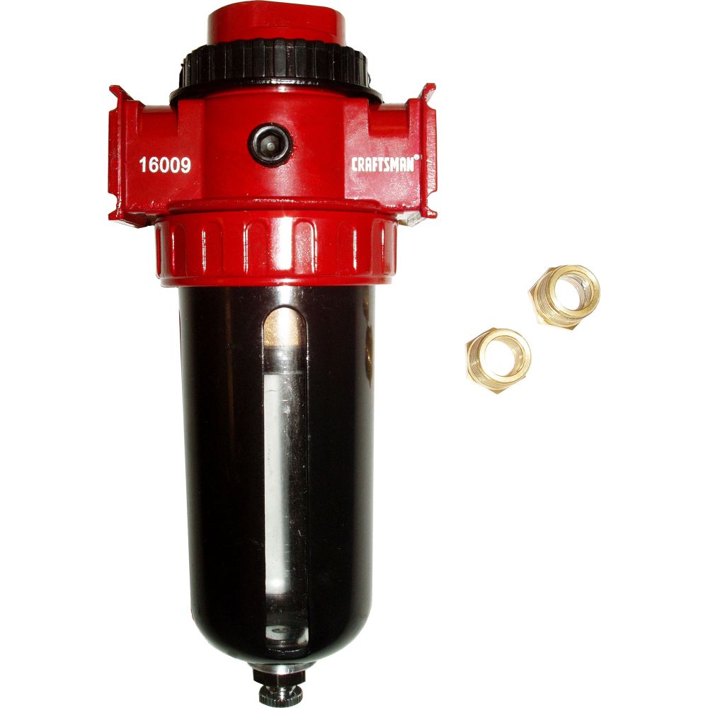

I used a craftsman compressor water separator. It has a larger reservoir to hold more oil and its built to last. I found it at sears for $20.
http://s.shld.net/is/image/Sears/009...sm=0.9,0.5,0,0
I hear about these filling up fast, how often are you suppose to service these or empty them or w.e?
