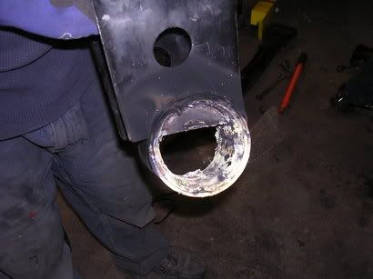

Well, the problem with the motor mounts is that the mount has such a thin "lip" its hard to secure it tightly enough to press the stock inserts out. If you find a good enough press, it might take care of things for you.
This is what we did:
Put it in a hot coal oven and melted the liquid filled stock insert FTW...
There is then a metal sleeve left to remove and we used a Sawzawl to cut through that (but be careful not to cut into the actual motor mount) and hammer and chisel to knock the sleeve out.
After you get the stock inserts out, ts pretty easy to get the ES mounts in with a press or you can do what Tilley did and just use a spring compressor for that.
