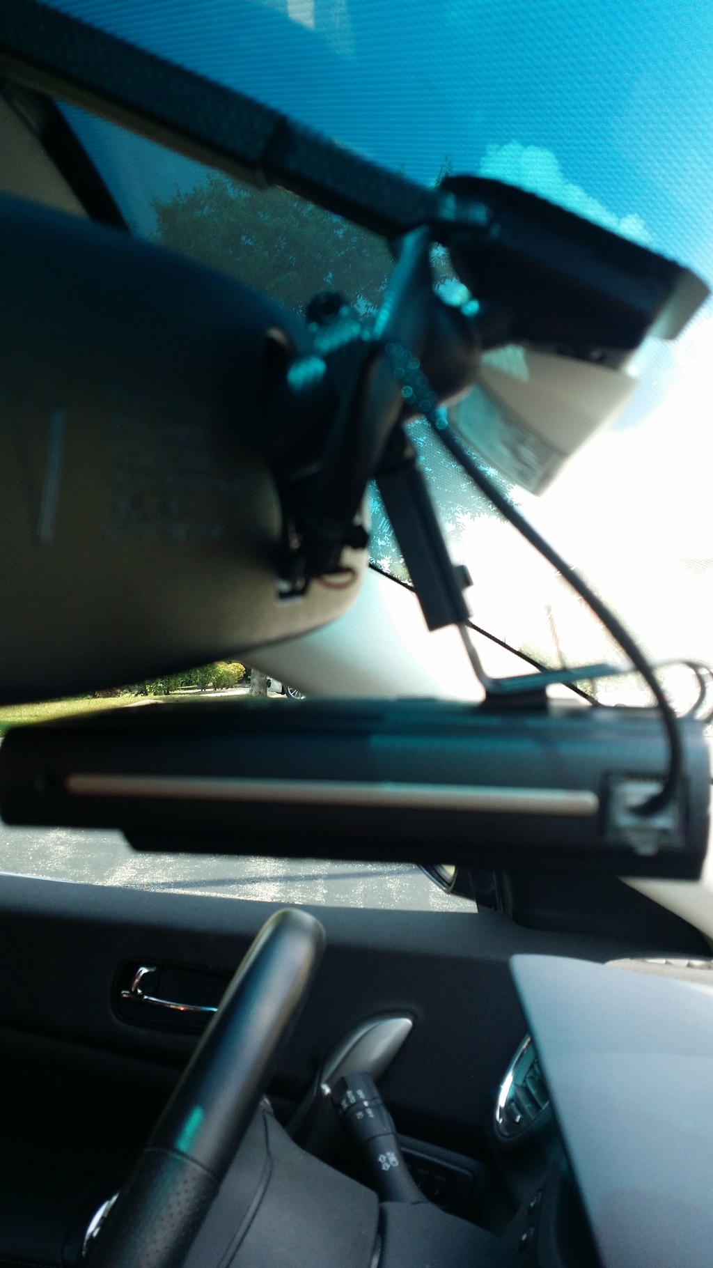

I always hated the suction cup mounts for my Beltronics radar detector--- have had it fall off the windshield and it's just a tip off for thieves that you have a radar detector even if you take it with you when you leave the car.
I was looking for something that would give me a "stealthier" look and a way I could lose the coiled power cord that had to be plugged into the cigarette lighter.
Ended up picking a Blendmount rear view mirror mount and a Mirrortap power cord which let me tap into the power running to the mirror. Took 15 minutes to install. Nice and clean install and it powers the radar detector on & off as you start and turn off your engine.
I can't believe I suffered through with the suction cups and dangling power cord for so long... LOL

Nice looking install, can you show us a picture of the backside of the mirror?
Also works with my Escort radar detector Since it uses same mount and power clip as the Beltronics. Did not have a multimeter to test which wires to tap into for power so I did it using trial & error to locate the wires that would turn the detector on/off with the ignition.

Thanks for the follow on.

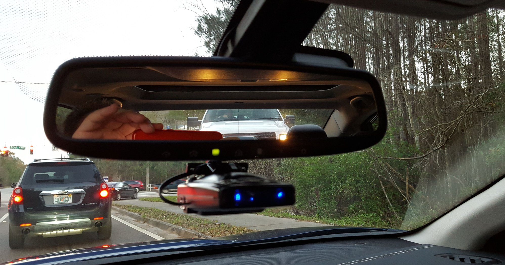

PerformancePackage mount in my 8th Gen
Originally Posted by ricky7780
the blend mount brand looks like a cleaner looking install but the price is really high!
would anyone happen to have a picture of the mount from performancepackage.com? it is so much cheaper but just looks a lot bulkier.
Mu 9500ix mounted in the 8th gen, using PerformancePackage mount. Excellent!
