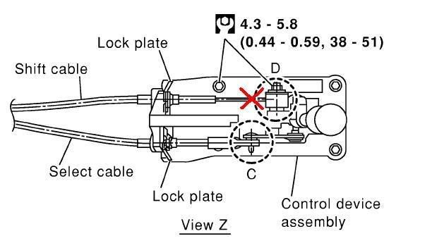

Driving to my girlfriends house today, I noticed my shifter being looser. Didn't make much of it, maybe a bushing torn or something. All of a sudden, can't shift anything, stuck in Neutral, had to come to a stop on the side of the road. Basically, the cable from the shifter lever itself snapped in half, about an inch away from the lever itself. To get home, I had two gears, 3rd and 4th, and I literally had to push and pull onto the cable itself.
Has this ever happened to anyone else? Any insight on what I have to go through to fix this? I have powertrain coverage, not sure if they will cover it, especially because I have the ES bushings + synthetic tranny fluid. Help please.

Update: Went to the dealership today, said they won't cover it under warranty. Part cost: $270.00 + about 300 in labor. They said they could try to weld it together, but they couldnt guarantee it for $150.
Verdict: No to dealership. Trying JBWeld tomorrow, if no luck, time to get a new part.

you're going to jbweld an integral part of your shifter???
good luck with all that
Old Oct 24, 2006 | 03:34 PM
Derrick2k2SE's Avatar
Posts: 2,501
From: Pensacola, FL
I wouldn't count on JB weld holding up at all. I wouldn't even bother with it. It's good stuff but not for that sort of application. Find someone else to weld it cheaper. A good weld should hold fine there. Find a welding/fabrication shop. One of those guys would probably do it for a couple bucks on the side.
Just make sure you use someone who welds all the time and is good at it. The guys at the dealership don't weld much if they do it at all.
