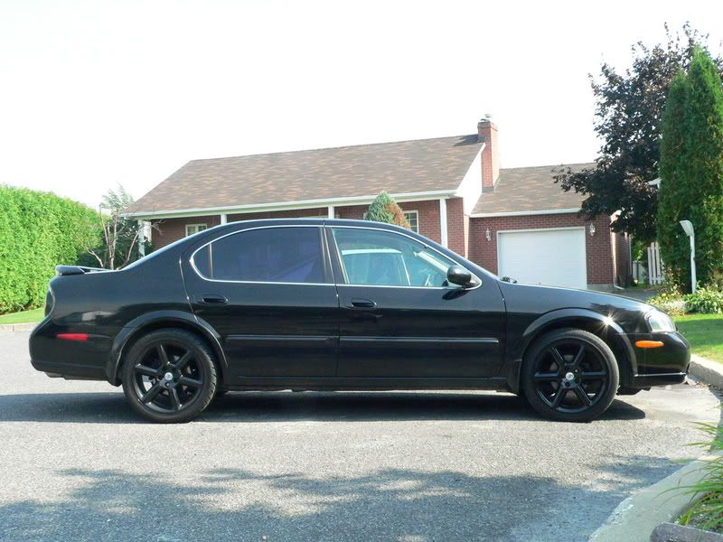

TheSpaZinNOVA i have the same mag than you and i want to drop the front only ....thats why i ask the question
my car
