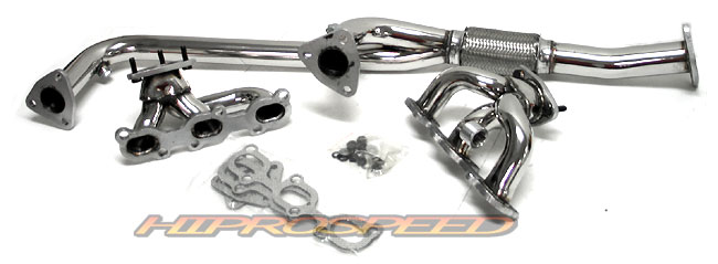

I hope this isnt a repost cuz i did a search on google and found nothing.
http://cgi.ebay.com/JDM-Nissan-02-03...QQcmdZViewItem
A whole setup for 199 + 35 shipping. they even taking best offers....
im not marketing for them, and im not trying to get flamed.
i just want to know - Why is this setup so much cheaper? Is this basically cheap material?

I hope this is not you get what you pay for. That price seems unreal. Its less than a muffler.

1. Those are not equal-length headers....FTL
2. Anything marketed with "JDM" in the title should be avoided on principle, since these were probably made in some sweatshop in China.
3. Typically, if something seems too good to be true....it IS not true.

As Irish said... No equal length... No go.
Also, stainless MUST fit perfect... Or they run a huge chance of cracking.
This is why Brian Catts goes to such lenghts to make sure his headers fit perfect.
You can count on very low quality made in china stainless, not much power gain, better off just adding a y-pipe and possible fitment issues that could lead to cracking.

Looking at the pics and description... If you know what you are talking about, you already know they are a POS.

i hate to think of what the welds are like...anyone willing to bet the welds let go in less then a week?

Don't waste your money/time. The short runners to the collectors would limit horsepower to not much, if any, more than stock, and who even knows about fitment. I would hold out for a trusted brand.

I think his point was that you can see that the design of those shorty headers aren't much of an improvement over stock, so you're not going to gain much additional power by putting these in. Mr Eous did some dyno testing on a 4th Gen to confirm this a while back.
And while SSAC may make decent parts for other cars, that doesn't always translate to Maximas.
To everyone else, if you're going to go cheap, take a look at the OBX headers, those have long tubes, even though the y-pipe isn't equal length. Although, I think someone had a bad experience with them recently, either in the 4th Gen or All Motor forum.
