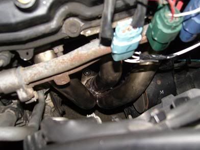

That's what I'd do for now. I'm assuming you've re-checked all your wiring and connections? How and where did you connect the sim to the harness?

I tapped the main hardness. postive and the signal(white wire) and i grounded the neg to the engine. When i get a time i'll take some pics.

Yeah, pics would be good, thanks.
Did you install before or after the plastic connectors? If you did it before, on the ECU harness itself, you can check my thread too:
http://forums.maxima.org/showthread.php?t=350787

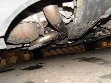

well here are the pics.
