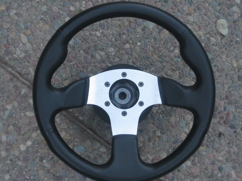

I still have the MOMO hub plus steering wheel if anybody is interested

to fit on a 5th gen with the airbag resistor eliminator thingy ma bob.

what kind of wheel is that and how much do you want for it?
