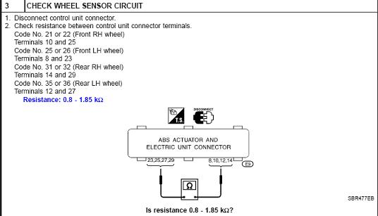

I was just about to send out a reply to your PM, but figured I'd see if you started a thread first, here goes. 1st, you can ignore connector E9 & the entire ABS section of the FSM, I did the same thing, but it's the TCS section you want! Assuming your car has TCS, which IIRC it's a loaded GLE W/tcs.......
Originally Posted by Whtmax'01
I found 2 connectors coming form the abs actuator and I checked those and they look fine. I was reading the FSM and they instruct to disconnect the E9 connector and check resistance between the terminals but I can't find the connector. Do I have to take the whole airbox assembly apart to get to this harness?
I checked the codes again, now I am getting 63 solenoid, 31RR sensor, and 35 RL sensor. I took a video of the diagnosis blinking light. Ill send it to you if you would like to see it.
OK, because I swear to god all it was spitting out was the one code, I'm 100% positive on that. Now, since your getting a new code here is what my next step would be if I was working on it, one of the first of which is checking the resistance of each sensor, and the grounds, and the ground for the selenoid relay is also one of the first steps, but I'd start right at the module, but first:
Are the wheel bearings OK, I believe they are, I didn't notice any play, but I never really drove it while listening (howl when turning?). Just because it's a 5th gen, plus the FSM says to look for them when diagnosing sensors. But I'm just mentioning this in passing, I doubt it's the cause of your problem.
Connector E9 is the main connector right at the module, BUT it is only there on cars that came without TCS!! Ask me how long I spent in the FSM to figure that one out, lol. It sounds like you have TCS, which means the control module is located under the driverside dash area somewhere, and it means you have no connector E9 but instead E91, so you need to follow the diagrams & diagnosis steps in the TCS section, not in the ABS section. Don't worry, I was doing the same thing for awhile. Find the module under the dash & you will find the motherload, aka E91. The FSM shows a pic in the TCS section but it is hard to visualise. On 4th gens, it was located behind the kick-panel next to your left foot. On the 5th gen I think it might be located up higher but in the same area, somewhere behind the DLC maybe? The 5th gens E91 shares a similarity with the 4th gen one, the E91 connector is held in by a locking lever assembly- I've seen that lever not fully locked in wreak havoc on 4th gen abs systems, codes up the ***.
Now, step 1.1: Disconnect the control unit connector, E91, inspect the pins, and reconnect it & see if you still have problems. If it is not locked, bingo.
Next steps if that doesn't do anything: Take the main connector E91 of again, and there are 3 pins that are ground wires, they are #28, 29, 39. Check them with a multimeter. If they are good, your next steps are to just keep following the FSM procedure's that are listed in the TCS section not the abs section since it is a TCS car with different pin's. By this point you'll be getting the hang of it a little more.
If you get confused reading the corresponding pin #'s and locations on the connectors from the diagrams let me know, there is a helpful section at the very beginning of the FSM that explains the H/S & T/S part of it, but it can get a little confusing,. if you read that stuff and need clarification or after you check the grounds and then the resistance's of each sensor right at the module, well let me know and we'll go from there.
Tip: The easiest way to double check that you are reading the pin #'s correct on E91 will be to connect a multi-meter between pin #16 of E91 with #9 on the DLC (The one you short out to check codes), if you have continuity you're reading them correctly.
