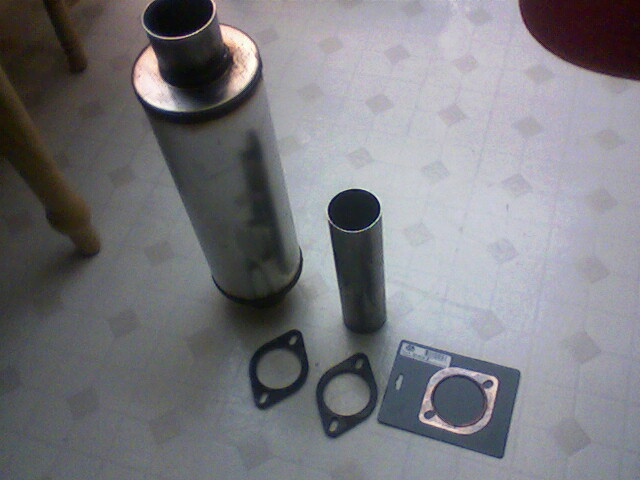

Got 6" round Magnaflow muffler, SCE 3" ID Copper gaskets, now waiting on....... T304 exhaust tubing and CRS 3" flanges....!

Well got everything for the New Cattman 3" resonator, time to get the chop saw out and start fitting this new resonator so I can get this assembly Tig welded:
1. 6" Round Muffler x 18" length, 3" in/out
2. (2) Corrosion Resistant Steel 3/8" thick, 3"- 2 bolt flange
3. 12" length, 3" OD T304 SS tubing
4. (2) 3" ID-2 bolt, SCE Copper gaskets
Old Aug 22, 2012 | 06:29 PM

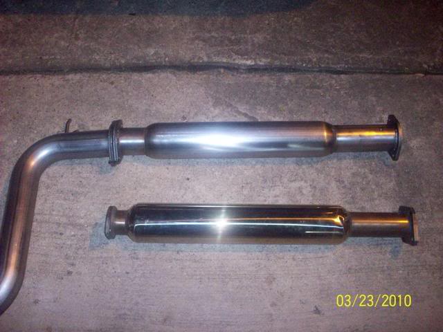

Originally Posted by TSelanne
I quoted you from another thread.... question for ya: when installing your new resonator, how do you make up for the lost 2" of pipe?
Just in case you're unaware the Resonator section is flanged and so will my new resonator section...The Overall length flange to flange is 30.625"....That's why I have the muffler/resonator, 2 flanges, 2 copper gaskets, 12" of 3" O.D. T304 SS tubing.....I don't chop up my ****.....I do it right so it's a bolt-on feature....

Well I'll shoot for this week or upcoming weekend with my resonator section.....buying school supplies and school clothes this weekend it appears! But I still be working behind the scenes getting it ready for welding!
Old Sep 9, 2012 | 09:21 AM
  #2119
CMax03's Avatar
Posts: 9,587
From: Houston, Tx
Well I pushed it back to 9-15-12, 11:59 pm....Should have that New resonator section done by Saturday night at the latest! It should be quieter off the bat but it should quiet down even more once the carbon settles inside the SS wool! This should be a repeatable procedure and maybe I can make a jig to setup a few more for those of you interested....how much do you think it's worth? The parts alone retail prices including welding, are $180.12....This doesn't including shipping!
Parts
1. Magnaflow 12649 6" round x 18" long muffler- $99.64
2. 12", T-304 SS, 3" OD, 16 guage, straight tube-$10.50
3. 2 ea Mild CRS 2-bolt, 3" ID universal exhaust flanges- $19.98 ($9.99 ea)
4.Welding-$50
Total: $180.12
extra chrgs will be included using SCE Copper 3" ID 2-bolt exhaust gaskets (2) @ $12.01 ea
