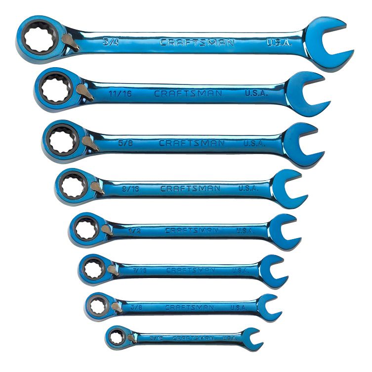

I got at the rear bracket bolts with an 18" breaker bar and a regular-depth socket to break it loose. After that, I used a ratcheting wrench to work it out of there.
I forget how I got at it with the breaker bar, but if you get in there at the right angle, those bracket bolts are a breeeze.

Get yourself a set of those for the re-install. They're seriously effing lifesavers.
