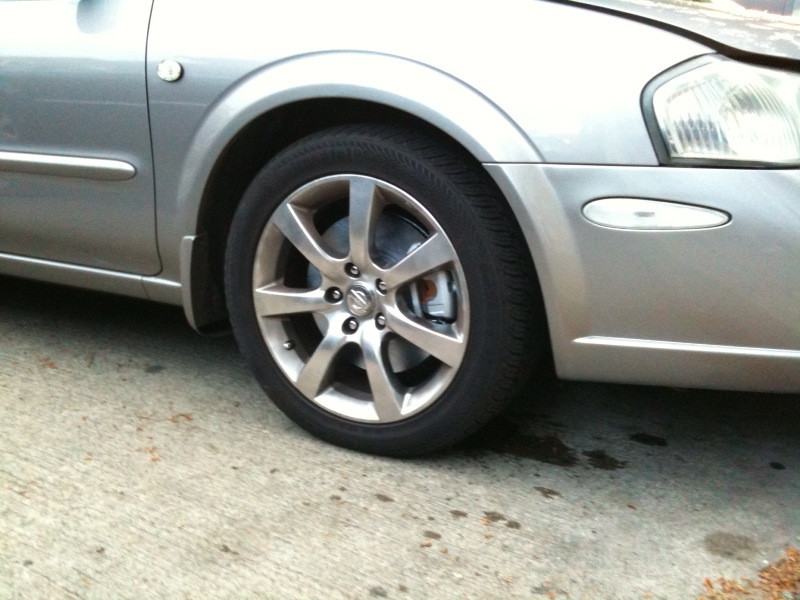

Just did the 6th gen bbk with RTP blanks and PBR Ultimates. The setup looks great, but now I've got a lot more pedal travel before they engage. Is this normal?
pic of new setup:

Thanks for all the replies. I was out of town and just checked and sure enough my calipers are on the wrong side with the bleeder screws on the bottom. Gonna try swapping them this weekend.
