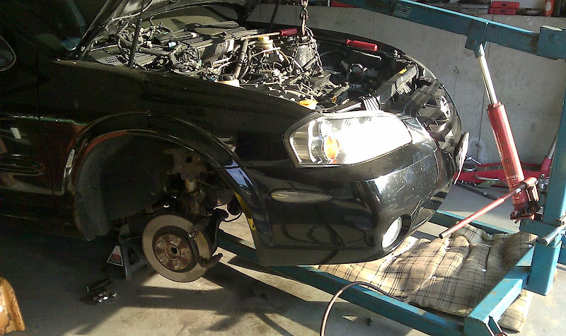

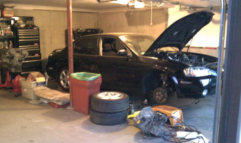

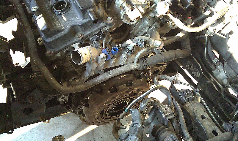

Got the engine out today and got down to business swapping everything over. Had a Gulf sized oil spill which had to be cleaned up among more and more coolant still pissing out of this old engine.Tomorrow I will finish up the swap out of parts and put the newish engine back in the car.
The upper oil pan definitly needs a swap out, the location for the crank sensor on this '05 automatic engine isn't even in the same location as manual transmission one. It sucks as that is alot of work to clean all the old RTV off the block and the 2k2 engine oil pans. Then put it all back together. If this was my car I would just pay more for a '04~'06 engine that had a manual transmission and not worry about oil pan swapping. IDK about the '07 ~ '08 engines, the crank sensor is a different part number where as the '02 ~ '06 manuals have the same crank sensor part number.
Bad news is that the two piece flywheel is gone! It looks like a pro fighter punched it in the mouth. There are bits of tooth sized metal falling out of the center of the flywheel. Its now a multi-piece flywheel...
