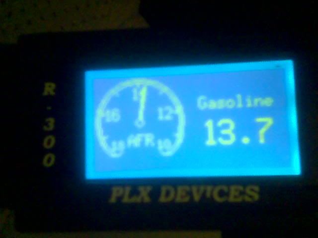

I myself have a PLXR300, nice interface as I've posted before, fully customizable with 2 speed inputs(MPH/RPM) and 3 0-5v inputs (ECT/MAF/AFR/TPS)
And the nice little readout controller is also a nice touch for 'street tuning'.
