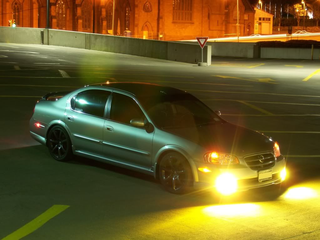

I got 55w 3000k
Sorry about the pic size
Old Nov 23, 2010 | 09:48 AM
Prophecy99's Avatar
Posts: 6,097
From: SE PA
Originally Posted by nismonegro26
I got 55w 3000k
[IMG]http://i53.tinypic.com/2nu589c.jpg/IMG]
[IMG]http://i53.tinypic.com/swu4jc.jpg/IMG]
that looks scary
and troop by blue do you mean match the stock headlight color ?
