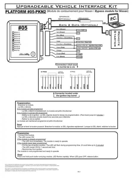

I would say you still have an issue with the viper remote start by pass module which is to get around the factory installed security system ... getting the car back to the shop that did the install would be my first thing to do ... considering you said you had no issues until the installation.

Try resetting the bypass module.
