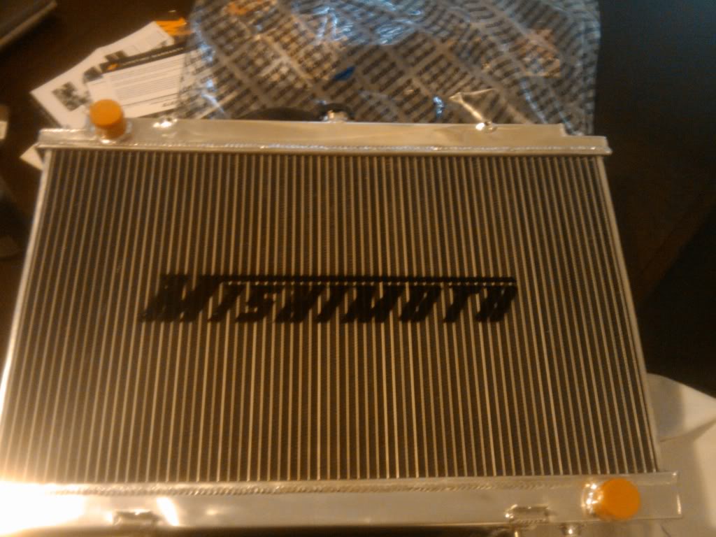

ranmas2004's Avatar
Joined: Mar 2011
Posts: 1,626
From: Lehigh Valley, PA
Originally Posted by mrpiszcz
I do have a related question, does anyone have a part# on the little rubber rings that go in the two upper radiator brackets? Mine have dried out and cracked with age letting the radiator wobble. I "fixed" it by putting some rubber tubing over the top posts to thicken them but I'd like a more permanent solution.
Because I'm all specific about my car when I ordered my Mishimoto radiator I also ordered brand new upper mounts, with new rubber mounts on top and bottom. I figured they been in there a LONG time and need to be replaced. Also the upper mounts all rusted up.....gonna powdercoat the new mounts blue. Also trying to find that hood mount that holds the little rubber sensor that tells your car the hood is closed. If you standing in front of the car its located to the right of the upper radiator mount on the right side. Thats all rusted up too, but having a hard time finding that piece...

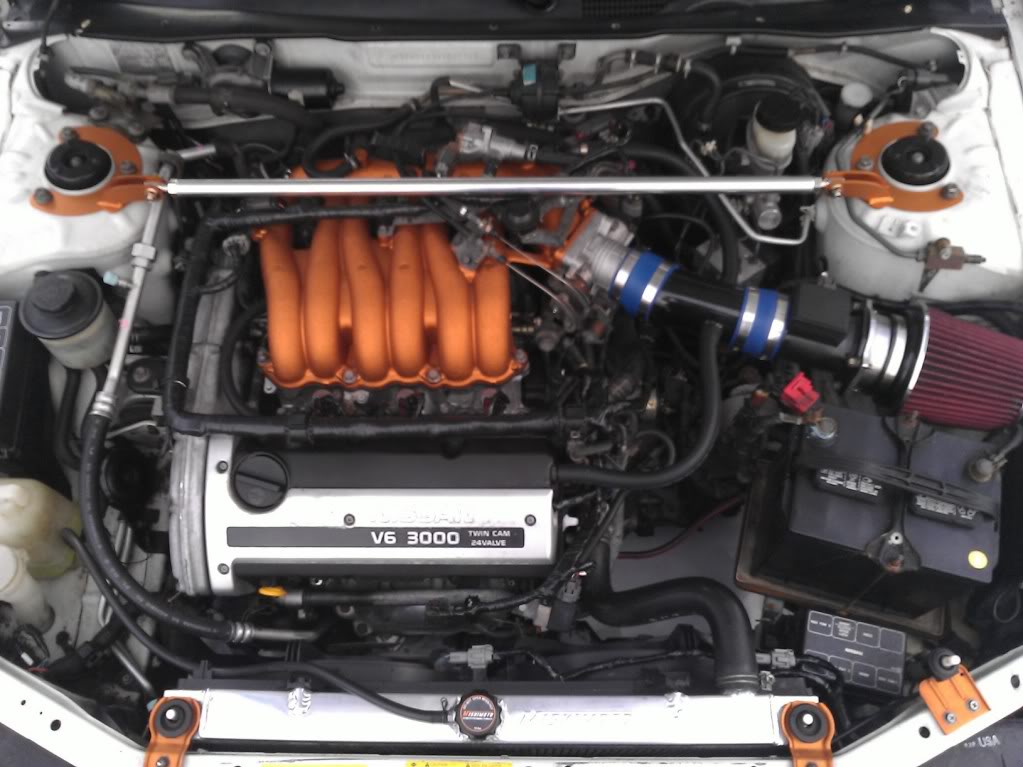

infinimax96's Avatar
Posts: 1,095
From: Salt Lake City, UT
I second the Mishimoto!
After comparing my buddies 2001 radiator housing with my 4th gen's we concluded that you could easily fit the 1995-1999 Mishimoto with little/no modification.
Also, I recommend flushing your coolant system and replacing your thermostat while you swap in the new radiator.
