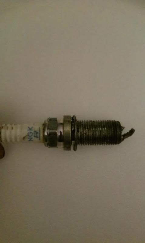

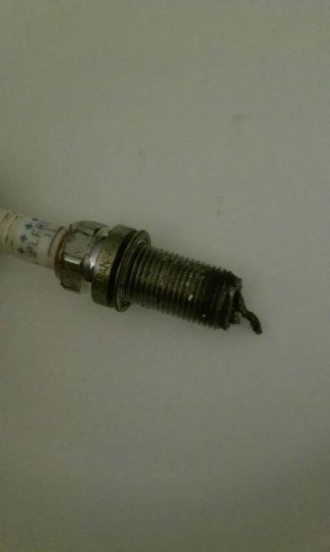

Motor went out in the middle of a swap and pulled this pulg out of cylinder #2 someone told me rob broke any in put??????

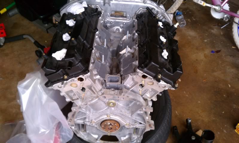

This is whats going back in 2002 6spd

Something was or is in that cylinder. Possibly pieces of the Cat or a throttle plate screw?

I would suggest you start by doing a compression check before replacing the plug and starting the car.
no cats on the car
got another motor will tear the other one down once the swap is done

Post pics of the teardown when you get to it. I'd guess something was in it as well, maybe piston ring failure causing metal pieces to build up?

Sure looks like something was beating on that plug. Did it make noise when it happened?
Maybe a vias plate screw, (if you had a vias that is).

From the length of the threads, it appears to have once been a plug for a 3.5.
Somthing has made contact with that plug. My guess is it would be the piston, maybe a broken wrist pin? Rod cap worked its way loose?
In for pics of the teardown. I want to see the head and the valves.
