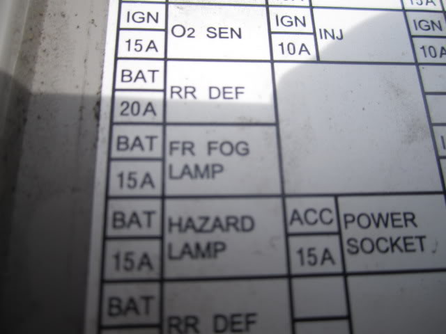

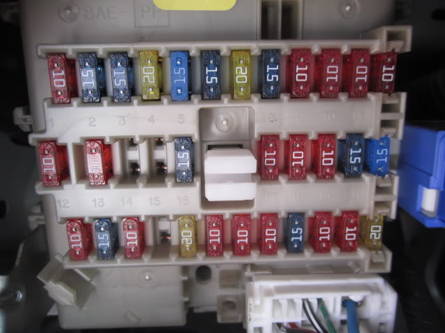

I think you may be looking at the wrong fuse. I shorted the fogs out on my 2002 once because the spade connector for the bulb was a little loose and was touching metal inside the housing. The fuse that blew was "FR FOG LAMP" in the drivers side fuse panel under the dashboard, and it was a blue 15A fuse. I put some electrical tape around the spade connector and changed out that fuse and the fogs worked fine again.
In this picture the fuse that blew was the the blue 15A in the middle of the top row, above the fuse puller, and next to a yellow 20A fuse.

Thanks for the detailed response(s). I completely forgot about the driver's fuse panel.
Consensus is I'm an idiot and will check the blue 15amper on the driver's panel. Im sure it's blown
