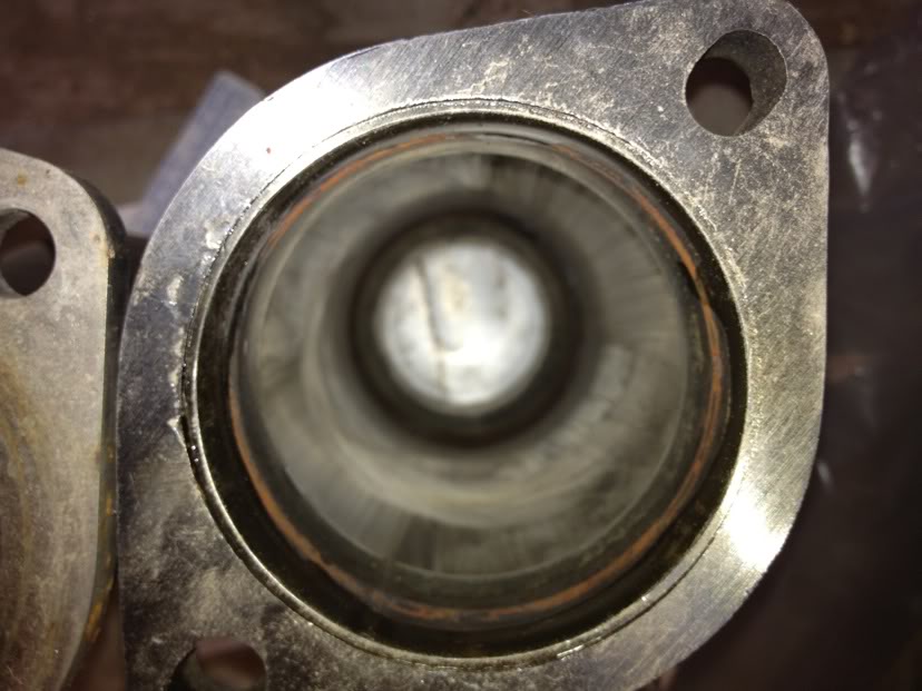

Originally Posted by VQ'rInWLA
Hmm who wouldve thunk it? TP resonated or non?
IDK. Looks it from the outside, but not really inside.

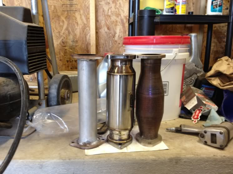

Center:

Doesnt look like its resonated. Is that the 240 3" TP?
Old Aug 16, 2012 | 03:19 PM
Rods03Max619's Avatar
Posts: 8,946
From: Diego,California
Originally Posted by TallTom
From what I read, it will quiet down a little in about 2-3 weeks so try and tough it out.
This, I remember when I did the Exhaust like WTF did I do but after a couple of weeks it majorly died down so give it a couple weeks.....
Old Aug 16, 2012 | 03:21 PM
NmexMAX's Avatar
dot dot dot ...
Posts: 34,576
From: Santa Fe, NM
No, it's not, just solid metal through the internal.
Yup, that's it.
ISIS is the brand IIRC.
Weird that they add all that mass/size, whether hollow or not, but no resonation, just mass, although it doesn't feel any heavier than the FastCat, it (ISIS) actually feels lighter.

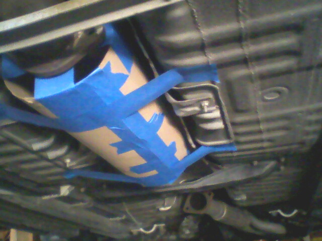

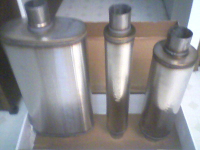

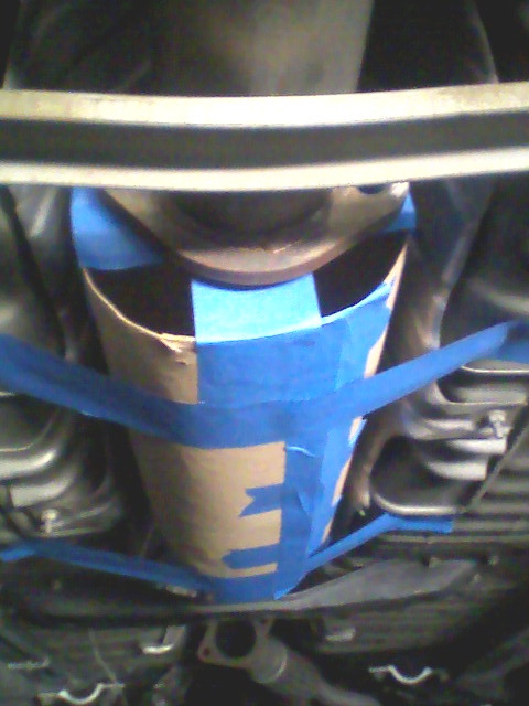

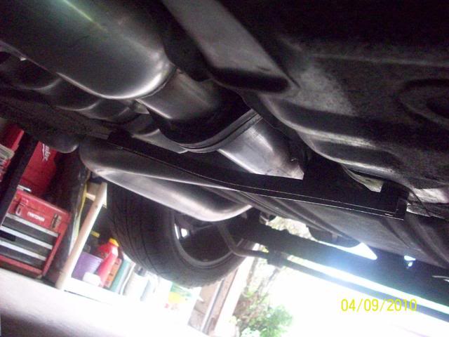

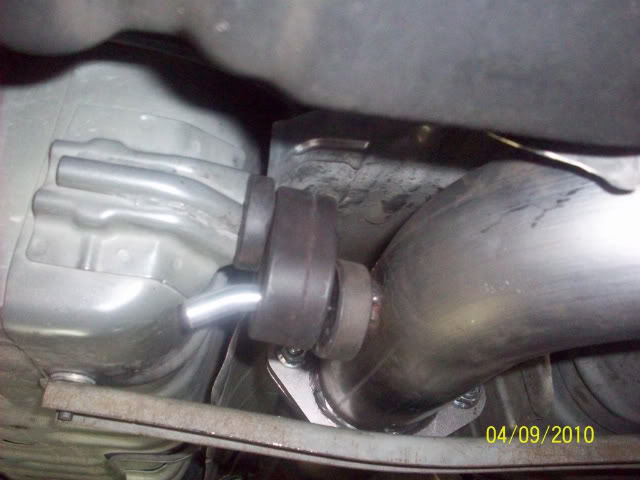

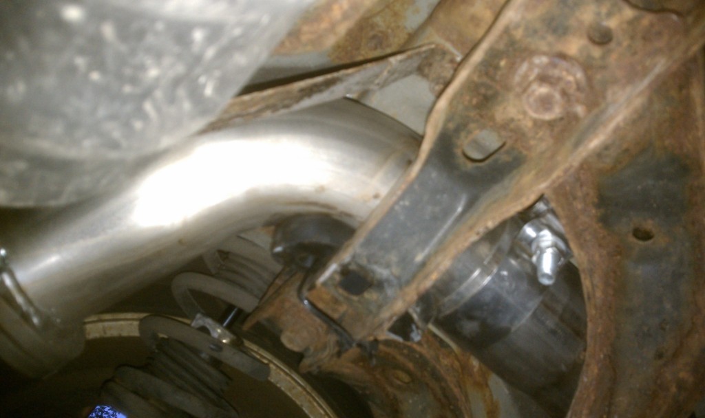

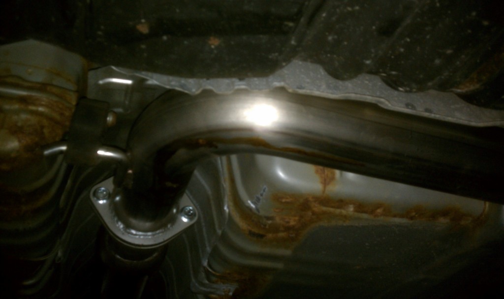

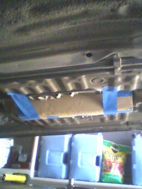

That has nothing to do with reducing the volume you need a larger resonator....instead of the 4" round x 20" long Cattman...I'm trying a 6" round x 18" Magnaflow....volume wise it's Cattman's 251.36 Cu in vs Magnaflow's 508.68 cu in which is twice the sound reducing volume than the Cattman resonator!!!!!!!

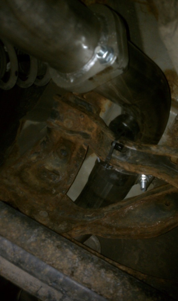

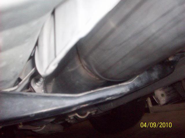

Yes, if you have any of the exhaust resting on the car, that is why your exhaust is unbearable.
There are ways to get it installed so there is no contact. You can slightly loosen the exhaust where it bolts together and twist it away from the rear section it's making contact with. I would start with where the b pipe bolts to the cat. Then where the c section (or whatever letter) bolts to the b pipe. You can gain about an 1/4" doing this.
Subsequently, you may have to loosen and adjust the short L pipe that connect to the muffler section so you can get the right angle. Then you need to go to autozone and purchase replacement hangers. I found the to be tight fitting on both the stock studs as well as the Cattman. Ensuring the muffler is firmly in place significantly reduces the chances of further pipe movement which would cause banging and vibration.
I promise, your noise will drop by 50% once you do this. This is exactly what I went through after installing my Cattman catback.
Although wrapping headers and y will not help you in this situation, as Cmax stated correctly. I still stand by my opinion wrapping does, in a properly installed setup, improve abbrassiveness of tone and does slightly improve noise.
Ill take some pics of what I've done. I felt I had to go to a bit of an extreme to get my system to not move around. But, I definately know it's not going anywhere and what I've done was not expensive. Be back later with pics.

If yall install your catbacks correctly they will clear all the support brackets...New heavy duty exhaust hangers Nismo or Poly bushing:http://www.perrinperformance.com/p/2152
plus there are other little things that help have a flawlessly installed 3" exhaust and positioned everything with it all loose helps as stated by ChrisGregg.....here's a few pics:
A Few Washers Between the Bracket and Body will Help!
Limits Catback From Sliding in Hard R/H Turns
Installng the dot @ 12 o'clock on your resonator section fwd flange will help 100%

I'm glad you posted your images, I was going to suggest you do.
Similar, here is what I've done at the muffler. This image is of a longer isolator so the muffler is allowed to move a bit more to the passenger side and ensure just enough clearance between my tips and bumper.
This is of the rear right/ passenger side of the muffler. Yes, two isolators together.
And here is the passenger side on the back end of the muffler. As Cmax has indicated, adding a half peice of an isolator to keep the main isolator pushed to the right side helps ensure the system stays to that side, eliminating right turn banging.
Nice, got to give this a Shot....

Another option is to trim the Bpipe hanger hook by about 1/4" cause that's what's banging against the floorboard in hard right hand turns.....it's not at the rear muffler but just aft of the resonator on the bpipe......I'll order some poly units just 2 see how they perform but they will have to be the same size as NAPA's 35460 cause the 35725's are too small.....I found a decent priced vender with black poly exhaust hangers: http://www2.kartboy.com/x4/ check it at I'll measure our rod size but the long ones will be choice.....people used WD40 and grease to install your hanger is a no no...use soapy water it dries will no ill effects on your rubber hangers, oil breaks rubber down and causes premature failure!

From: Jacksonville, FL
Nice mockup. Have the 6" installed yet?
Old Aug 24, 2012 | 11:07 PM
CMax03's Avatar
Posts: 9,587
From: Houston, Tx
Of course not! Trying to get it cut , tested fitted one more time and then welded.....then test fitted again! I'll be a little tight but I don't have a lot of movement and If do start having contact problem I'll switch too Poly hangers.....I joined a Sonata forum tonite ...man are we fortunate too have performance parts!!! They've been around awhile since 1985....and thereis hardly anything available
Old Aug 25, 2012 | 07:01 AM

Thanks for those tips. Reminded me of a job once where we sound-proofed a room using MLV, http://www.soundaway.com/Mass_Loaded...rrier_s/31.htm We used the 2lb/sqft stuff for that job and it was a bear to work with. Made me wonder if that could work in a trunk.... stuff is really heavy though. I wouldn't think that's worth it... (?)
Crawled under the car tonight for the first time ever. It's going to take some time until it feels comfortable under there haha.... but I lasted long enough to take some pics of that bushing. You can see the bushing zip tied to the rear cross member, and the pipe rests on that:
Also, it's sitting slightly towards the back, it's super close to the heat shield. Just about touching it.
If I pull that bushing out the pipe will def hit the cross member. There is some room to go higher, but then the tips touch the bumper when raised. Not sure what to try next... you've said to loosen the bolts after the resonator and playing w it that way and it sounds like I should buy new isolators.... did you guys have a second person helping you? Sorry for all the questions thanks for helping a noob.
