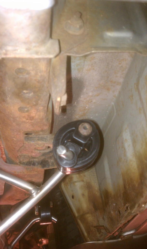

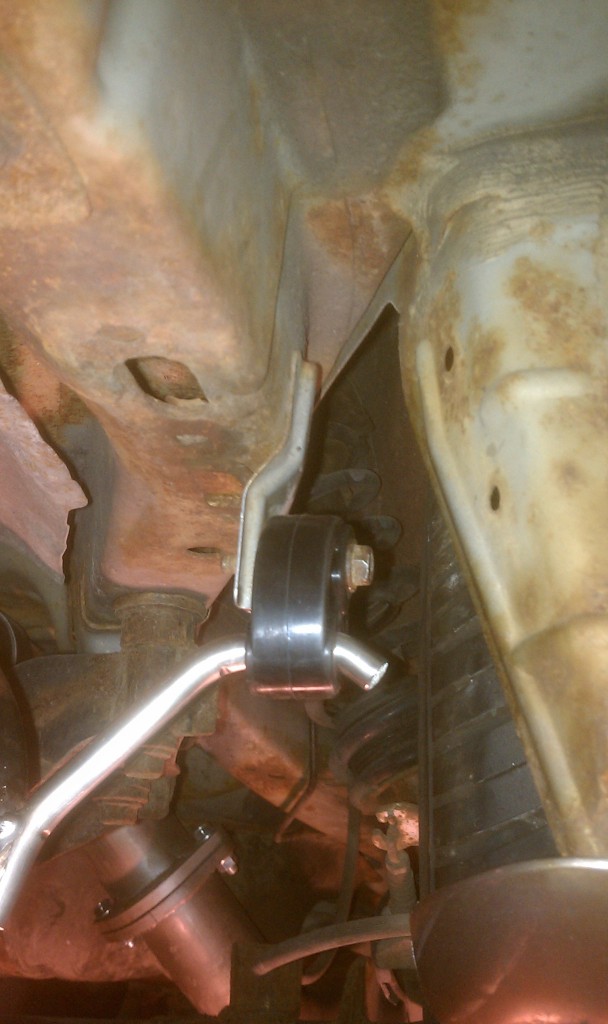

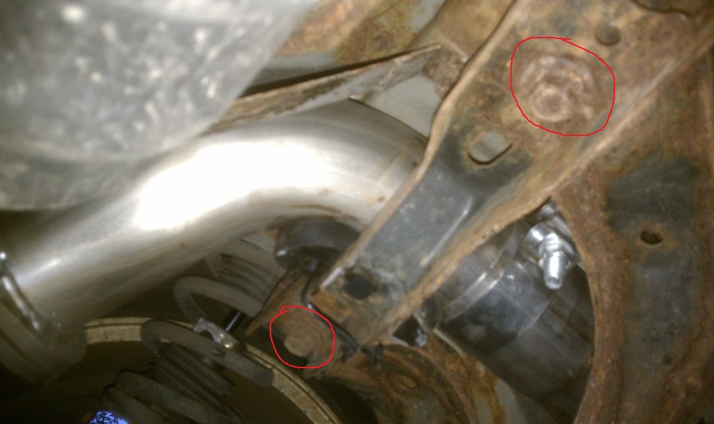

Crawled under the car tonight for the first time ever. It's going to take some time until it feels comfortable under there haha.... but I lasted long enough to take some pics of that bushing. You can see the bushing zip tied to the rear cross member, and the pipe rests on that:
Also, it's sitting slightly towards the back, it's super close to the heat shield. Just about touching it.
If I pull that bushing out the pipe will def hit the cross member. There is some room to go higher, but then the tips touch the bumper when raised. Not sure what to try next... you've said to loosen the bolts after the resonator and playing w it that way and it sounds like I should buy new isolators.... did you guys have a second person helping you? Sorry for all the questions thanks for helping a noob.

So, take that peice off the cross member, just barely loosen the bolts on the pipe and rotate them- so you won't have to replace the gaskets, then work with the isolators.
If you were closer, I'd just help ya out. It may take getting under the car and driving then hearing it bang or vibrate and get back under there and negotiate some more. But, you can do it.

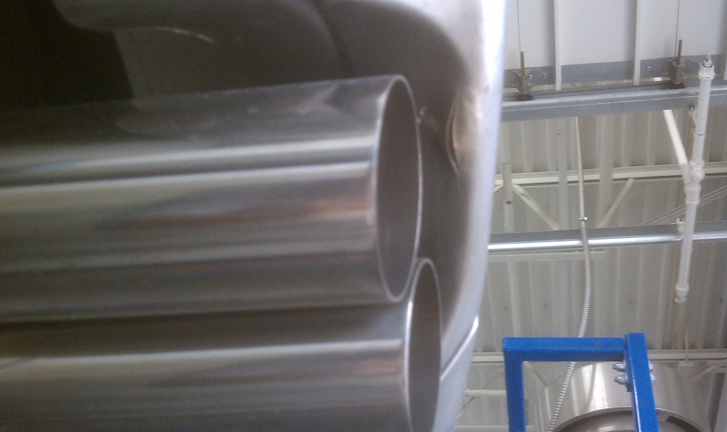

My tips are causing cracking from the heat. They are not touching, I can get a fingertip between the exhaust tip and bumper.
Edit; shortened

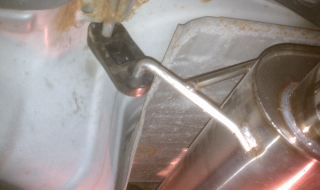

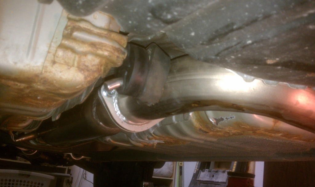

Well third time's a charm. First time was just jacking up the car and being able to lay under it without freaking out. Second time was to count bushings and test where it was bumping and looking at all the posted pics for comparison. Rnd 3 took a bit longer than I thought, but mainly 'cause I was doing noob things. Like trying to find the right sized allen wrench to unscrew the wider part of the hanger... o wait, that doesn't unscrew!
I found that this was the money spot. Without it being solid here it would bump frame going thru the rear axle matrix no matter what. I used the 35725 bushing and rotated the bigger original one upwards.
This longer bushing was a lifesaver. The 62-00901 and 17163 bushings were too short - I mean they would work but the tips would end up too close to the bumper (and it's already cracked from the heat). Now the exhaust tips are *just the slightest bit crooked because of this bushing, but you can't really tell. This was the bushing the installer used between the rear axle and pipe.
Otherwise I used 2 more 35725 bushings for the other hangers. They lifted things up to a nice height. All I had to do was drill out the top holes to 1/2 in. dia. and they're good to go.
No touching, no banging, no more 'resonating'. Getting the pipe off that bushing reduced the in-cabin drone quite a bit, especially at the 2300rpm spot. Still pretty loud though, so next I'm going to buy the parts for the "CMax resonator" and go that route me thinks...
