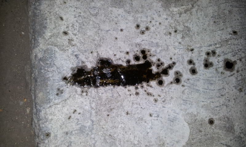

The last week when I was parking my car in the garage my dad noticed a spot of "oil" in the ramp. My first thought was "Oh sh*t, My babe it's bleeding!" but after a little examination of the "oil" I noticed that it wasn't oil at all. It was a weird kind of liquid with a rusty like smell. I checked almost every part under my car but I didn't find anything leaking and all the fluid levels was OK.
So the last friday I bring my car for an alignment job and I remember to check the source of the leak and I found that the rear engine mount was bleeding.
And after checking in some parts shops the price of the mount it's at least of $80 dollars. A little bit expensive for a piece of rubber filled with "oil".

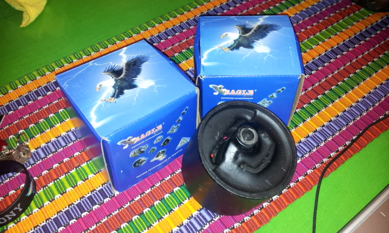

Thanks for the advice guys. I just get the couple of replacement parts for the engine mounts. They are exactly as the original mount but you only need to press the old out and press the news in the support mount.
Replacements price: $42 (both)
VS
Stealership price of engine mount: $480.00 (each engine mount)
The only "bad" part about this it's that I'm going to have normal mounts and not the magic and mystical electric mounts. But it's ok, anything that helps my babe to keep her running.

Pretty sure they dont make mount inserts for the automatic mounts. You understand you'll have to buy the standard mounts for the manual tranny, press those out, then these in. Kind if pointless if you're buying new mounts though, IMO.
The "magical" elect mounts prevent vibration at idle for auto tranny Maximas. Although the vibration is minimal IMHO, that is their purpose.......so you know what to expect.

Believe or not I found the replacement for my engine mounts BUT without the electrical element that the OEM engine mount got. They fit perfectly into the mount housing.
Originally Posted by BigLou55
your right, he is going to have to go to a scrap yard and find a set of manual mounts to gut.
to the OP: You may have been better off with ebay after the hassle you may face with getting all this done. Especially if you don't have the right tools to do it yourself.
I was thinking in go to a scrap yard where a 1999 Maxima it's sitting without engine but with the engine mounts. But after I found the replacement engine mounts I forget that idea.
Weird but true, the replacement engine mounts got a hole where fits the sensor but as this mounts aren't filled with the special liquid as the OEM ones, the mechanic filled this gap with silicone (for making them waterproof) and put the sensor in place.
