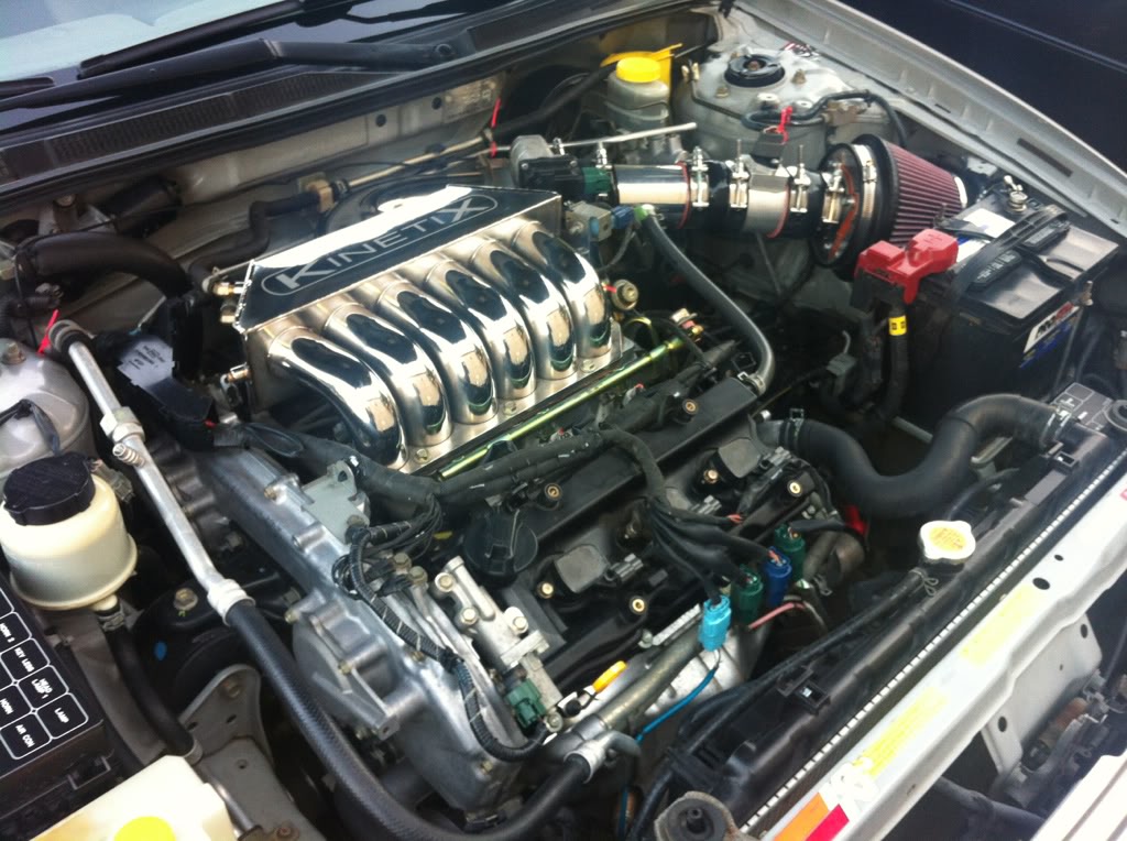

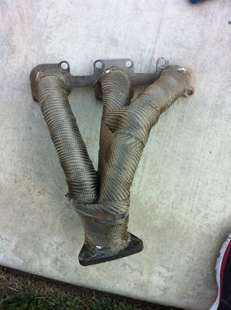

Pictures doesn't look like headers are on at that point, not a current picture?

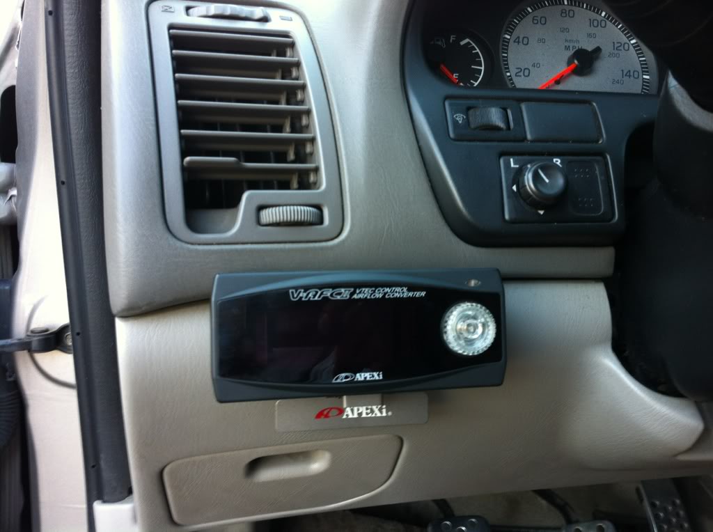

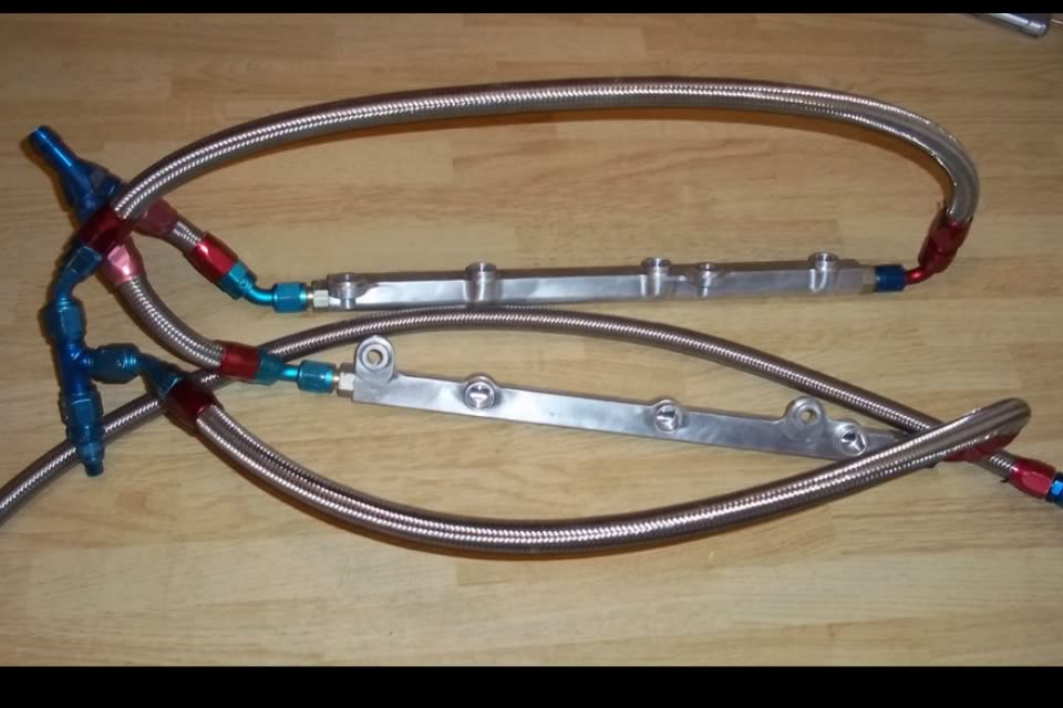

I'm actually adding the 350z injectors with 350z obx fuel rails

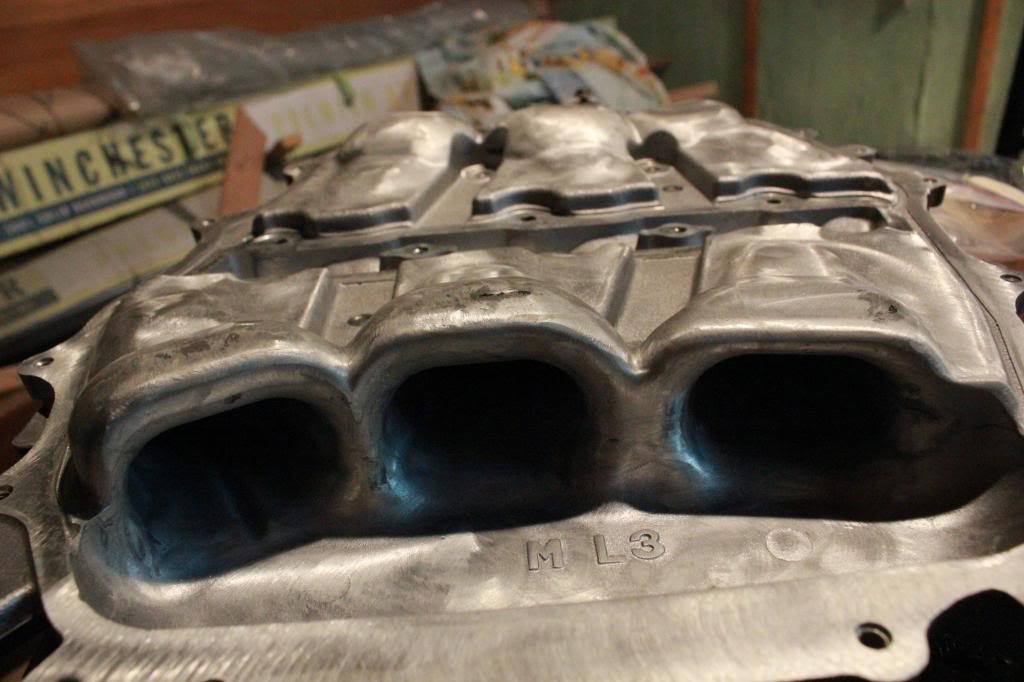

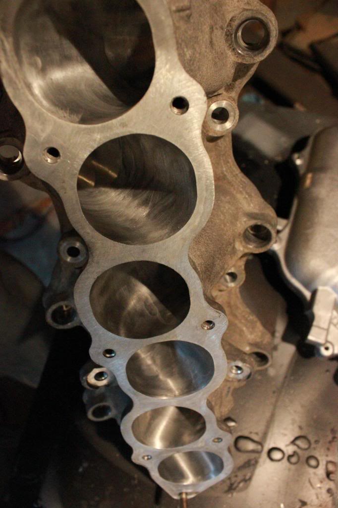

I hope you're planning on a tune right after this, you're really pushing things without a tune this is all pointless and only going to hurt things. Sounds like a tune is on your 'hit list', you just might want to move it up the list a bit more

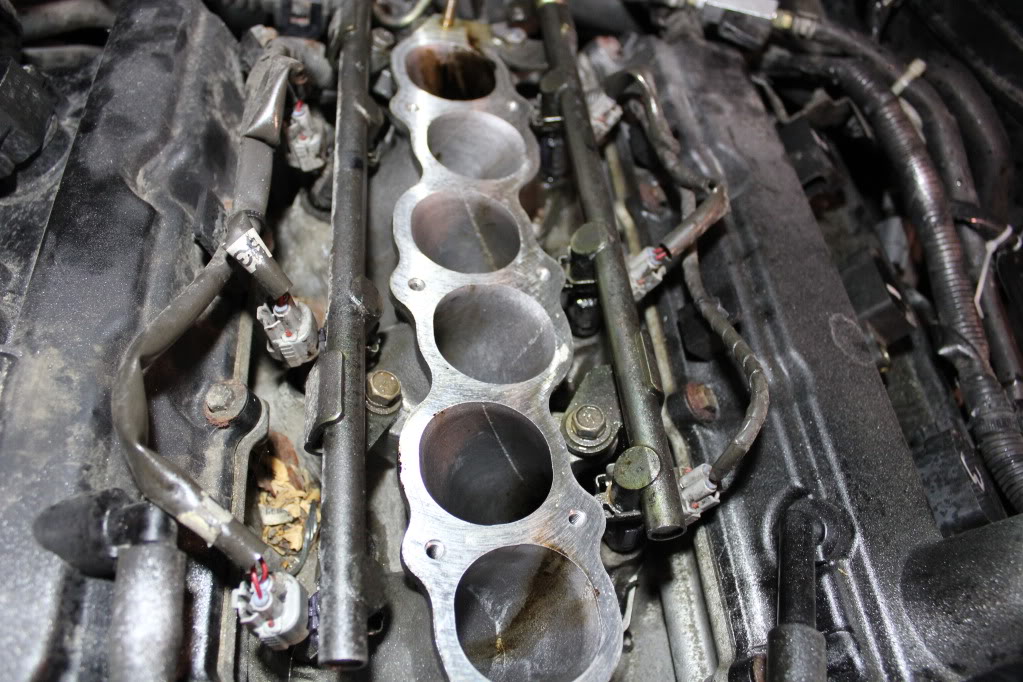

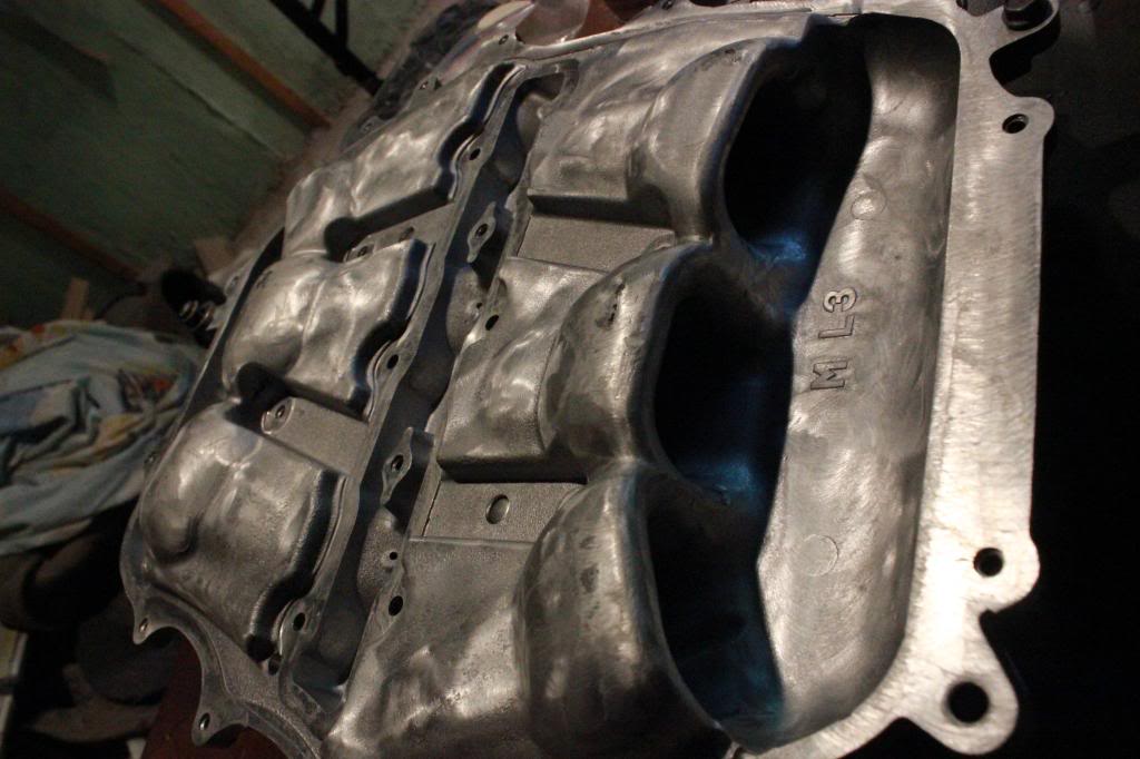

Anyways, here's mines that I did last night (RWD VQ35)
Before Polish/buffing, note how nasty and rough the casting left some of the surfaces

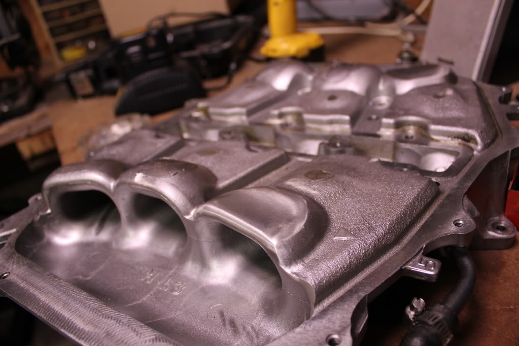

And after:

That's awsome work bro, and yea im planing on tunning ASAP but the shop is 2:30 hours away so u think the drive will affect me in anyway?

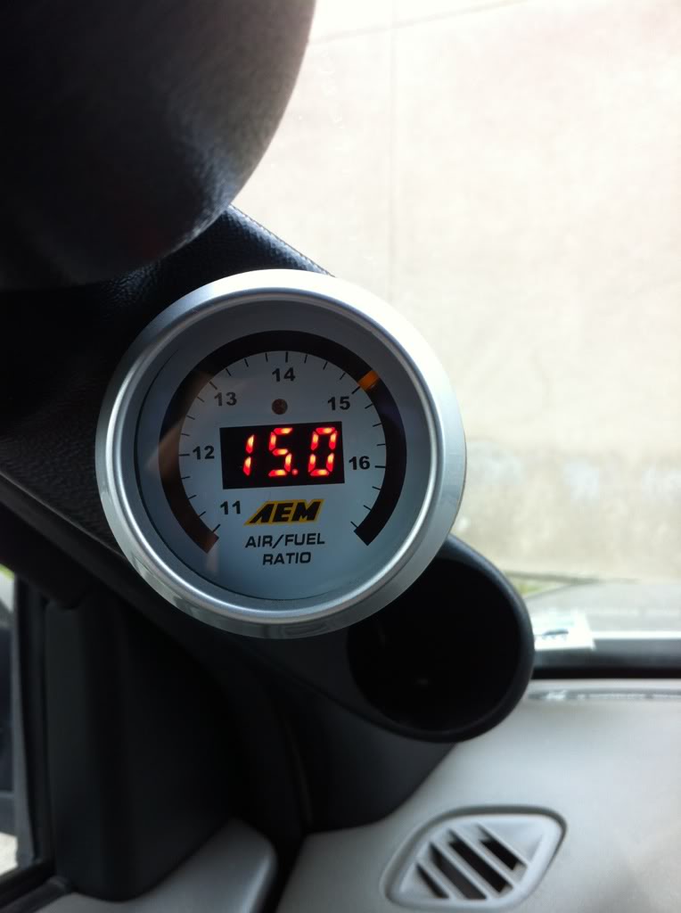

I wouldn't drive it without a wideband to know what is going on, personally
That at idle it goes from 14.8 to 15.0
Is that good or bad??

Those afrs are fine at idle, if you have a wideband running just make sure it stays under 15.3 roughly under load or at higher rpm and you should be ok.
Putting the stock intake on for thedrive is a good idea either way

No, I don't have any logging capabilities. I haven't even installed my vafc yet but will do it before I head to the tune shop.
It's just mounted haha
