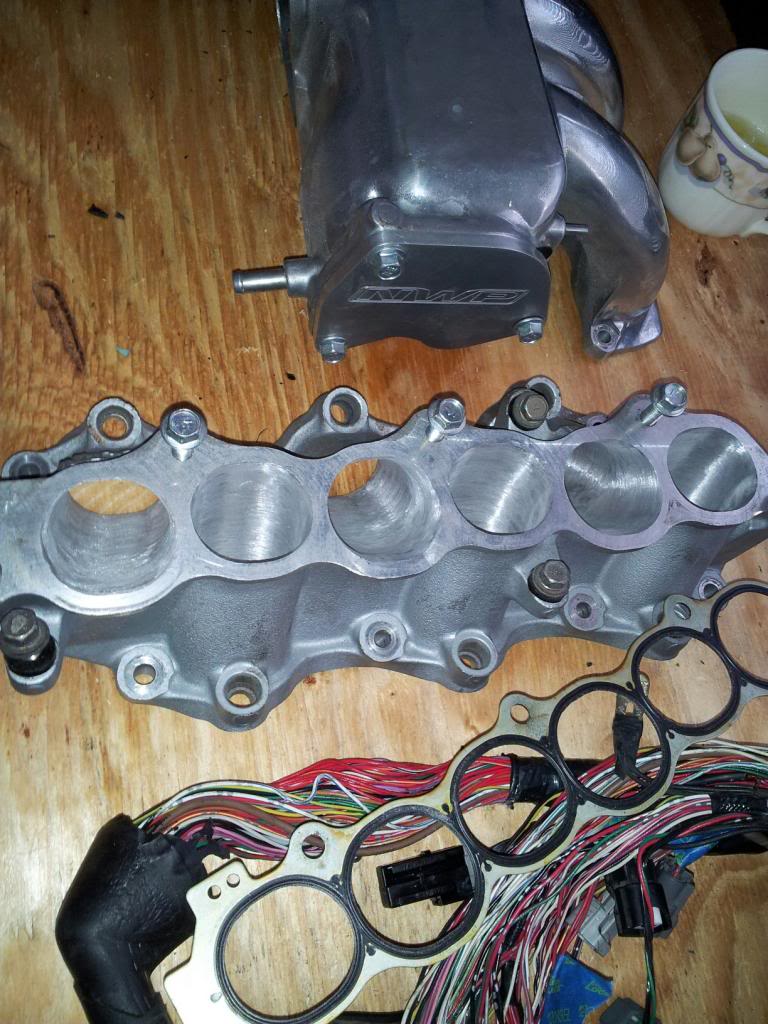

The regulator is in the fuel pump, the fuel damper is in the rail. And a port and polish might get you 5 hp

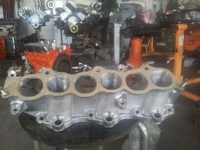

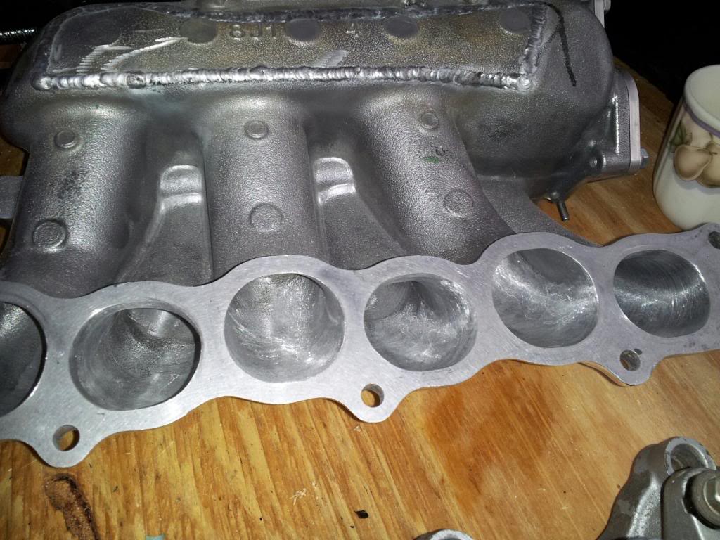

I'm trying something different. I wanted to open up the runners a bit for more flow. So I ceramic coated the outside of the LIM. I removed all the casting flaws on the inside of the runners with a die grinder and flap wheels. I then submerged the LIM in a solution of anodize/chrome remover. It dissolves aluminum very slowly, but didn't touch the ceramic coating. I left it in the bath for about a half hour. Looked like it was sitting in a bucket of 7-up. Then I very carefully taped up the outside of the LIM and then sand blasted the inside of the runners so that they got that stock look. Ie not smooth polished aluminum but that gritty look. LOL I figure I opened up the runners by about .010 - .020 " diameter.
Old Jan 28, 2013 | 08:55 PM
  #54
so nasty nismo's Avatar
Joined: Feb 2010
Posts: 485
From: Bakersfield, Ca
Dam it looks awsome bro. I installed the 350z injectors and it was a total fail lol

Nice work ray, that's taking it to the next level bro! Very smart move not making it too smooth as well

Actually that is a trick that a local former Formula One engine builder/mechanic uses that same technique when building High Performance Turbo engines. He sand blast the runners to create a bit of turbulence, and you get too choose from (2) port styles (street or race).
Old Feb 1, 2013 | 09:59 PM

I remember reading somewhere a long time ago that you don't want the runners to look smooth as glass.

Exactly, there has to be a boundry layer of disturbed air especially on a wet intake system so the fuel didn't puddle on the surface but atomized instead....I would guess in a dry intake there's a boundry air layer that acts a wedge or bearing like oil does to decrease the air friction, which in turn increases air velocity resulting in more torque....

I'm no physicist, but it always related to me, A golf ball. If its 100% smooth it won't go as fast or far, the dimples and rough surface make it faster, etc.
There its obviously in depth reasoning and testing behind this
