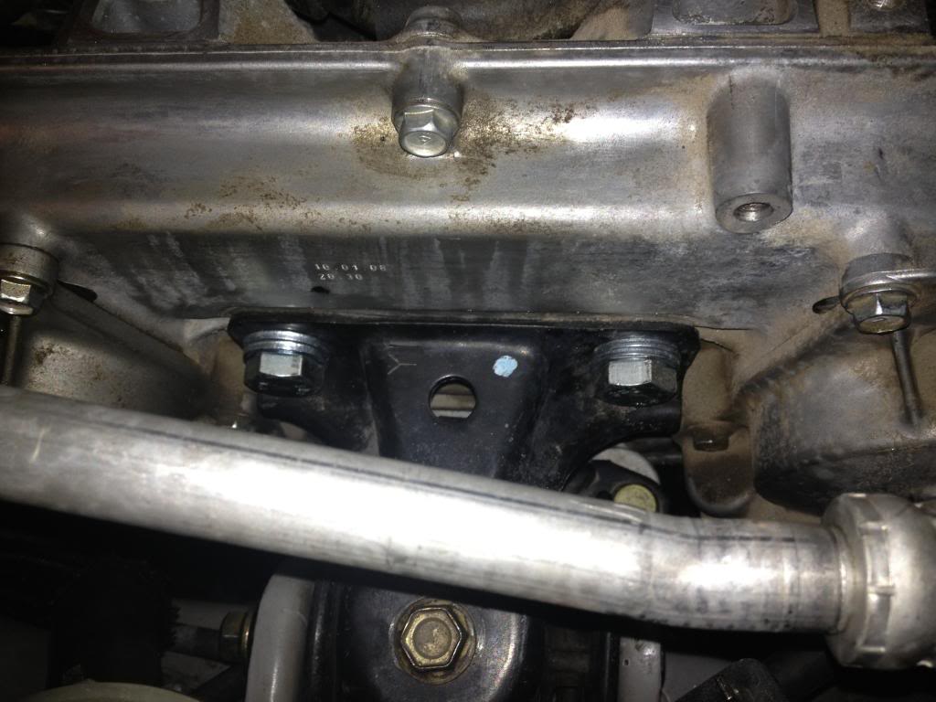

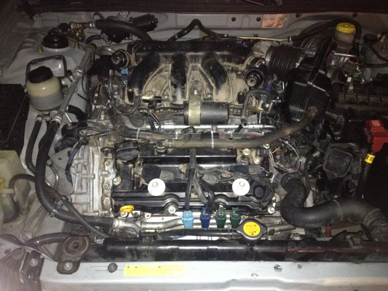

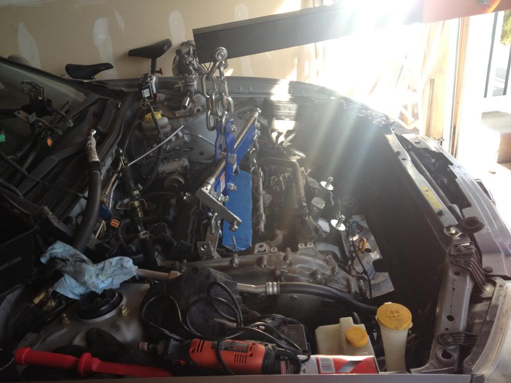

Today I got the engine installed in the bay. I had to do a few things to make it all work.

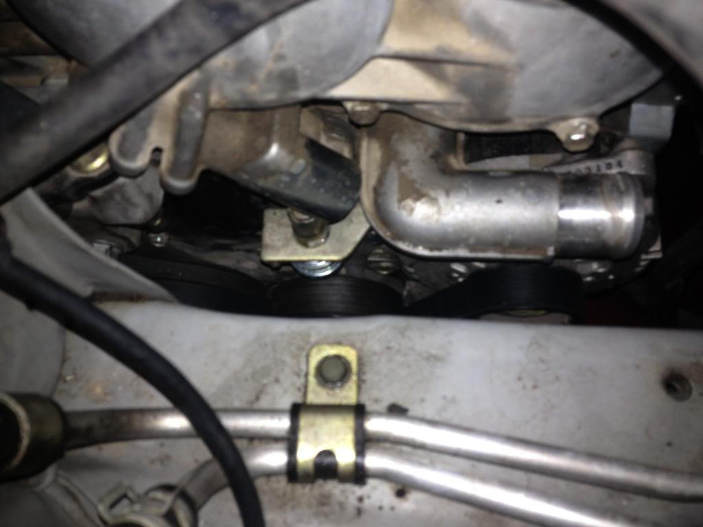

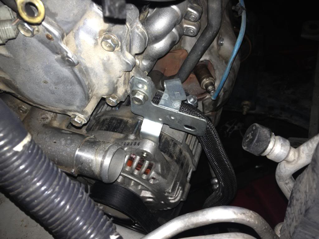

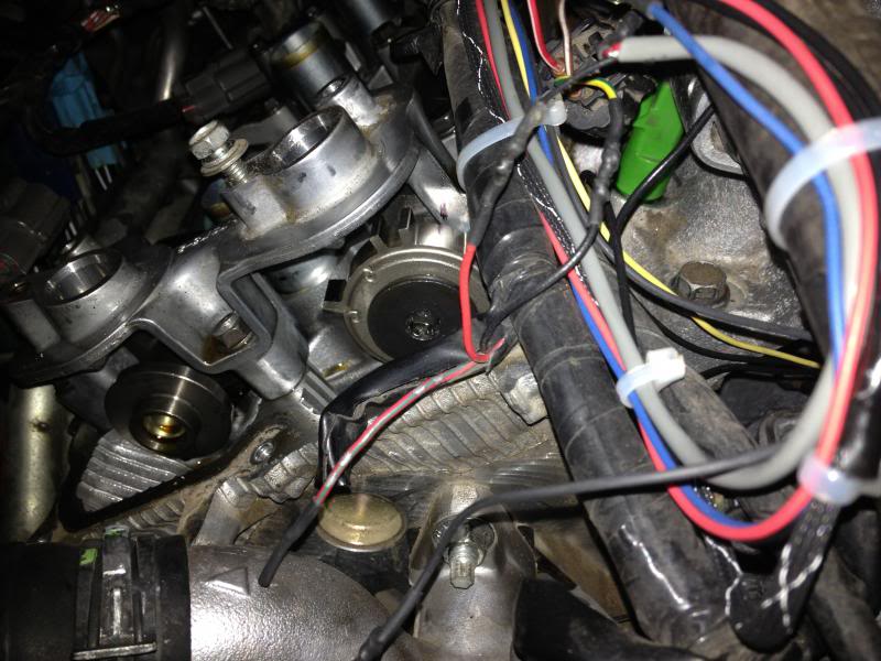

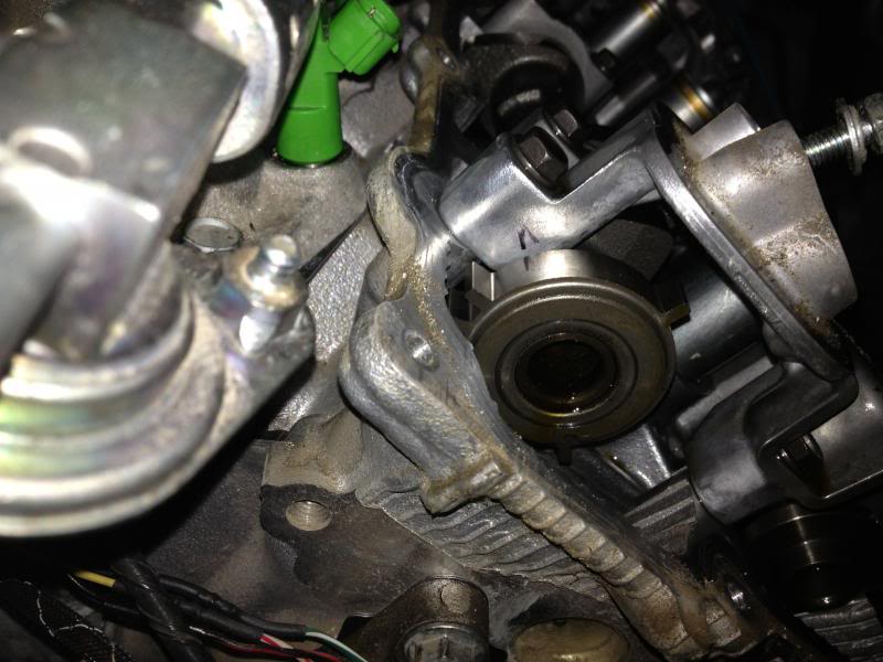

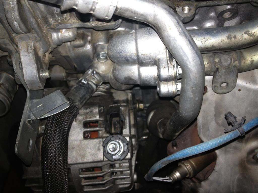

I fabricated a mounting point for the alternator using parts off of the 08 engine, it didn't come with the 08 alternator mounting bracket for whatever reason. Either that or I lost it in the process.
Just like suratt's build, I had to bore out the holes for the upper passenger side mount and get new bolts. Worked just fine otherwise. Also, the adjuster has the washers on it to space it out, ended up having to use quite a few and it was a tight fit for the belt, especially since it's a brand new belt. It looks like I might have to pull off the bracket again to fit the connector to the VTC solenoid on bank 2. It's a tight fit.

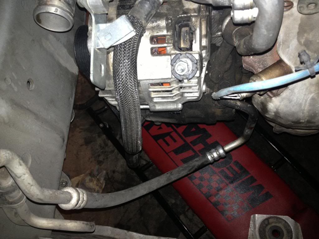

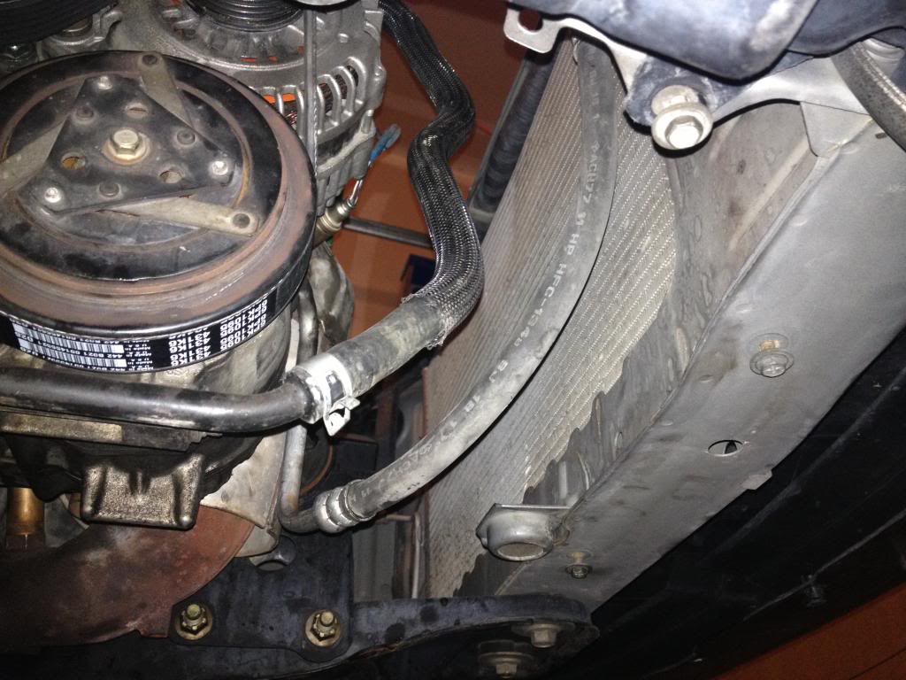

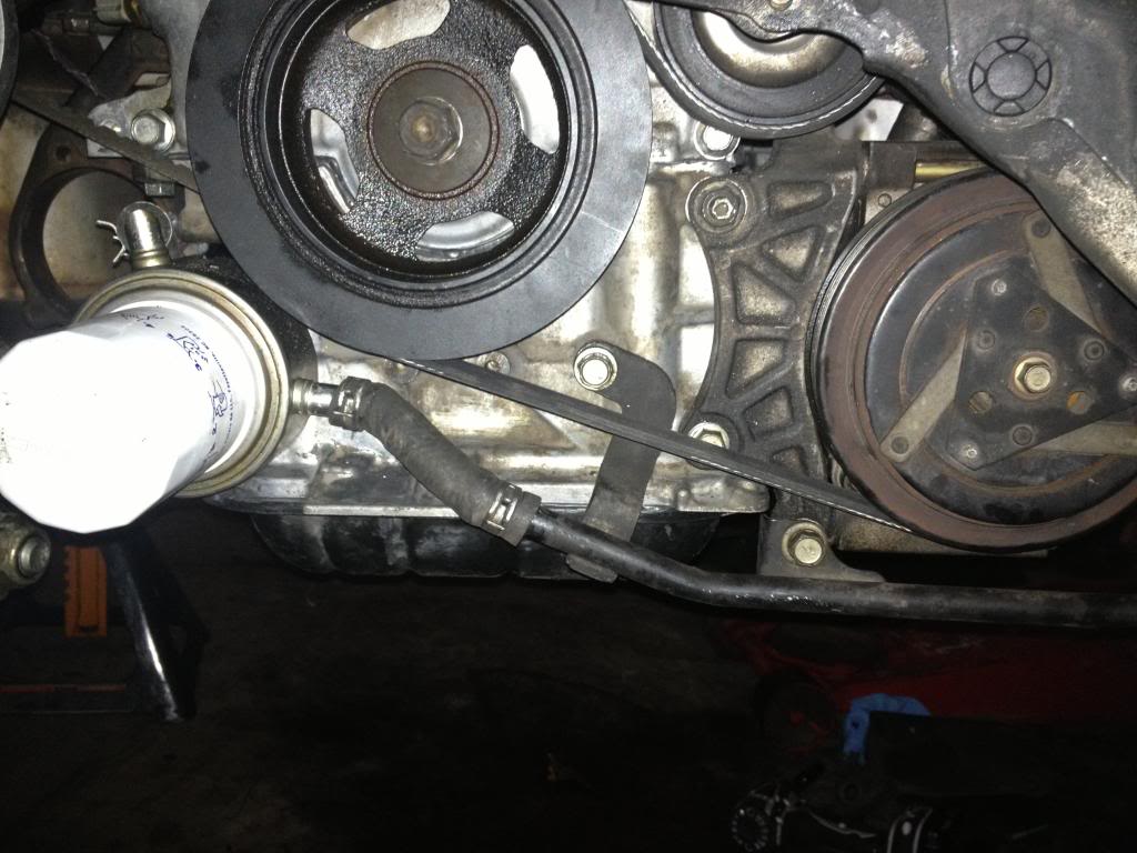

The oil cooler I was able to make fit using both the 03 and the 08 cooler lines to make things fit with the 09 fitting coming off the water inlet tube. Seems like it fits perfect! I will know more when the radiator is in.
Pictures from today.

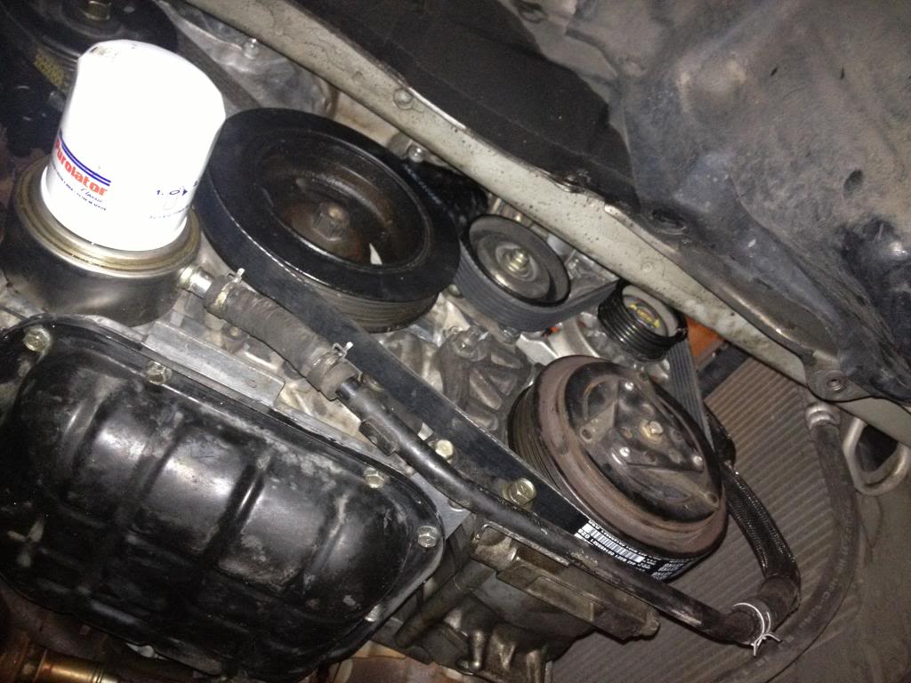

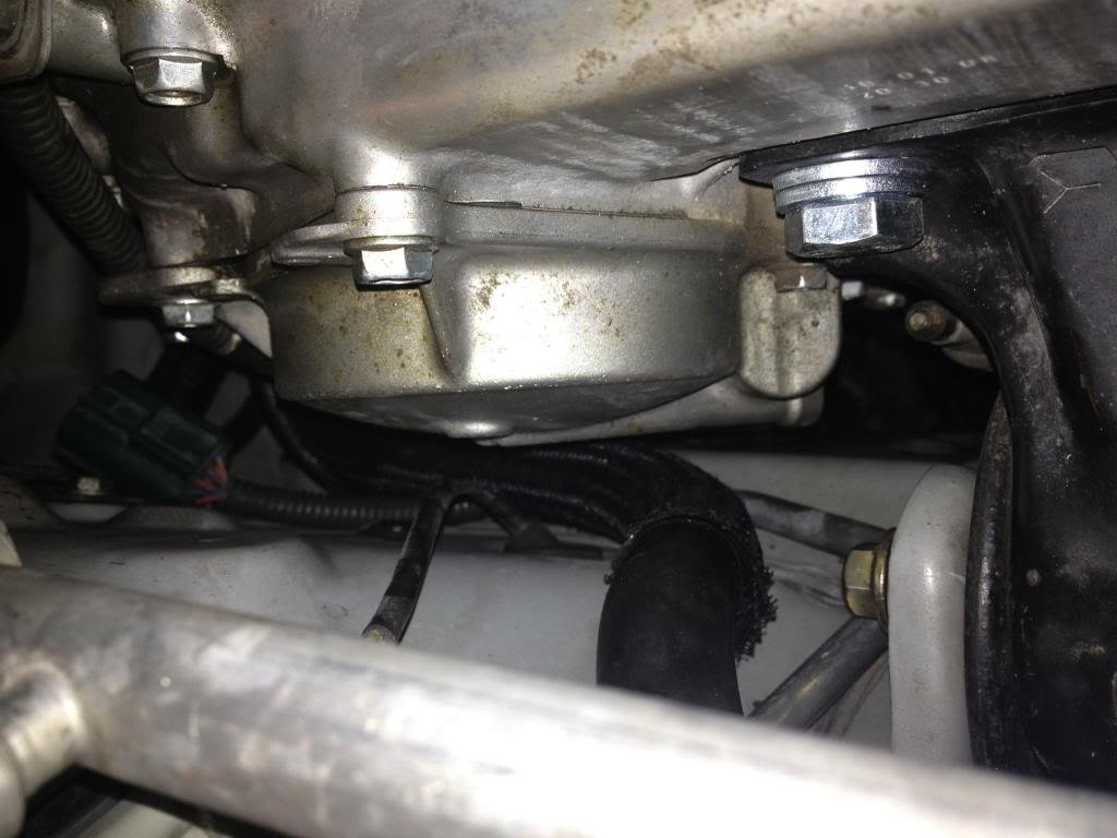

This one looks like I might have to cut a longer piece of hose to fit better. Will probably do tomorrow.

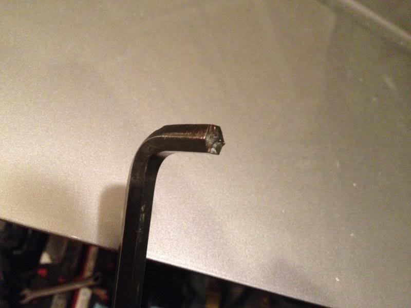

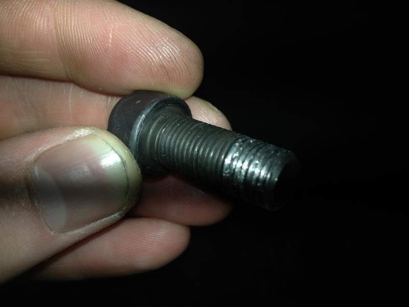

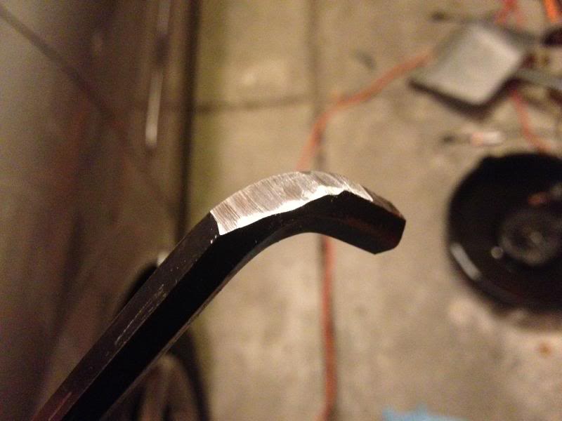

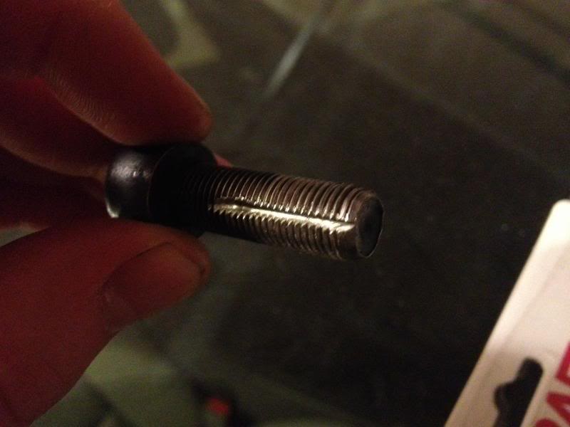

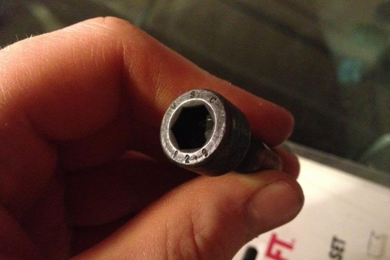

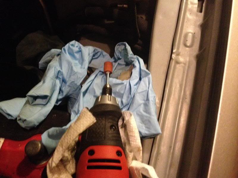

When I went to put up the flywheel I noticed that it seemed a tight fit, so as I was pulling it off I dropped it on my hand. Also, when the flywheel hit the ground it wedged one of the flywheel bolts between the plates and ruined it. Me being dumb I thought it was good enough to be OK and I threaded it back in. Well, it didn't go in all the way.
SO at work I have a few machine shop items available to me, and with the help of a co-worker we came up with a homemade thread tap.
Skeptical that it would work, I tried it anyways, and it worked beautiful. We then modified a bolt like the one above and made it work for a flywheel bolt. It's actually nicer than the factory bolts honestly, and at 50 cents a piece, totally worth it!

So by grinding some kind of grove on the bolt you can use it as a die to tap the hole? Hmm cool, I learned something today... Nice work there man. Keep the pics coming.
I'm sure it's not as effective as one you would buy; however, to chase threads you screwed up I couldn't believe how good it worked. I wouldn't use it to tap a new hole.
i would measure the weight of a standard oem flywheel bolt and the one you used as a replacement
if the difference is too big - i would not use it, because of moved balance
of course your flywheel wouldn't start vibrating the next day, but is you plan to use it for another 200k - better to go with oem

I figure the weight difference would be minimal. It's exactly the same dimensions as the stock ones. There are 8 of them and I can't imagine just one would make that much of a difference. I guess we'll seeOriginally Posted by shaks
i would measure the weight of a standard oem flywheel bolt and the one you used as a replacementif the difference is too big - i would not use it, because of moved balance
The bolt is stronger than a grade 8 I was told. That's what the fastener shop told me, and that's all they deal with is fasteners so I trust that. It torqued down just fine with all of the others.

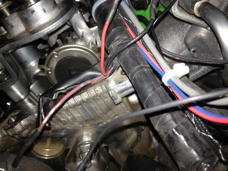

Right now i'm getting the wiring all sorted out between the 03 and altima 08 FSM's. I think I finally got it figured out-- Now just to wire it up!
you could swap all of them to new ones as well Originally Posted by q.man06
I figure the weight difference would be minimal. It's exactly the same dimensions as the stock ones. There are 8 of them and I can't imagine just one would make that much of a difference. I guess we'll seeThe bolt is stronger than a grade 8 I was told. That's what the fastener shop told me, and that's all they deal with is fasteners so I trust that. It torqued down just fine with all of the others.

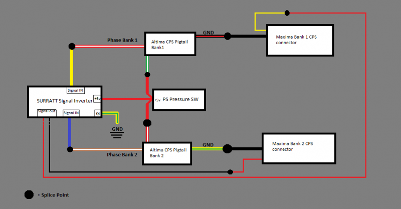

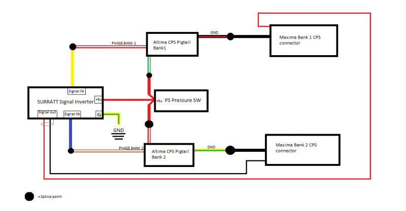

Here's what I drew up real quick to show how the wiring coincides with the altima harness connectors for the Cam sensors.

Nice Allen head bolts are normally gr 8 - 10 or higher just checking
hey man,
looking at the cam signal inverter wiring diagram trying to figure it out. I'm not sure if its correct.
I'm confused at the ECU, the 2 wires going strait to the cam pos connectors.
The ecu cam sensor wires should be going to the OUT wires on the signal inverter. (the grey shielded wires red and black).
Originally Posted by SurraTT
hey man,looking at the cam signal inverter wiring diagram trying to figure it out. I'm not sure if its correct.
The two black wires connecting the ECU to the CMP connectors are just showing the cable between the connector and the ECU. I should have made that more specific.
The bank 1 and bank 2 Cam position sensor connectors are the female ends that head back to the ECU. The black and red wires coming off the inverter that are circled with the shielding showing it's terminated in the signal inverter (I assume at least, your instructions didn't mention terminating the shield to anything). I think I might go back through and label all of the wires for their respective signal and repost-- maybe tomorrow.
CMP pigtail pinout per 2008 Altima FSM

Btw, that bolt you used for your flywheel is a 12.9 so roughly 50% stronger than a grade 8, but less resistant to overtorquing.

I thought that's what it's number meant. I just wasn't sure. Thanks for the info!

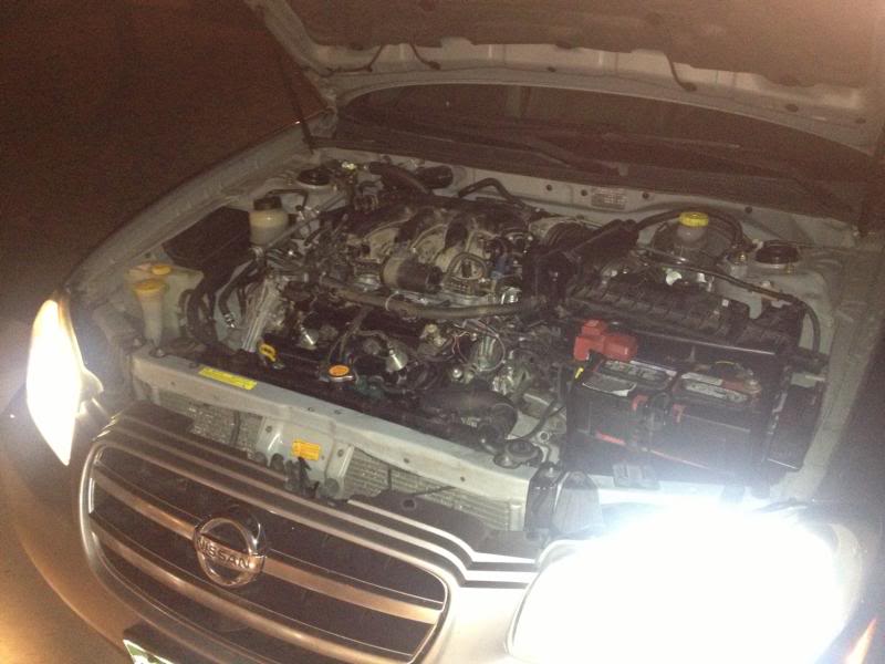

Tonight I got her all wired up and roadworthy. She drives great! My old engine lost that smooth smooth running feel and it's really nice to have that back.

Here's some pictures of it in the car! The fitment of the outer components was OK. The air box doesn't fit exactly where it used to be, although you can still get a bolt or two in there. Upper radiator hose interferes with a protrusion from the front valve cover, but a quick cut fixed that. It really went together well overall!
So... since this is out of a 4th gen altima, does that make me the first 5.4 gen max? I mean, 5.4 sounds lame, maybe we should add it up and make it 5.9 gen... I dunno, thoughts?

5.4 Altimax?
5.4 Altimax?
1st off congrats on your build..... I cant believe you got it up and running so fast!
The 1st and 2nd gen Altimas didn't have VQs so they don't count. Your Maxima is a 5.5 so I would name it 5.6. or 5.75.
To put it another way: which year/gen Maxima has the Vq35 closest to that altima vq35? I would then go from there.

Here are the wiring diagrams I promised, along with a few photos. It's been snowing like crazy here so I haven't had the time to update like normal. It's been about 100 miles since I moved the signal plates and NO CODES!

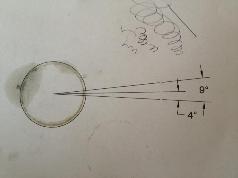

To move the signal plates, I used a sharpie (accurate, I know) and a CAD drawing that I printed to fit the signal plate diameter. The picture is of the used drawing, I can upload the actual CAD document if anyone would like it.
Revised Signal Inverter wiring:
Throttle actuator wiring:
I had to modify an 8mm allen wrench to get at the signal plate. I cut about 1/2 inch off the end, and grinded down the angular part.
To cut off the tabs on the signal plates, I just used a grinding wheel on a dremel tool. Took them off super easy!
Sharpie mark on bank 2
Sharpie mark on bank 1
