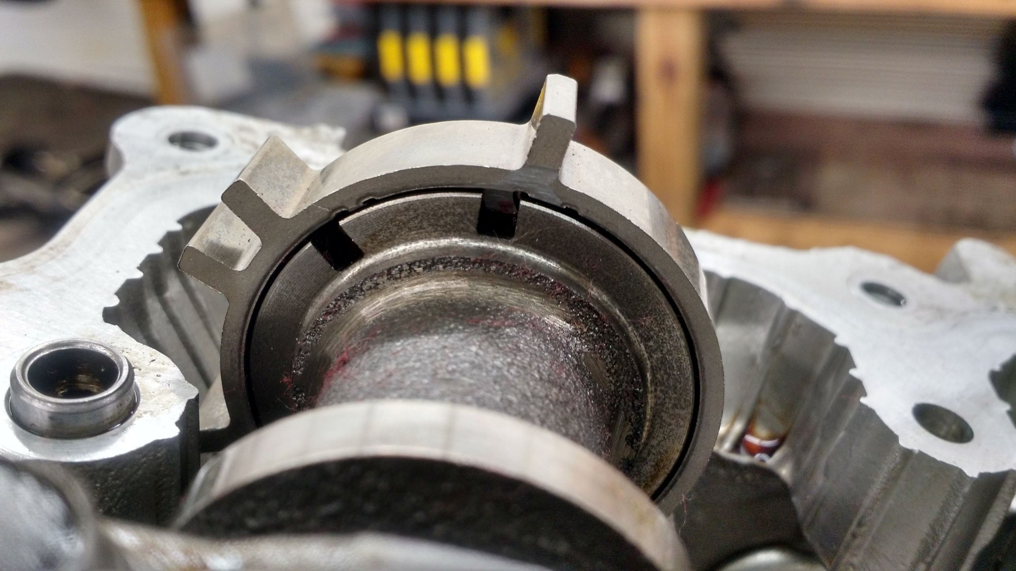

It's supposed to be what is stated (I measured 3.3mm, darren listed 3.5mm) but it didn't work for me. It wasn't worth the trouble of doing anything except getting it to work. I was not amused that I had turned it the same as the others and it wasn't even close.
This is the pic Darren sent me. As you can see, it's MUCH easier to just line it up based on the grinding marks.
