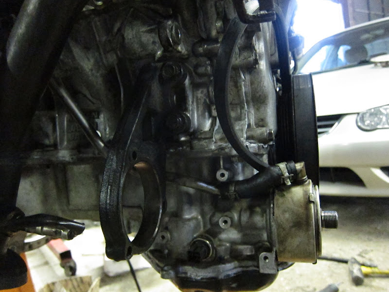

I also re-installed the oil cooler from the Maxima. The altima one is much wider; however the notch it lines up with on the oil pan is not the same between the oil pans. I decided to keep the maxima cooler because it fit a whole lot better. Just have to run a hose up to the inlet pipe and we're good to go. Didn't get a picture of it specifically, but here's where I stopped for the night.

DO NOT use the oil cooler from the maxima. You had metal particles in your oil, oil coolers are excellent place for them to get stuck and off they go into your new, clean motor.

I got a little bit done today, but not much.
I got the main belt adjuster figured out. The only issue I see is there is only two mounting bolts compared to three when installed on the 5.5 gen. I think it will be ok, but time will only tell. I had to grind down the top of the square bolt to make it clear the timing cover of the altima engine.
I grinded down the timing cover to get the AC mount to bolt up properly. Not a lot, just enough to get it to fit.
Started installing all of the accessories like manifolds, mounts, and wiring. I should be able to drop the engine in the car tomorrow or tuesday pending schedule conflicts.
The old oil pressure sensor plastic was broken, so I swapped the one from the altima over. Should be the same signal wise right? I wired it up splicing in the Altima connector to make everything fit nicely.
Here's some updated pics!

Old Mar 10, 2013 | 10:53 PM
digitalbow's Avatar
Joined: Nov 2006
Posts: 128
Why are you using the old exhaust manifolds? With all that we know about the catalyst failures - if money is the constraint - at least gut and sim.
Old Mar 11, 2013 | 07:15 AM
q.man06's Avatar
Joined: Apr 2009
Posts: 226
From: Fort Collins, CO
I've been thinking about that myself, ill have to research the o2 sim tonight. Anyone had issues with emissions just running the main cat?
