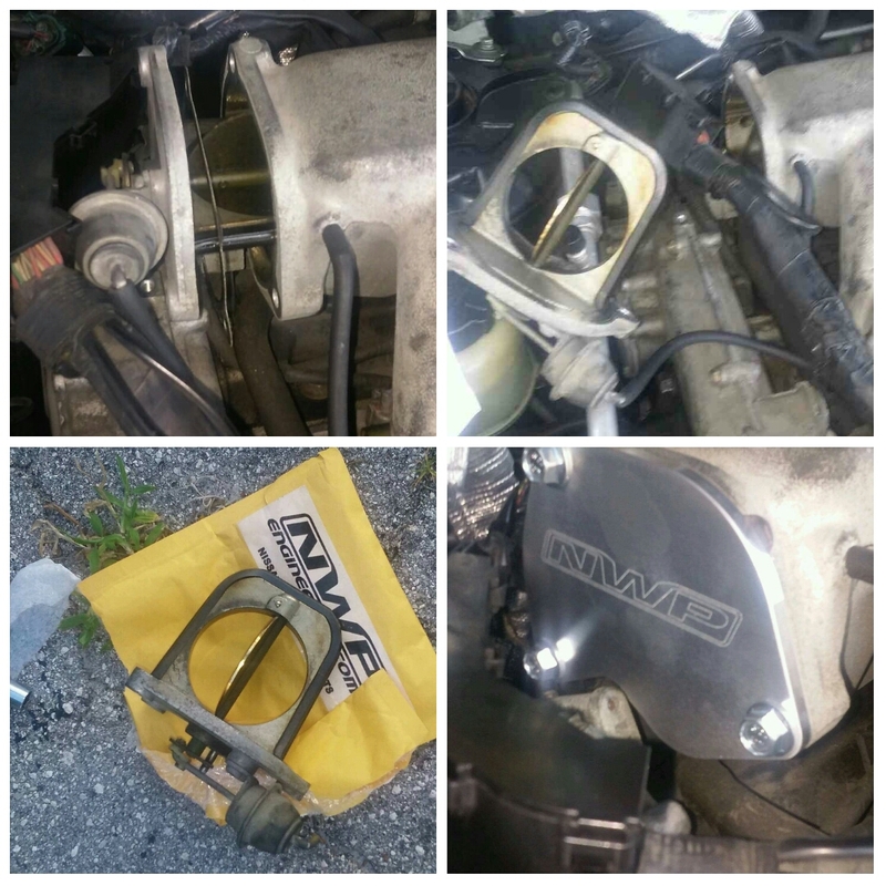

Finally

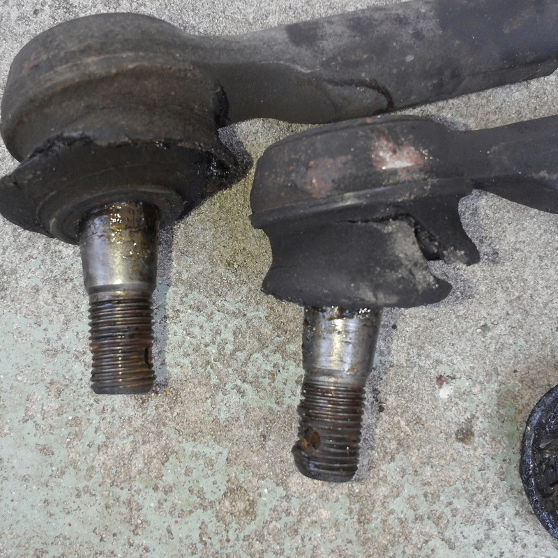

Mech changed outer tie rod end from research i know i need alignment but i'm noticing steering wheel seems to turn almost 360 on turns.

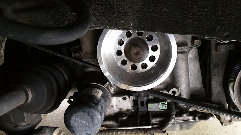

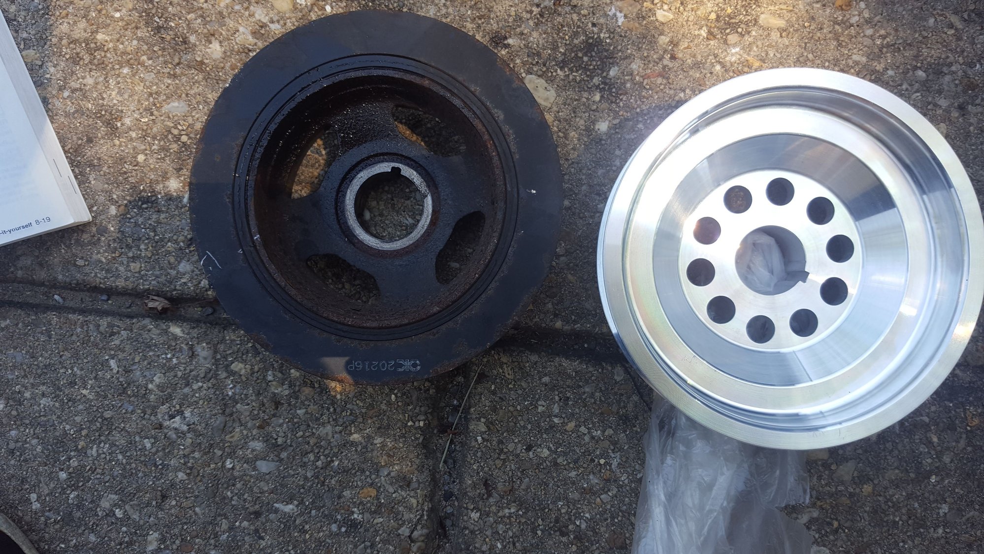

Shed a few lbs from the vq with this thing!
Royal pain finding the correct belt since the one suggested on the site was too short!!!
Right belt pn k060410

Nice is that the same ralco rz? I did mines last month, definitely worth it. It's atleast two times lighter than oem

This is a knock off of the unorthodox
Do you remember the pn of the belt you used?

From: Prince Georges, MD
Lol, 5060431 for a/c and idler belt. 5040305 for the power steering belt

Oh OK that's probably cause you have a 3.5

No I chickend out in the last minute! Still 3.0 strong
Got the pulley from ebay for da fitty! Just put some thread lock on the timing ring as suggested by a fellow member!
Put on a 1/2 extention on the crank bolt I used the floor for leverage some use the oil filter than just bump the starter, my pulley was stuck pretty good but just sprayed it and tapped it with a sledge hammer and was able to wiggle it out!

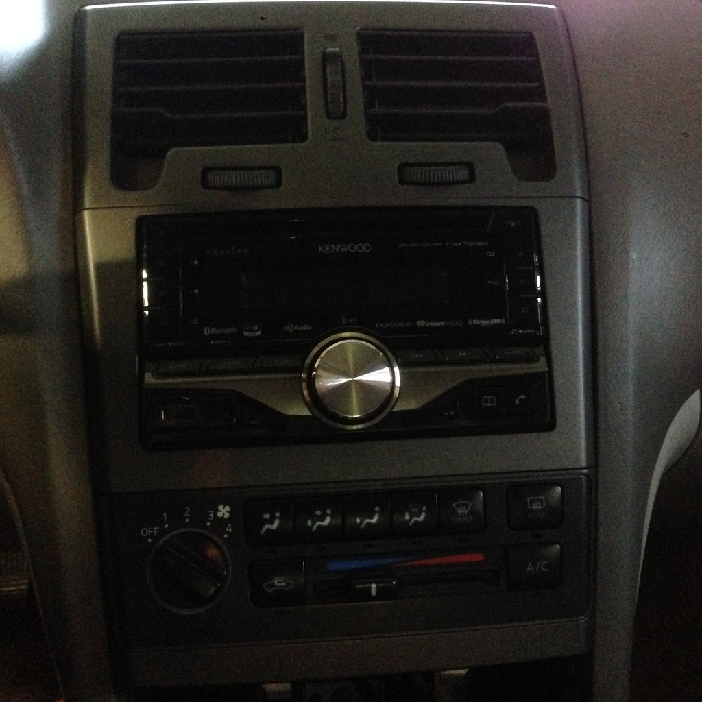

Finally got the wheel bearings pressed in and all the front end parts reinstalled. Also installed Knight's right and left engine/trans mounts.
Installed a Kenwood Exelon DPX791BH headunit but I am waiting for stuff to complete the wiring with the Bose system.

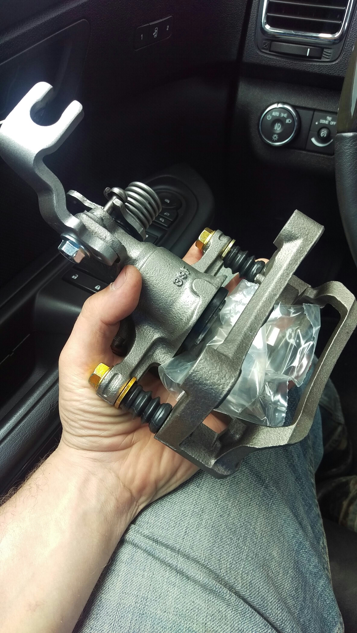

Replaced back brakes, one bad caliper, after fighting with left rear caliper piston for an hour...love it

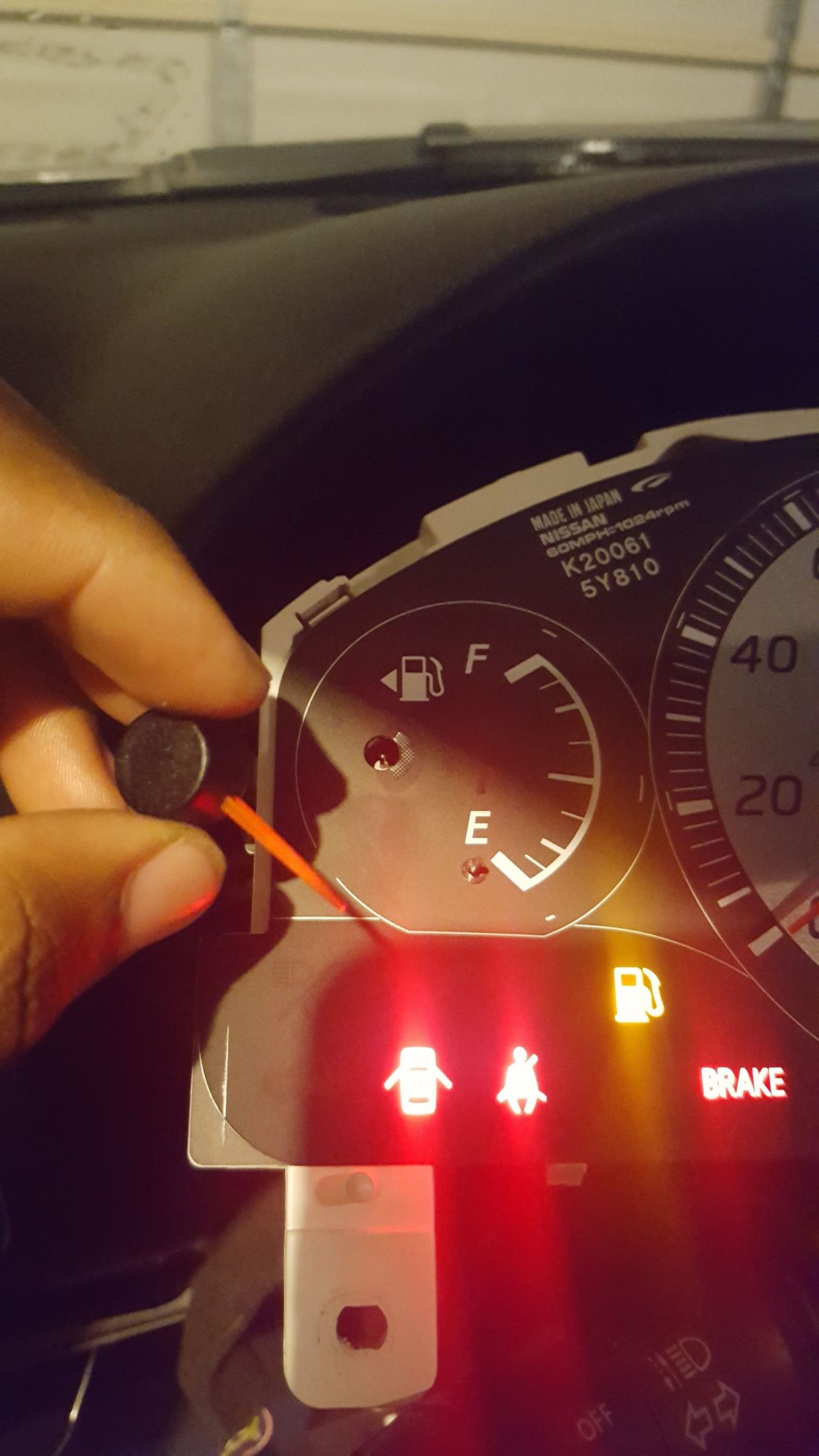

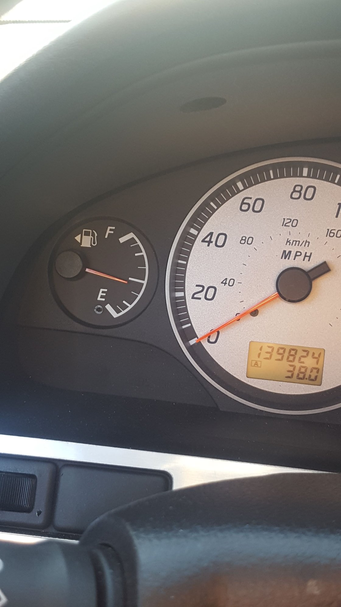

So my car ran out of gas today @ half tank, so I had to use that old faithful gas can in the trunk.
I have the p0455/p1448 code but I was told that these wouldn't cause our gas needles to read wrong. (Which makes sense)
Could it be the Fuel pump or sending unit? I saw in a thread that our cars fuel pumps and sending units don't usually go bad. When it did run out of gas, I heard a popping sound from under the hood. Almost like a leak.
Any help is appreciated, as I'm Kinda stumped..

I'm leaning towards the sending unit

I replaced my pump and sending unit and my needle still reads wrong. Did the gauge cluster test and yup the gas needle was off a bit.

Feel a big difference is revving?

[QUOTE=Itz Shak;9118024]So my car ran out of gas today @ half tank, so I had to use that old faithful gas can in the trunk.
http://boredmder.com/FSMs/Nissan/Maxima/2002/EL.pdf
See page 122. Good place to start.

Indeed it was. I just adjusted my gas needle as 2kmaxim suggested. In this thread https://maxima.org/forums/5th-genera...l-problem.html (post #33) I got it to read just like the FSM. So we'll see if that fixes the problem, otherwise fuel sender unit it is.

Tbh, I think is all in my head but feels like it can pick up faster at higher speeds when before throttle response was a bit lagging before the car actually went

Seems like everyone's cluster is off by a bit though..

I'd love to hear your input on this gas dilemma korn

Does the needle move when the a/c is turned on?
If so that could be a poor ground. My bmw did that that's why i'm saying it could be it.
Just add more ground straps if it does.

So I went to a junkyard today to swap out clusters.. I plug in the one from the junkyard and it was worse than my original.
It's stuck @ Full tank and has 228k miles on it.
They don't do refunds on electrical parts, so they're going to find me another one by Monday.
