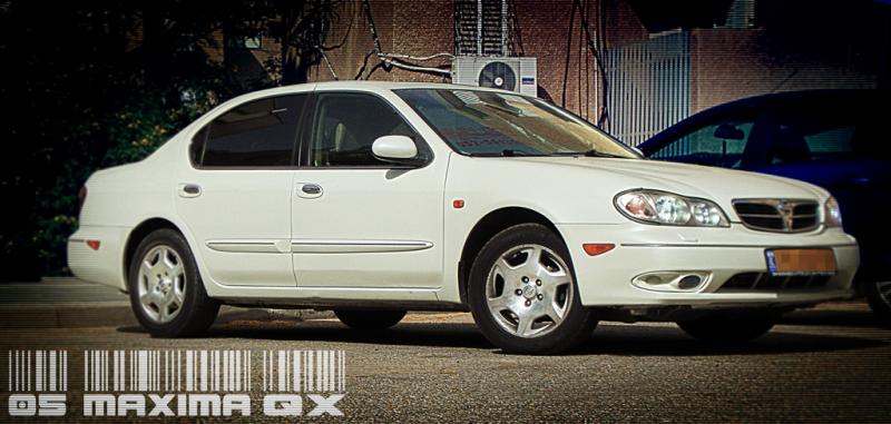

Hi all. This is my first post here after a long period of just following this great forum.
I own a 2005 Nissan Maxima QX, which is a european version of the 5th gen and also known as Nissan Cefiro.
My model does not have a cruise control system. I would like to try and add this feature. I've seen a lot of CC units and wheel switches running around ebay and I was wondering if I can retrofit an entire CC system.
My Max has a mechanical throttle so I guess it has to have some control module/motor to actuate it.
Has anyone tried this before?
Thanks,
Zohar de-Valenca
Israel
