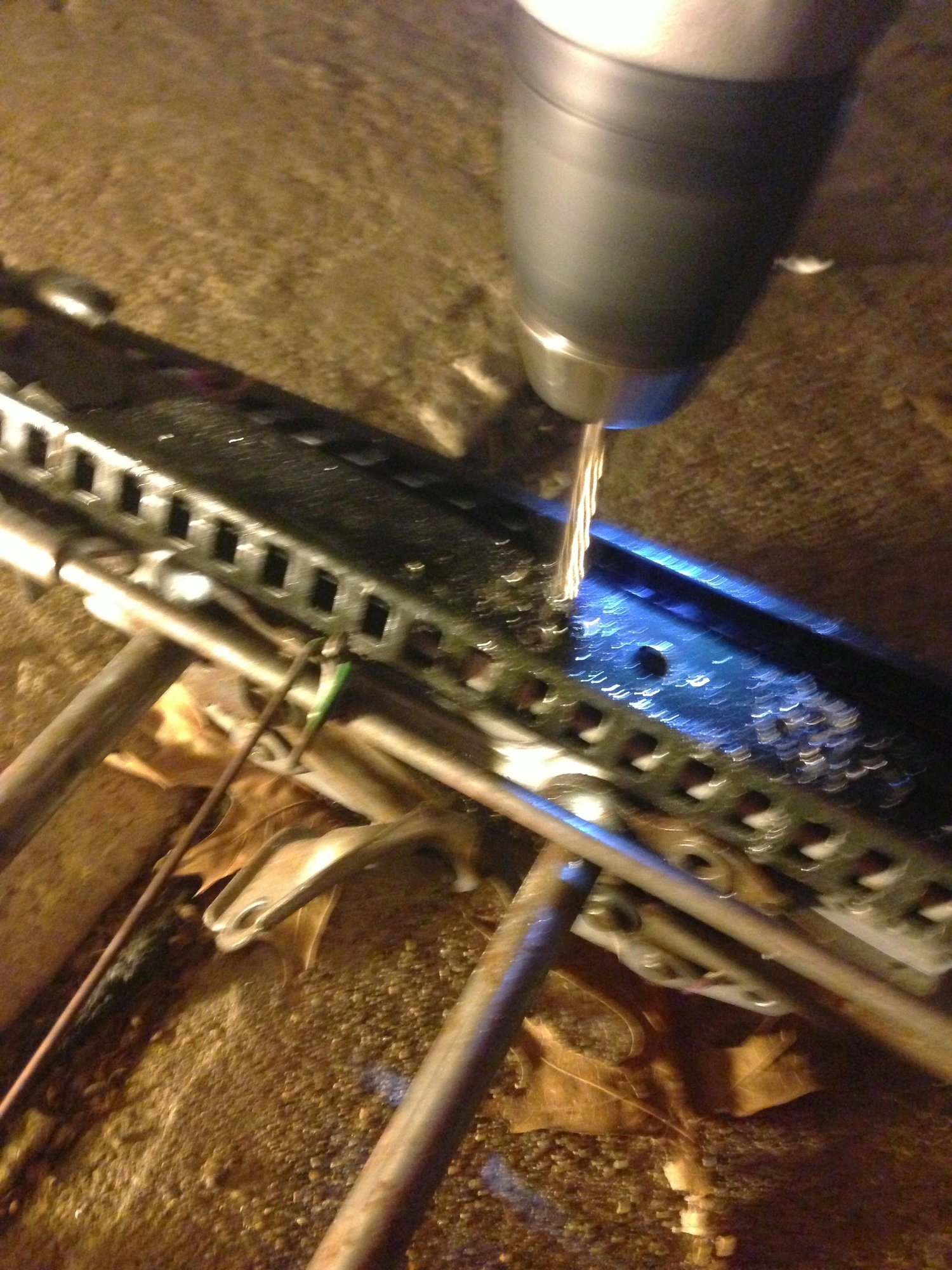

Start with the Z seats since they're most likely not in the car when you're starting. The process below is the same with the Z and Maxima seats EXCEPT the Z seats have a bracket alongside the inner edge that needs to be cut off. As seen here:
You'll want to remove the seat cushions and back to make it easier...and to keep the fabric from getting possibly messed up. There are 4 bolts on the seat bottoms near the corners that need to be removed. The seat back has 2 bolts on either side that need to be removed. Once those are out the back comes off easily.
Now, the seats roll on a couple of rolling brackets, one in the front and one halfway down. The object of the drilling is to remove any kind of resistance the factory created in the rails to prevent the seats from rolling too far forward/backward.
There is a single aluminum welded bolt(?) that can be drilled through on both rails in the front. These are present on the Maxima and the Z seats.

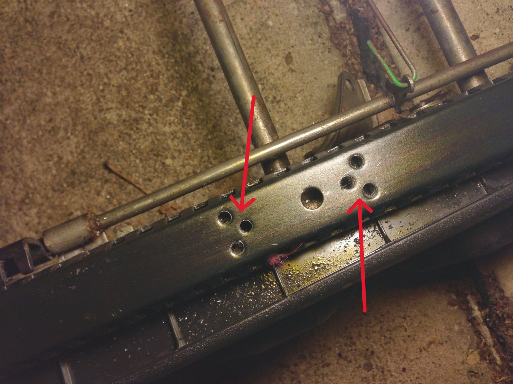

Once that is out of the way, you'll see some 'dimples' in the rails. I believe my other set of rails had 6 total but these Maxima rails show 4 total. Drill those out.
Again, the main object is to remove anything that will keep the rolling brackets from rolling too far forward. Once you have the front welded bolt and dimples out, you may notice it takes a little bit of force to get the rails to slide the rest of the way off. I found that the dimples actually still had a little bit of a 'bump' that needed to be removed.
The Z bracket on the side will still need to be removed before you can get to the dimples that it covers. If you don't have a grinder I guess a Dremel would work, just very time consuming. You could also take it to a muffler shop and ask to have someone safely cut the bracket off. Remember you still need the rails.
Once you've drilled all that out, the rails should slide off. Keep in mind the rolling brackets will come off. They aren't hard at all to slide back on, you'll see what I'm talking about when you're there. To finish things off, you'll need to transfer the seat belt lock from the Maxima seat to the Z seat. Just a simple bolt holds it on. (The Z seat belt lock doesn't fit the Maxima seat belt)
Anyway that's pretty much it. When you have the Maxima rails onto the 350z tracks then it's the 4 bolts to put the cushion back on and 4 bolts for the seat back. One last couple of notes, I lost the ability to raise/lower the driver seat...I don't really care but some people might. Also, you CANNOT use the Z seat trim on the bottom NOR the Maxima seat trim. I'm not aesthetic so IDGAF what it looked like, the seats are comfortable as he11 to me.

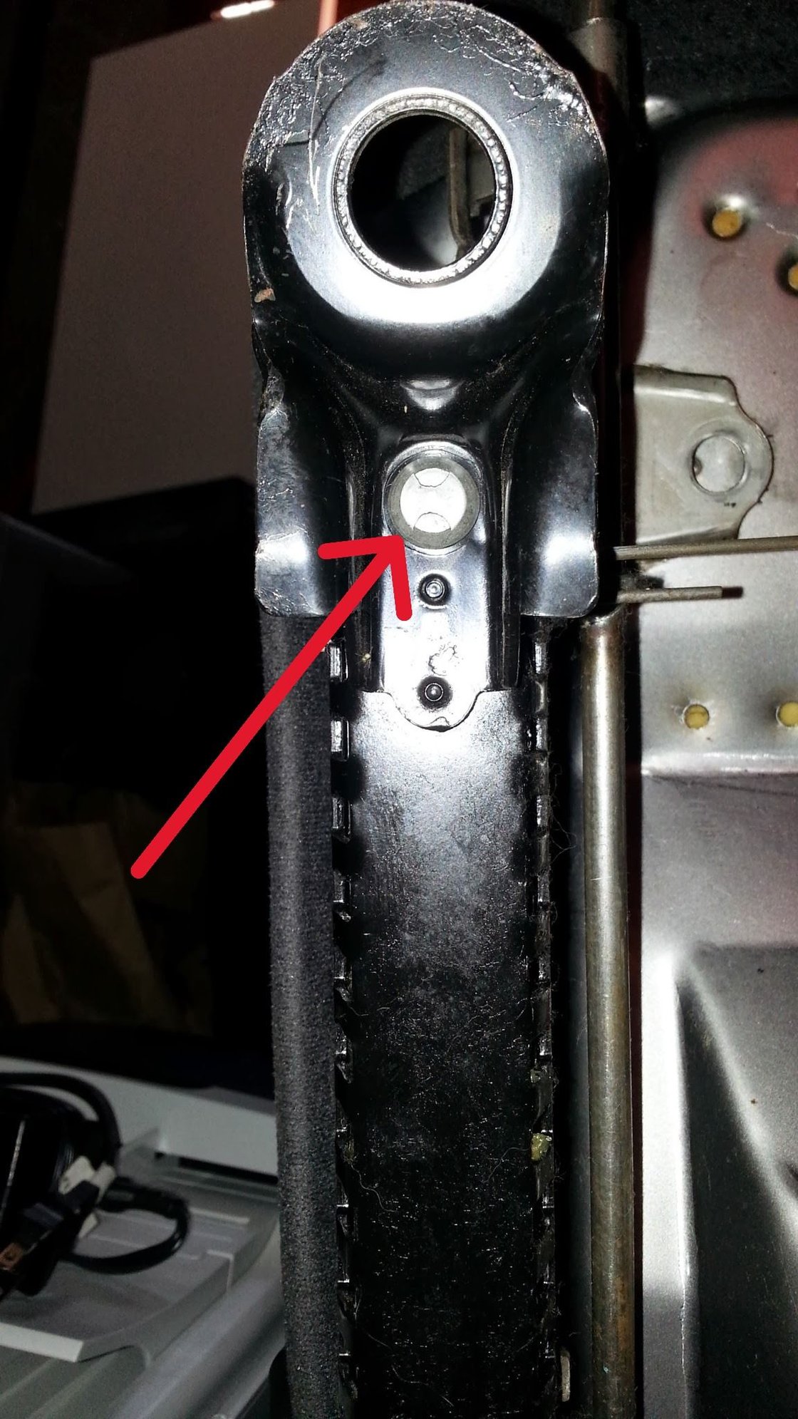

I have the originals that were in this thread, attaching here. Added some arrows of what needs to be removed/drilled out, but it's pretty simple. The seats slide in the rail via sliding bushings, so you're essentially removing the metal pieces that block them from going too far forward/backwards and keeps them in the actual track.
Have fun!
Front of the rail, aluminum piece keeps from sliding out.
You can see the piece that blocks and will need to be removed.
These are little divots in the railing that also help keep the seats from sliding too far forward/backward.
I drilled through them from the outside
