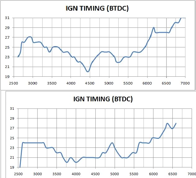

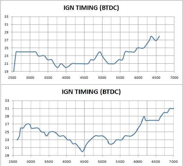

If you're familiar with a dynamic, not static timing curve, then yes, it's dependent on RPM, throttle postion and load (load = MAF usage + throttle position, or at least that's what Nissan interprets it as) and typically is it's lowest at peak torque.
Here are my timing curves:
With that said, very low load times, timing is in the 40's.

So really if I'm spraying at 3200rpm n out at 6krpm I'm right at 26btdc with spray....wow that is scary hmmm never knew this Thanks.

That's my timing curve, yours will be different.

Originally Posted by TravisCadello
What are you at? jus curious if my timing curve is goin as high as yours.
Just because our base timing is the same, doesn't mean the curve is too. I'm t 17, but I also have a TS ECU.
