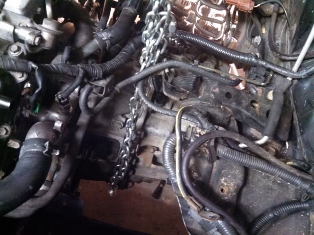

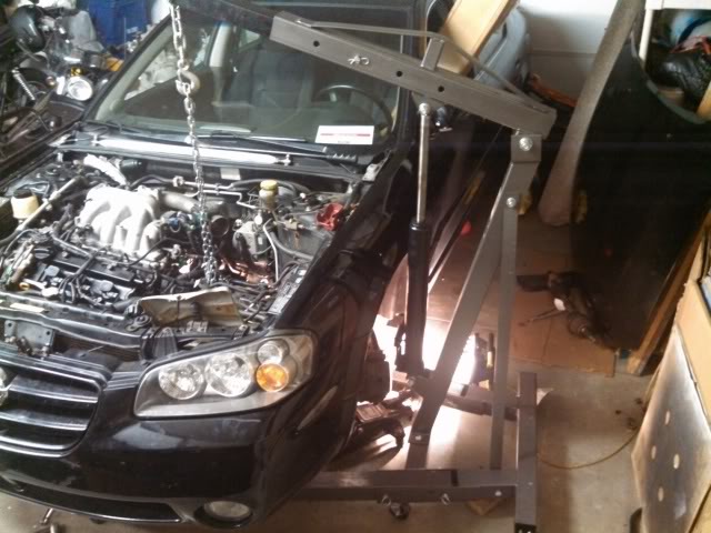

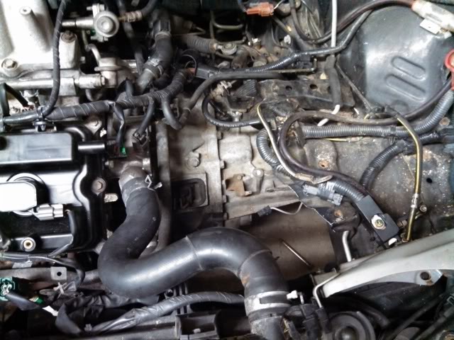

Not much to report. Been busy with other things. Got the transmission in today as well as a few other small things...
The engine hoist has come in real handy:
Close up:
Installed:
