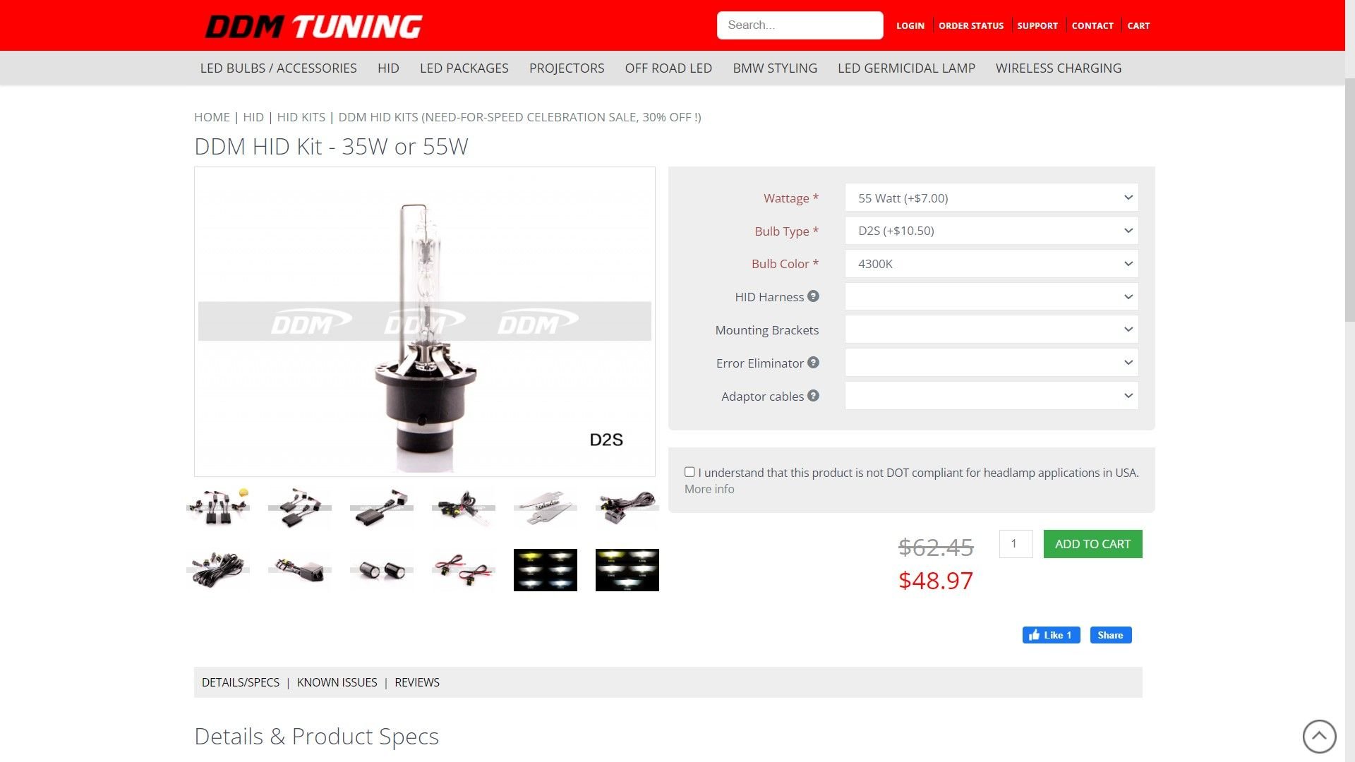

should have just got a complete 4300K 55 watt D2S kit from DDM tuning, it's like $50 and they have a great lifetime warranty. I have their kits on my car and my bike.
https://ddmtuning.com/DDM-HID-Kit-Sl...ast-35W-or-55W
