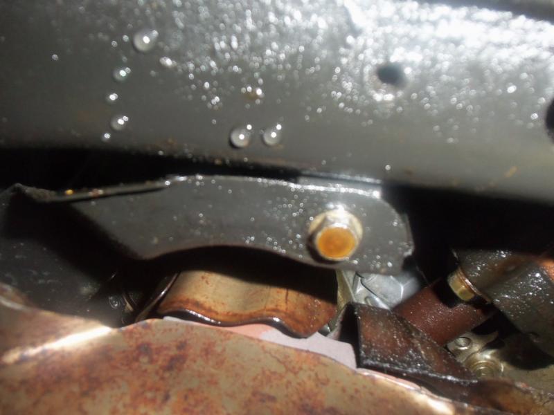

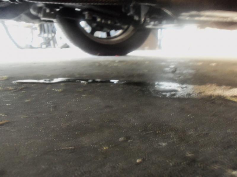

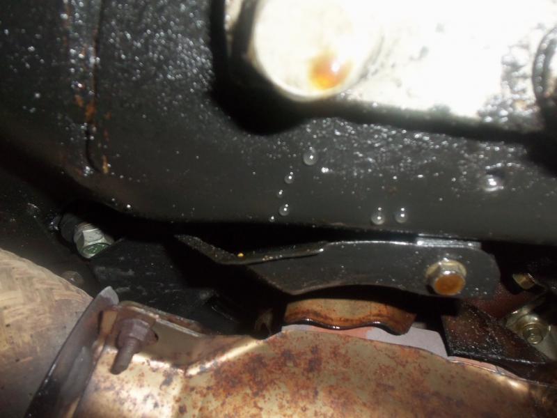

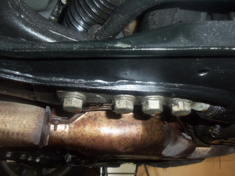

Is there any coolant hoses or something behind the engine. I filled up my coolant to the max line yesterday and this morning it was a below that. Also when I turned it off yesterday, I looked under the car and a whole bunch of liquid poured out from around the middle of the back of the engine.
Attached Thumbnails Engine Smoking (Need Help)-100_1652.jpg   Engine Smoking (Need Help)-100_1656.jpg   Engine Smoking (Need Help)-100_1657.jpg   Engine Smoking (Need Help)-100_1655.jpg
Old Sep 15, 2013 | 02:03 PM
DennisMik's Avatar
Posts: 10,644
From: Plano, TX
The middle 2 pics look like water, the other 2 pics are useless. There are the heater core hoses going through the firewall and there are water hoses on the EGR valve and the IACV. While IACV is on the driver's side, the end where the hose begins could be leaking.
