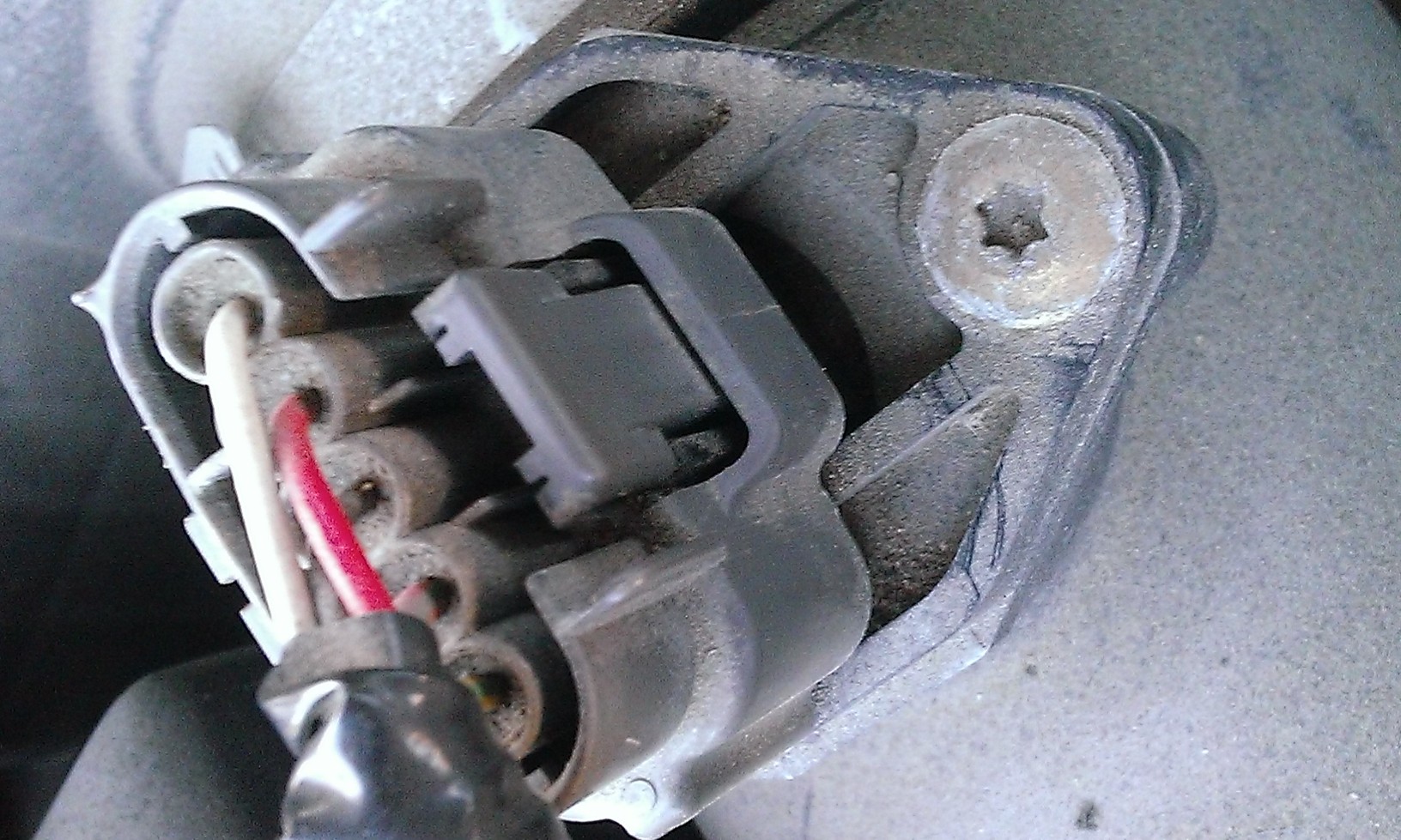

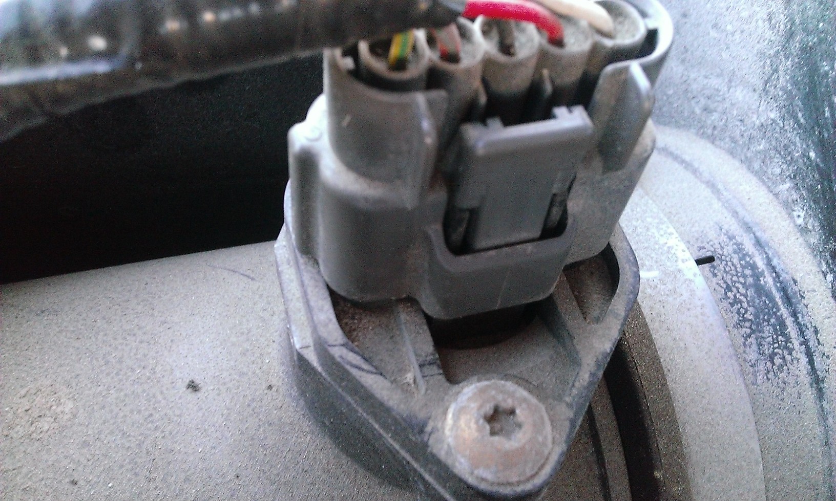

I'm not sure what i am supposed to do here with this MAF connector. I've pushed down and tried to pull it out, i've even tried pinching it and pulling it out. Doesn't seem to work, so I was wondering if it is actually not the factory installed connector. Anyone have some tips?

Flathead screwdriver and elbow grease.
Connector tabs are fun.

So What exactly am i supposed to do with the flathead? push the tab down?

No the connector has a pinch tab, so push the tab inward while pulling up on the connector ... as stated above connector can be such fun, keep at it you will get it to pull up and off (I trust you have disconnected the battery?) always a wise thing to do when working on any electrical componet.

flat head screw driver and use that as leverage for the clip
Use the flat head and push down on the plastic clip, then hold the connector (plastic part not cable) and pull back
